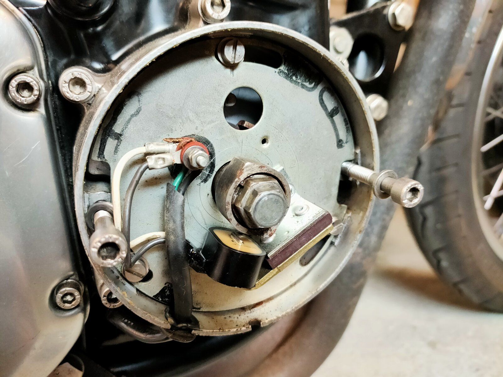

I'm having some difficulties wit my '79 z1000. I had the engine cleaned and resealed. Ultrasonicly cleaned the carbs and put in new spark plugs, and fuel lines etc.
After I put it all back together the bike ran perfectly (except for some details) for a good 50km. Next time I took the bike out, it had trouble above 5000rpm give or take, and on full throttle. It even blew of a air filter..
I also noticed that the bike will slipp on the clutch, but only when engine is cold (I think). With the second run the bike lost quite a bit of power so didn't slip anymore. I do notice the bike having a very sharp smell, like unburned gas or maybe burned oil. If I let the bike run for a few minutes in the workshop I get tears in my eyes, it burns:).
I was hoping you guys could give me some advice. I am really technical and know how to properly think, but don't have much experience with this. My next step would be to start changing ignition parts, (it now has a home made ignition with only one pick-up, and mechanical spark advance).
I'm looking forward for your advice!!
Robert

Ignition timing checked? Does your mechanical spark advancer moves free and is not stuck? Any pics of your home made ignition with only one pick-up would be interesting.

That has been just a few days. Before I took it apart, it had run on 3 and even once on 2 cilinders. Just a few minutes ago I started the bike to, and ran on 3 again...

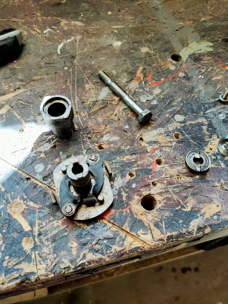

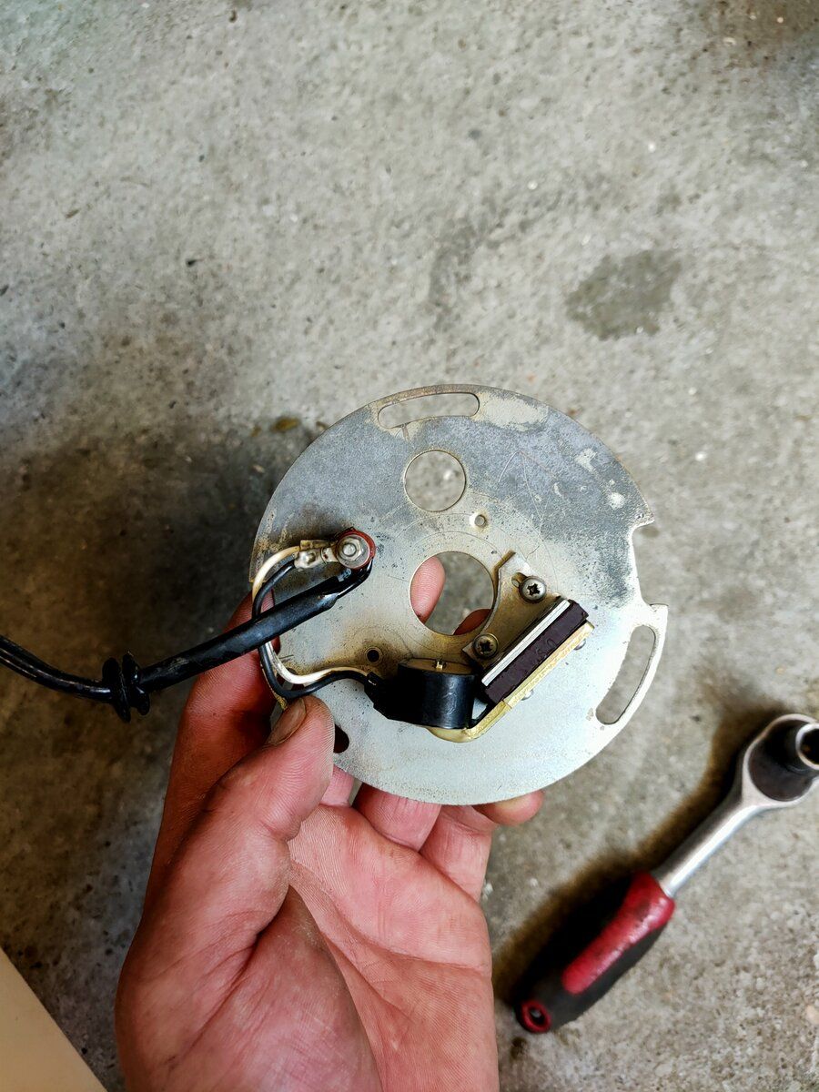

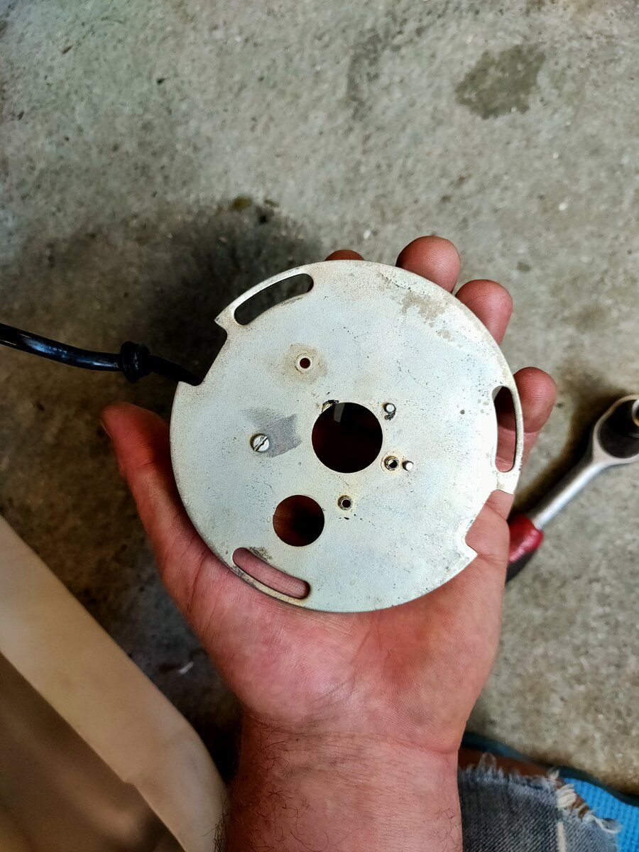

PIcs of the ignition are attached!

I don’t know much about electricity, and I am completely befuddled by that ignition system. Looks to me like it fires both coils every 180 crank degrees.

Same here, think it does. It's a weird set-up. That's why I would prefer swapping it for a good ignition like a dyna or MSD..

Lean? That is surprising to me. I do have open cones with a filter at the end. So first thing is probably to have the bike tuned up on a Dyno.
Thinking about that ignition as well, It would be a waste of time and money to have te bike tuned up with a possible faulty ignition.

Looks to me the bike would be firing on all cylinders fighting itself on all strokes. I don't see how it could run at all if it's hooked up to just the coils.

I expected it to fire every stroke, but hoe can it be fighting itself, when there is no gas in it the other stroke? Or are those remains? Maybe oil burning?
Just wondering, because I understand the way you think, but not how it's possible..
