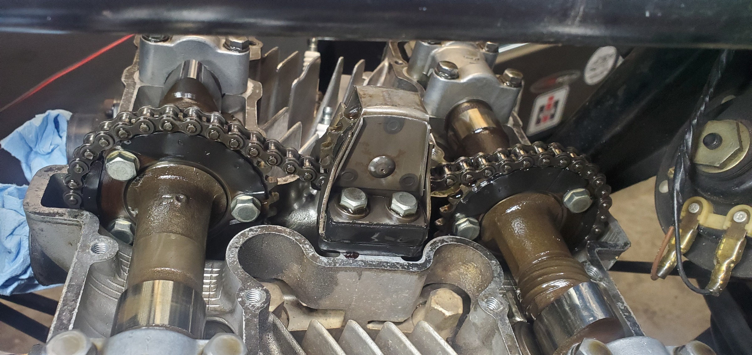

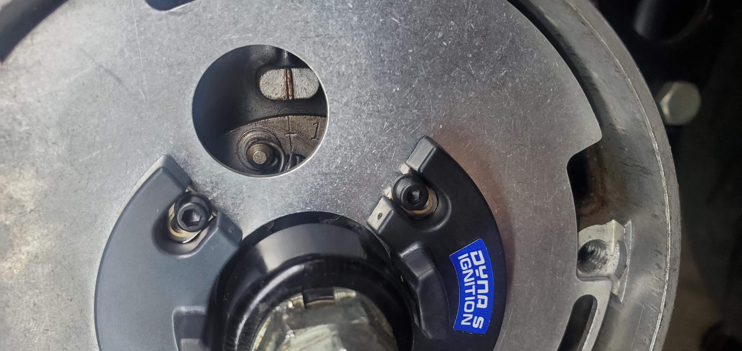

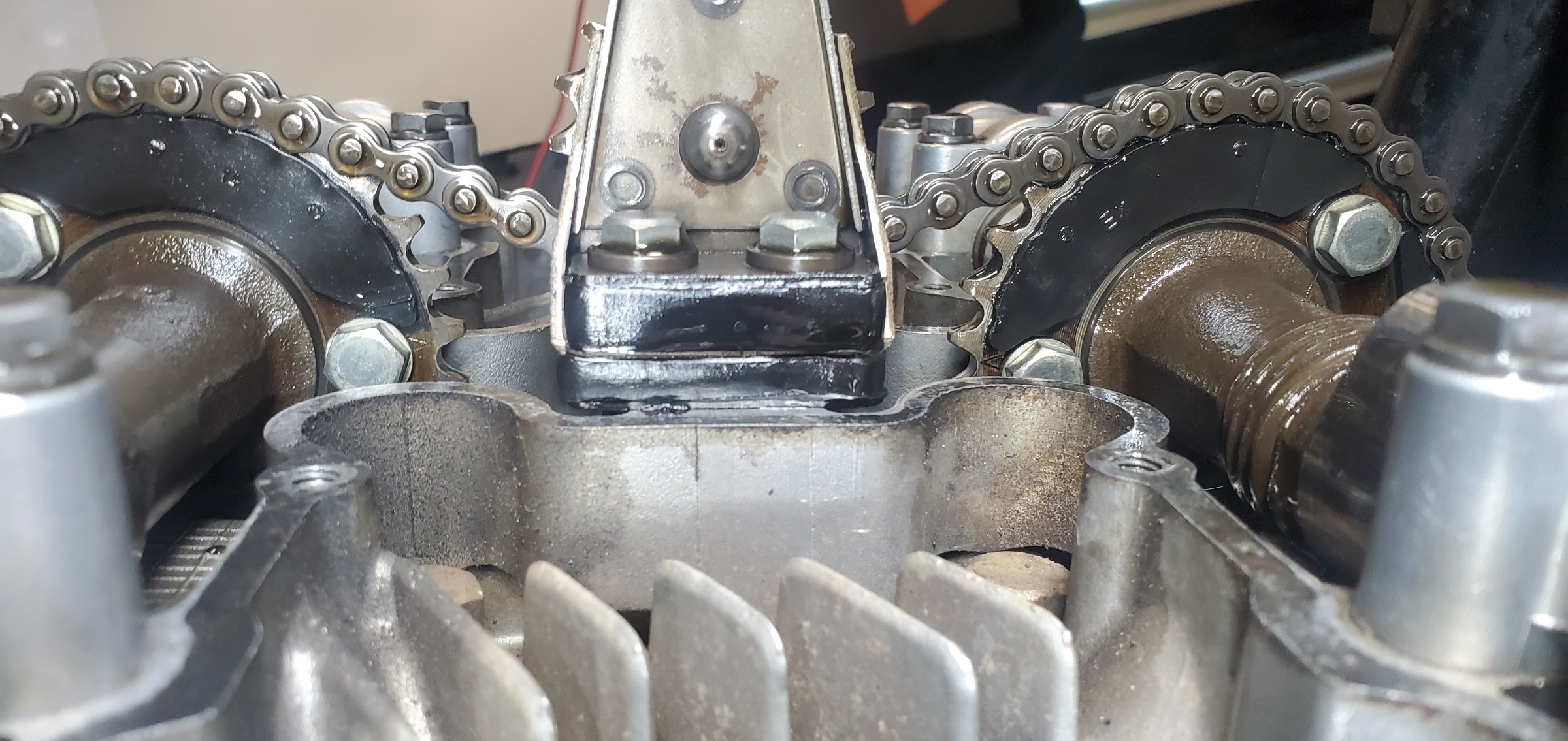

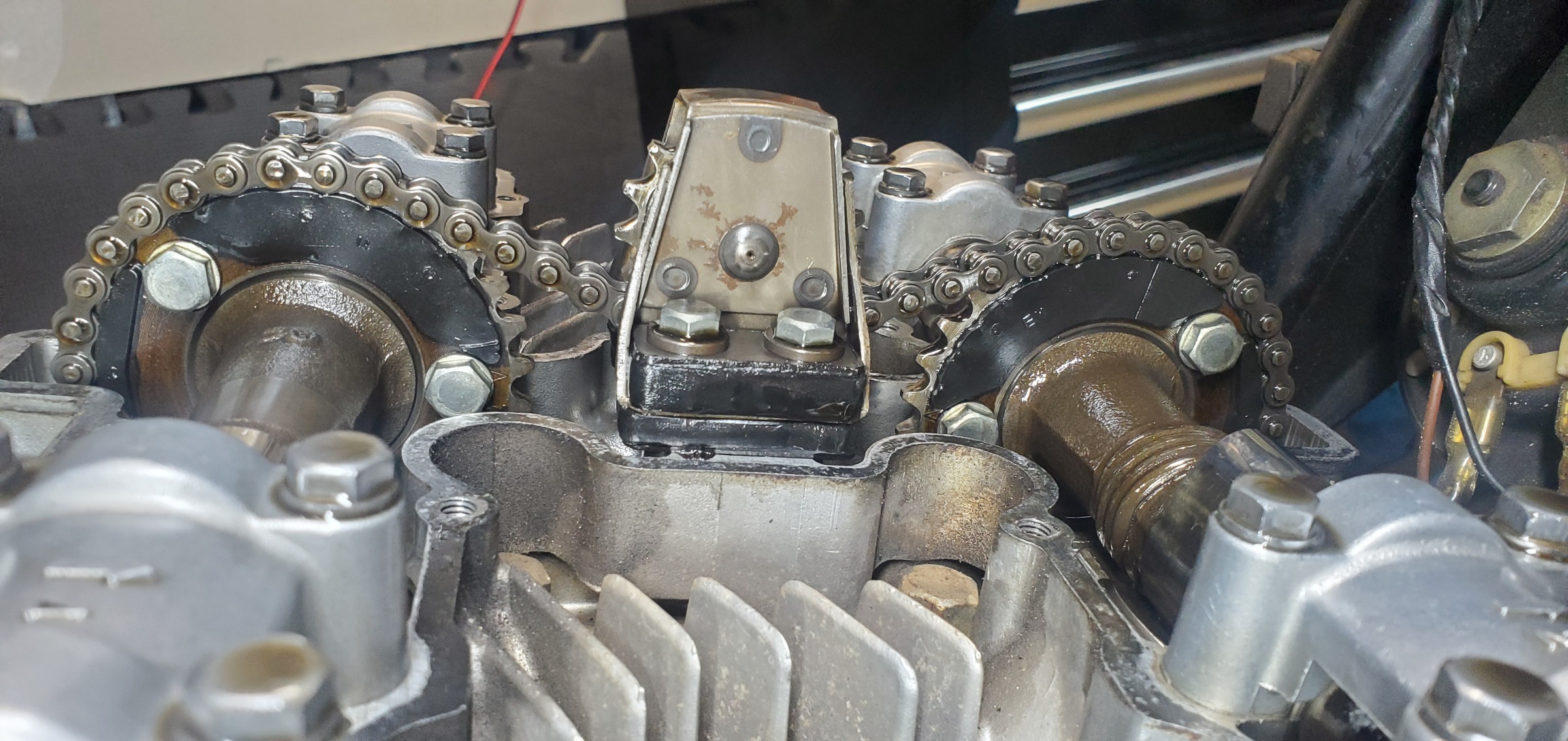

I placed the engine at Top dead center, took off the cylinder head cover and noticed that the cams looked like they are backwards.  Shouldn't the arrows be pointing towards the intake and the exhaust and not towards each other?
Give the crank another 360 turn and the cams will be pointing the correct way.

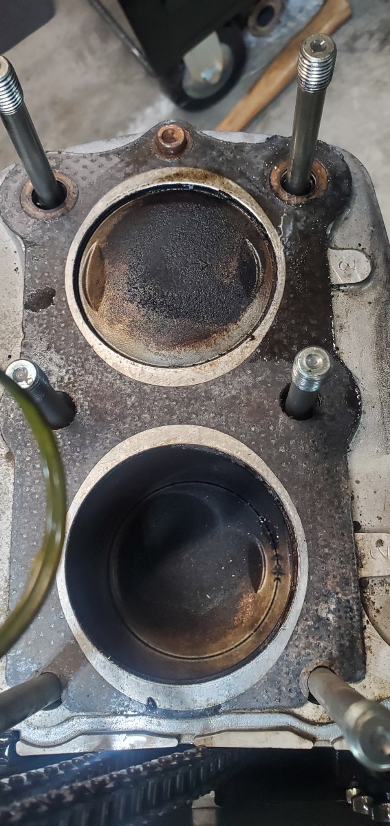

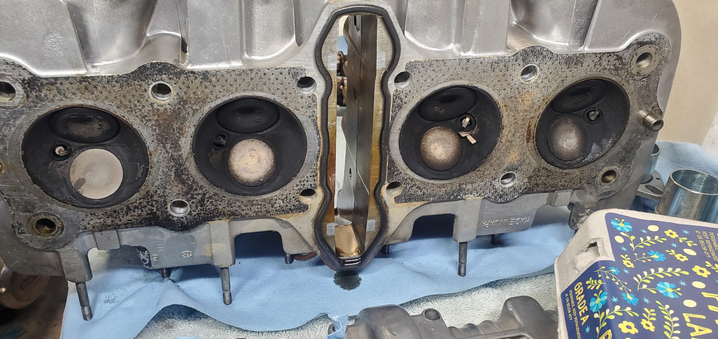

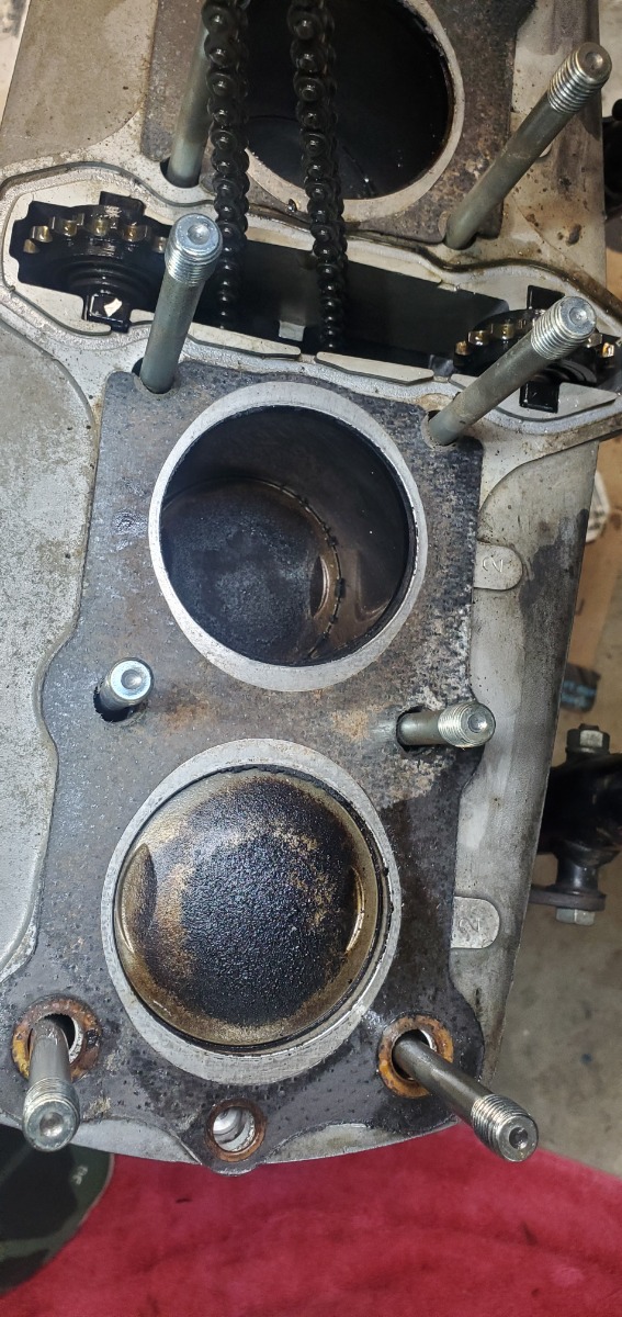

Got it.  Have everything torn down now, appreciate all the help.   Check out these pics!  Glad I'm having some work done.
