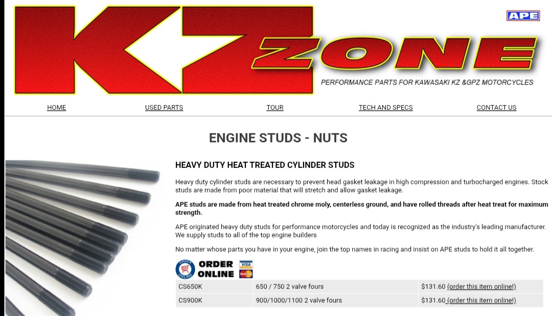

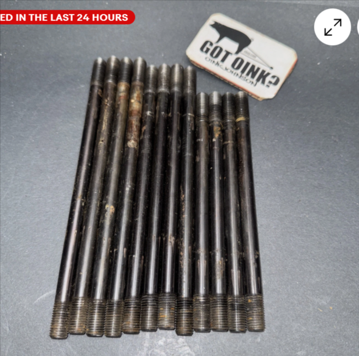

Re: How f***** am I?
02 Jan 2026 06:59
MBS1000K
Ebay # 3894319 44136
is currently available for a decent price if used is acceptable.
My .02 cent suggestion is replace the old studs, and find another head if it doesn't solve the problem.
02 Jan 2026 09:40
Just curious, but are the plain sections on the studs slightly narrower than the threads, on either the old or the new set?
