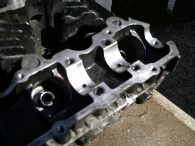

I recently had my head over to the shop for a very nice valve job, about $800 in p&l. During reassembly, I had a handful of cam cap bolts pop their threads. I went ahead and helicoiled them, and now a few of the helicoils are popping their threads as well, along with a keen-sert I had installed to repair an already busted helicoil.
I've got two stripped helicoils and one stripped keensert. I can install new keenserts for the helicoil, I'm just not sure what to do with the stripped keensert issue, short of filling the hole with weld and tapping new.
Any sage advice to save this head?

Now that I've got that figured out, what should I do about my stripped out keensert? Would it be a terrible idea to use a 10mmx1.25 helicoil and reinstall the keensert in that?

No eBay APP ID and/or Cert ID defined in Kunena configurationBefore you get into more trouble you need to post the diameter of the insert that failed. They are a special size and pitch so that could be where you went wrong. There's limited room so choosing the right insert is vital at this point. I had the same problem but with a bolt in the case. Went with a m8Xm6 insert as a m10 would have been the last resort and not much meat left in the case. Whatever you decide to use precision is required.

Got a M6 TimeSert Big-Sert kit for a couple cam-end plug bolt holes after Helicoils failed and pulled out. Haven't needed it since, but it was the only logical repair system I could think of.
I always use clamps to pull the cam caps tight to the head, and then thread each bolt in by hand. With each cap still clamped, I torque each bolt to spec. Only then do the clamps come off.

No eBay APP ID and/or Cert ID defined in Kunena configurationAlways appreciate your advice Steve. It is a keensert that requires an M10 x 1.25 standard thread

IS THERE ENOUGH MATERIAL?
- zed1015
- Posts: 3362
- Thanks: 2072
Re: Repairing cam cap bolt holes
20 Jul 2021 00:34 - 20 Jul 2021 00:36There's just enough room to drill and tap M10.IS THERE ENOUGH MATERIAL?
It comes very close to the cam shells though so has to be accurate.
I've repaired many by fitting home made M10 steel inserts that i tap back to M6.
