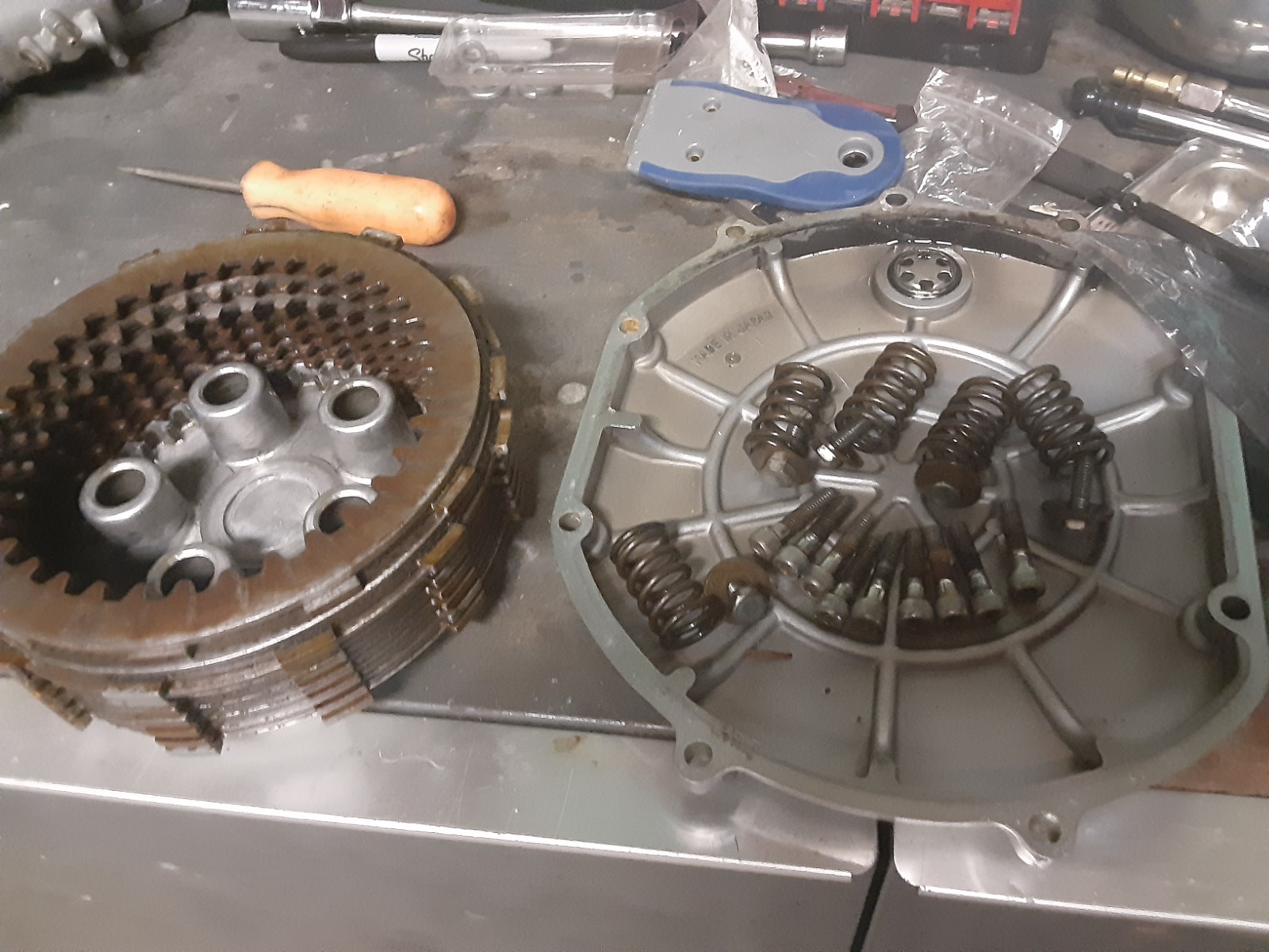

I measures the springs. They are right at their service limit with a measurement of 32.2 to 32.3 mm

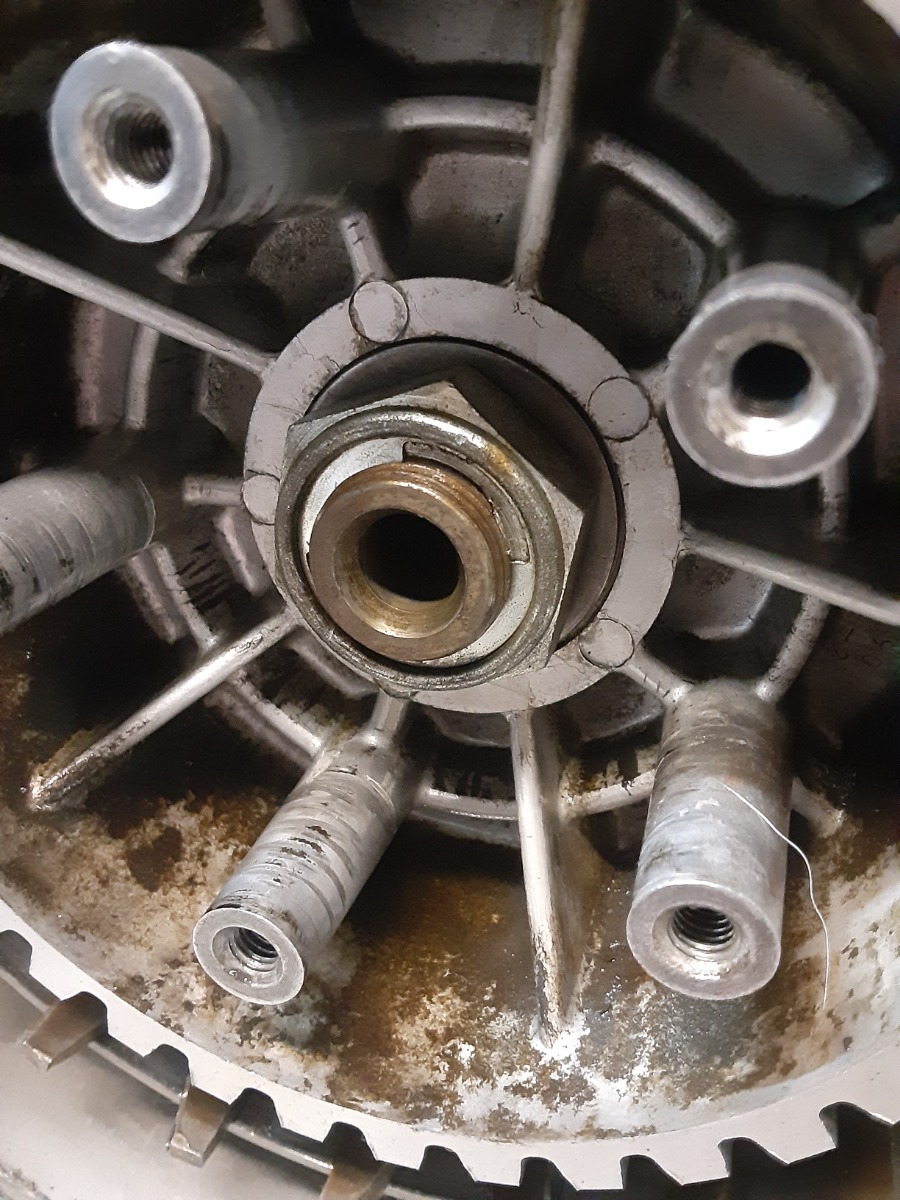

No marks on the clutch engine cover. Looks nearly brand new. Does this little ring on the clutch hub nut look normal?

YES. SELF LOCKING NUT

Update: I replaced all the friction plates, lubed the clutch cable, lubed the push rod and ball bearing, greased the worm gear, and installed new clutch springs. When I pull the clutch lever it pushes the spring plate/compression plate out maybe 1/8th of an inch. I can rotate the clutch from this point with some resistance.When I release the clutch lever I can no longer rotate the clutch. This seems like normal operation at this point.
Questions:
1. This seems to be a big improvement from where I was. Is this a sufficient amount of movement (1/
on the spring plate?
2. I put a lot of engine oil on the friction plates, but I did not soak them in oil. Is this okay?
Thanks!
Questions:
Thanks!
