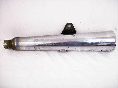

Found a really nice exhaust, but only one side. Hoping really badly that the dude has the opposite side. **fingers crossed**
