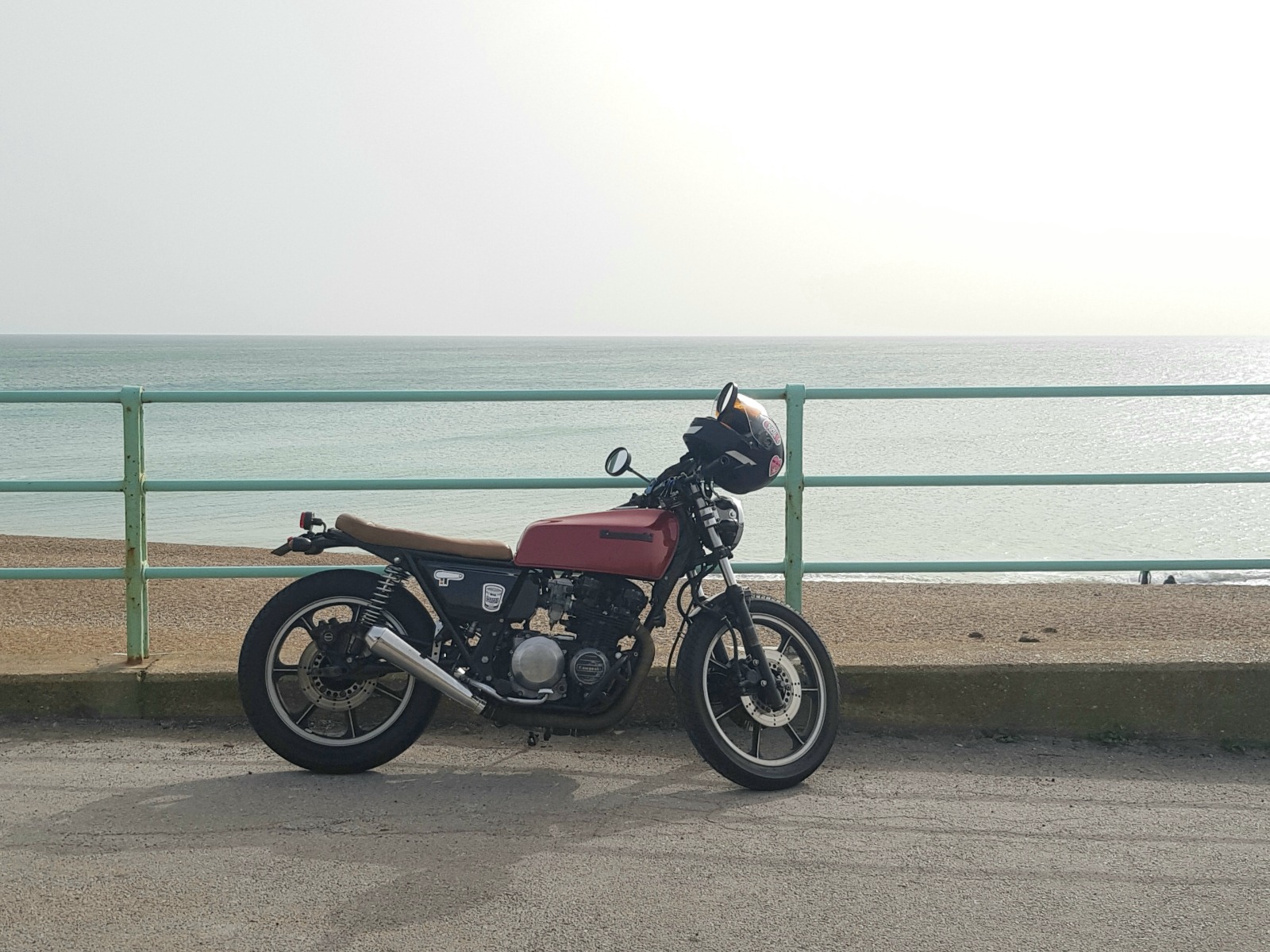

20 Jun 2021 06:19 - 23 Jun 2021 11:29Hi team,
New around here and as new when it comes to motorcycle mechanics. Was hoping to get some help on my 40 yo bike.
I've recently did a trip from London to Ely (80 miles) with some friends and have been notified that there was white-blueish smoke coming out of my pipes at high revs. When we stopped to check my oil level it was almost empty (you could only see oil through the glass if the bike was leaned to the right quite a lot). I had to top it up with 2 L.
Me being stupid, I didn't check the oil level before the trip, but it has been topped up on the 25th of May (the trip was on the 5th of June) when I got my regulator-rectifier replaced. This means that it went through 2L of oil in 2 weeks (only drove it in London prior to the trip).
After I topped it up, I have been monitoring the level, driving it only in London and it's pretty much the same. Is there any particular reason for it only consuming a high amount of oil at constant high revs (80mph, 7-8k rpm)?
To give you a bit more context, the top engine has been completely rebuilt at the end of March, with the following things being done to it:
- new cam chain
- new spark plugs
- new gasket set
- new o rings
- new valve seals
Here's a photo of the bike
Z500 - B3/6 speed - 1981
Last edit: 23 Jun 2021 11:29 by Street Fighter LTD.
