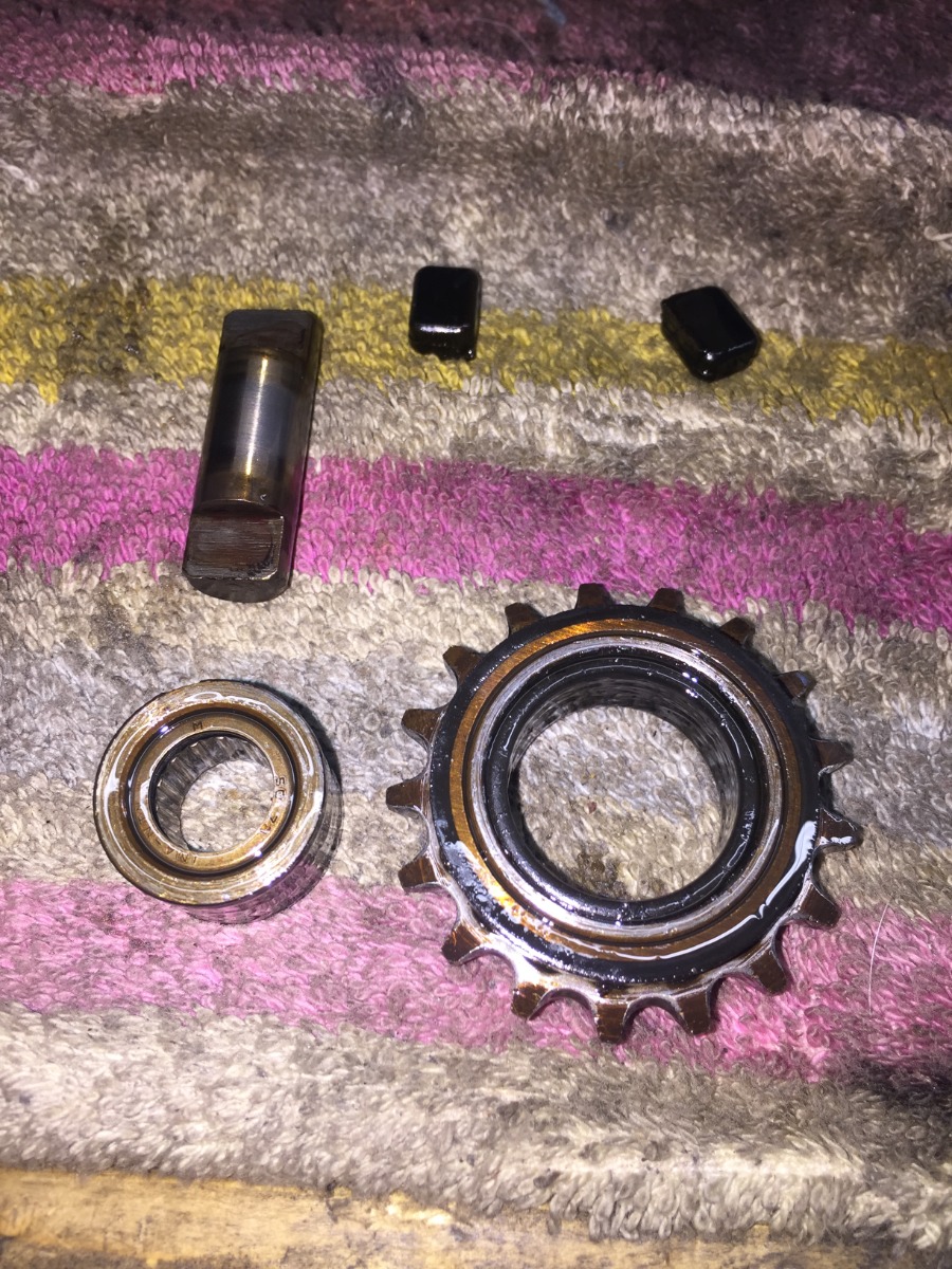

Had an intermittent noise from the centre of the motor for a while, all valve lash correct and cams fine, so i investigated today and found the top idler wheel not behaving right, so i took the rivet off removed the wheel and it come out in two parts, lucky i had a wheel holder with the bolt through it, i put a wheel on i re-worked a while ago, hopefully this will be the the cure to the noise, if not the top end will be coming off this winter.

I had a similar problem with one of the idlers under the head. I changed it out but the noise is still there. I'm suspecting a crank bearing but not sure. They all looked good when I had the engine apart a year or so ago.

24 Jun 2021 21:58Excuse me if I'm supposed to know this because I don't spend much time in here or with my KZs like I should, what exactly did you do that the idler sprocket that you say you reworked? And what kind of noise were you getting from the center of your engine, was it a sharp ticking sound??? What? I'm in the process of gathering parts to replace a timing chain, idlers and such. What's up?Had an intermittent noise from the centre of the motor for a while, all valve lash correct and cams fine, so i investigated today and found the top idler wheel not behaving right, so i took the rivet off removed the wheel and it come out in two parts, lucky i had a wheel holder with the bolt through it, i put a wheel on i re-worked a while ago, hopefully this will be the the cure to the noise, if not the top end will be coming off this winter.

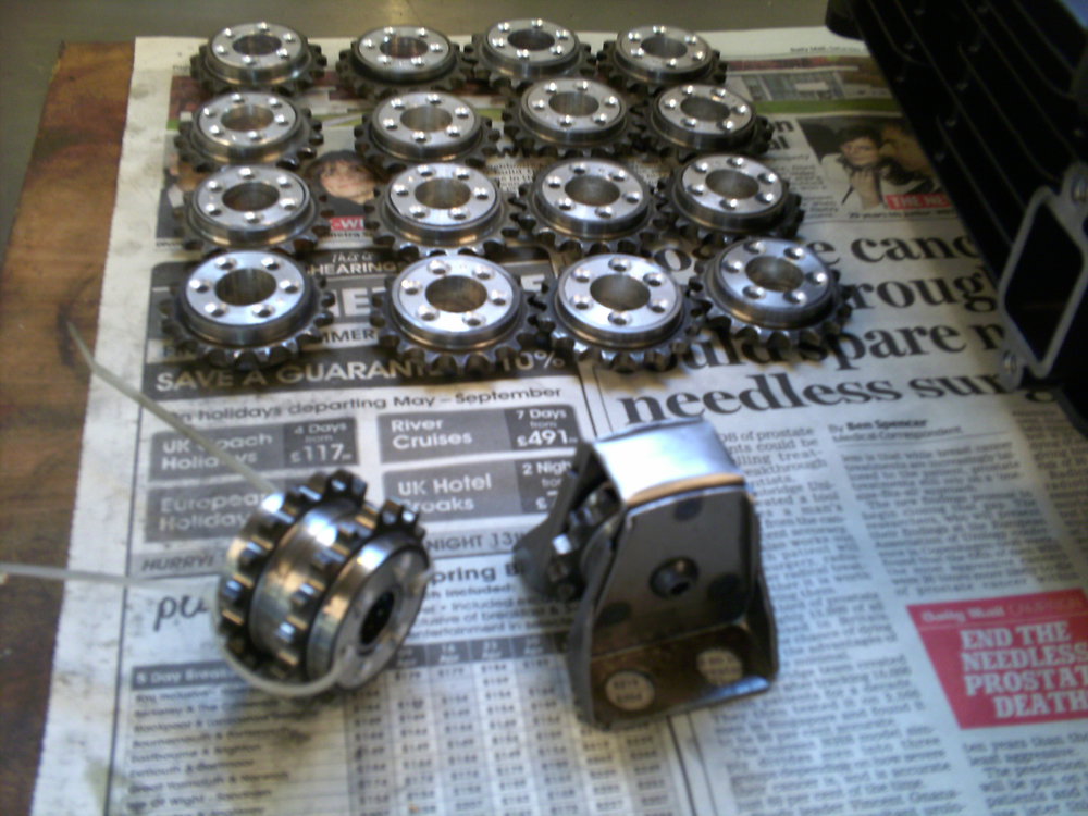

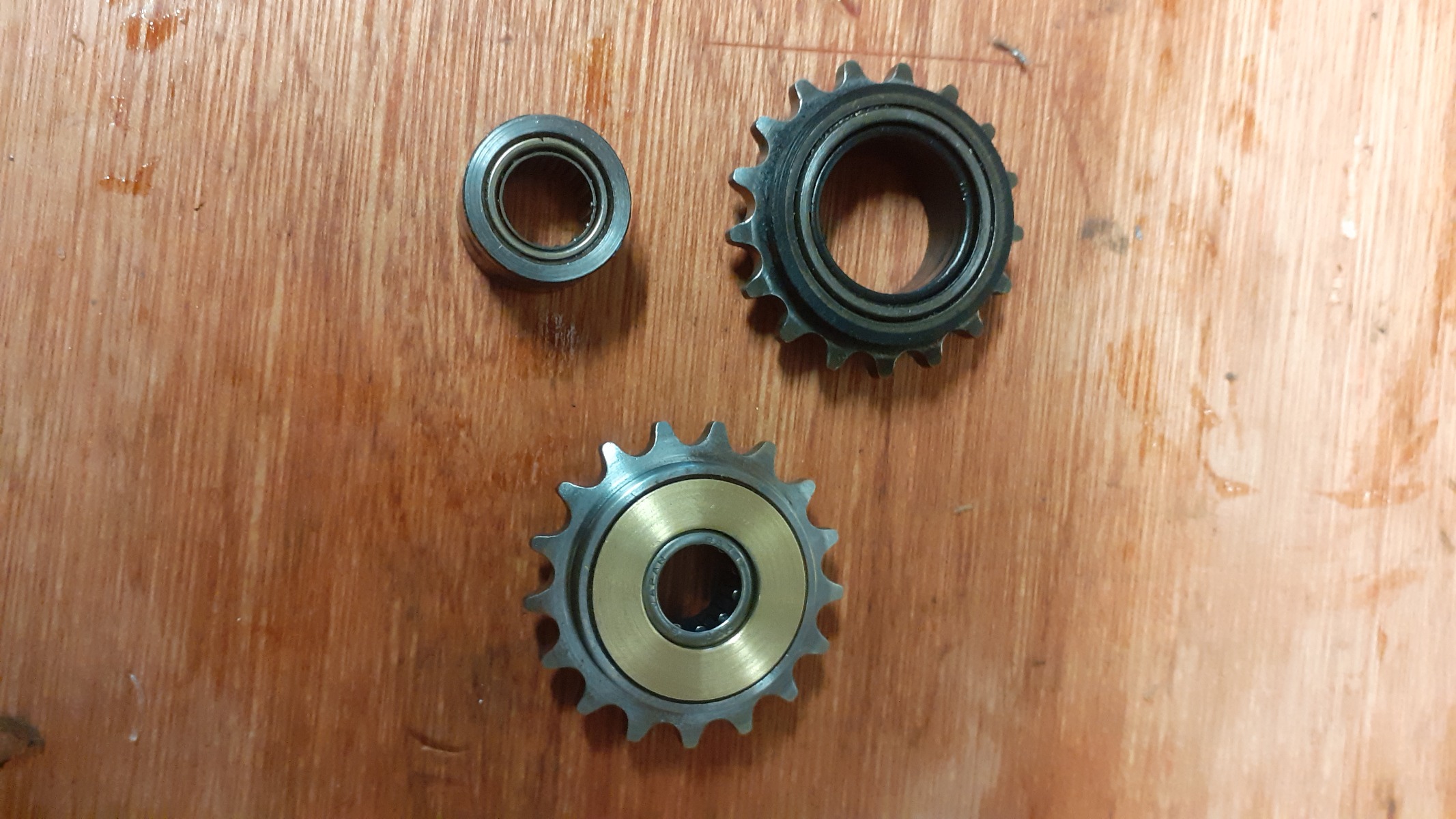

Re: Top idler
25 Jun 2021 01:18The bonded rubber centre degrades and becomes detached.Excuse me if I'm supposed to know this because I don't spend much time in here or with my KZs like I should, what exactly did you do that the idler sprocket that you say you reworked?
The sprocket ring can be salvaged by replacing the center with a solid insert.
I use aluminium but steel or brass can be used.
The following user(s) said Thank You: BlackZ1R
