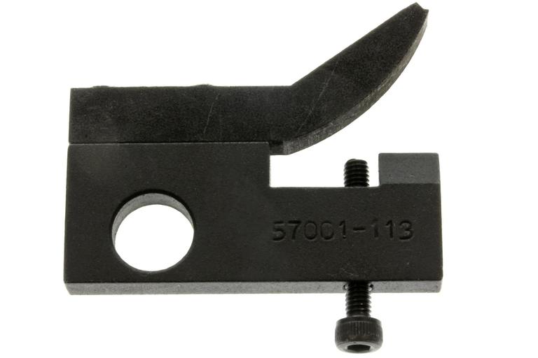

Its really hard to guess what size shims will be in any bike. Unless someone sunk the valves big time doing a valve job, the common shim range is 230~285.
When you do your valve clearance check remove the spark plugs. It makes it so much easier to turn the motor over. Use the 17mm nut on the advancer unit, not the smaller bolt head.
After you replace the valve shim with another, rotate the cam around a few times to like seat the shim in the bucket. Then check the clearance.
That way you are sure that the shim is fully seated and there is no extra oil under the shim. If you don't do this, sometimes your clearance will be a bit tighter than what you will have after it runs for a while.
If you plan on keeping your bike for a few more years, spend the bucks and buy the real Kawasaki shim tool. It makes the job go so much faster than those other shim tools!!!!
That tool ain't cheap, but its worth every penny of its cost in my book!!!!!! Part number is still 57001-113

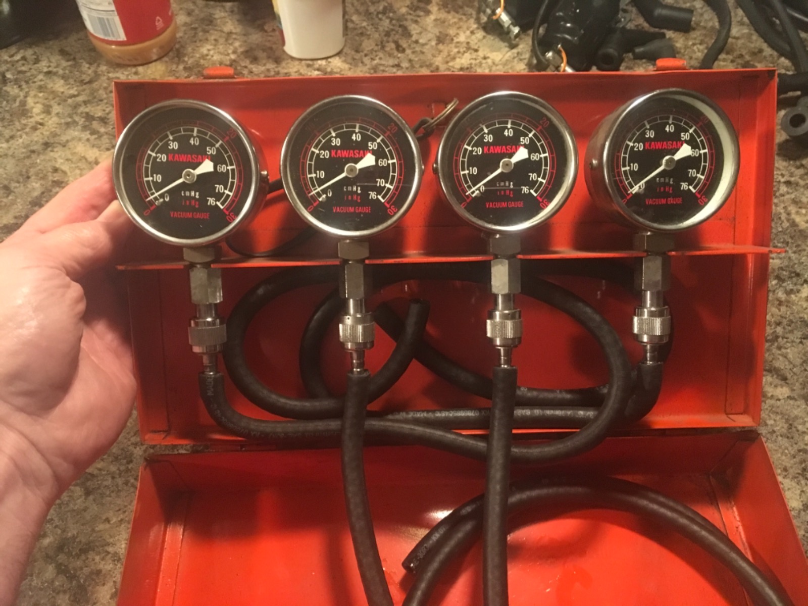

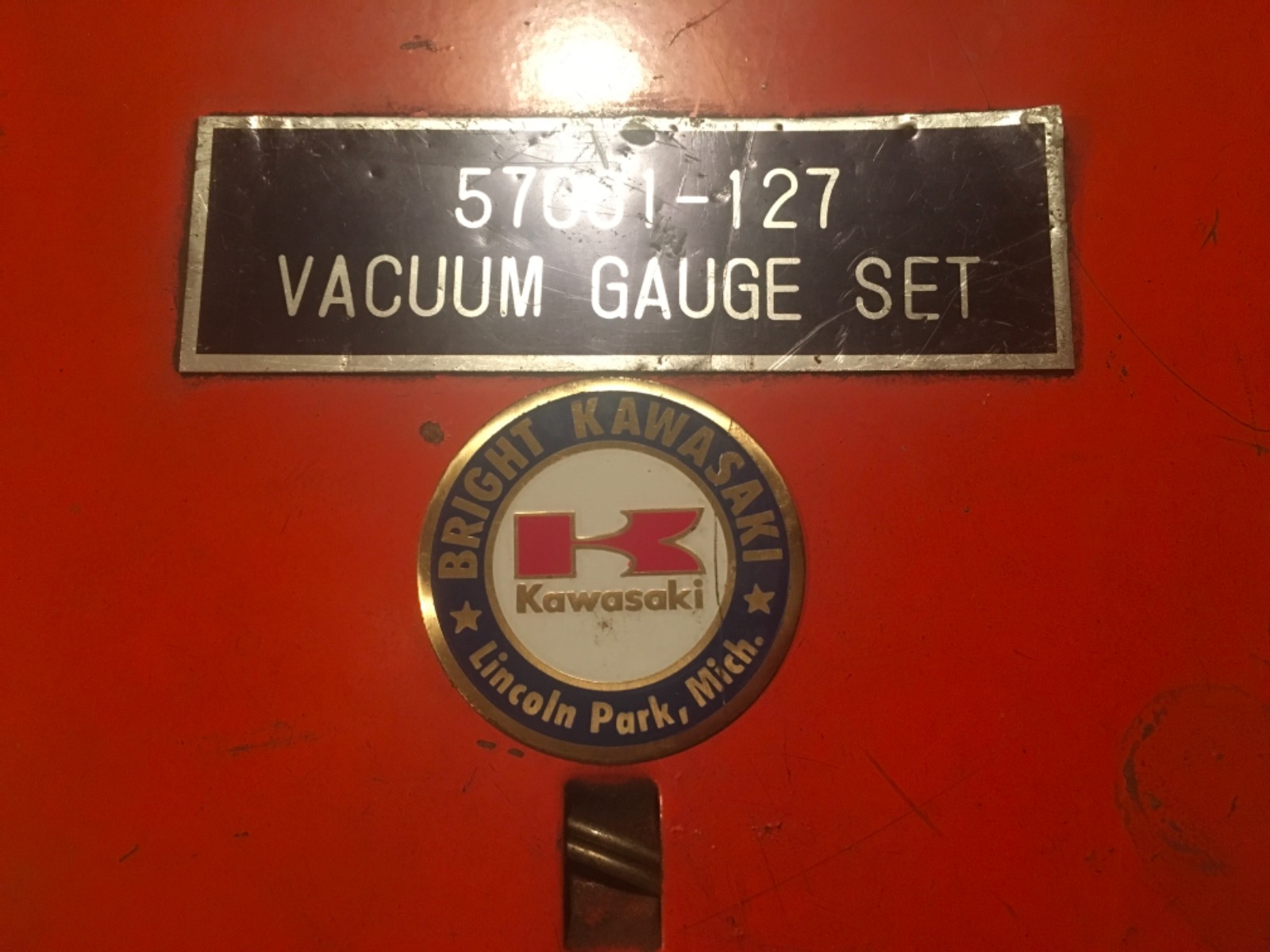

11 Jun 2021 20:06Mike, maybe, my local Kawasaki dealership has even offered to loan me their spoke wheel truing stand. They have drawers full of shims they say will never be used. I asked them about doing a one for one shim trade upon a recommendation by Rick H. His local dealership offers him the same trade options. My dealership has even sold off 95% of their Kz specialty tools. I happen to get one back that I found on evilbay. I bought This factory sync gauge set from a seller in Florida.See if there is a Kawasaki dealer near you. Most times they are willing to “trade” you shims without any cost
