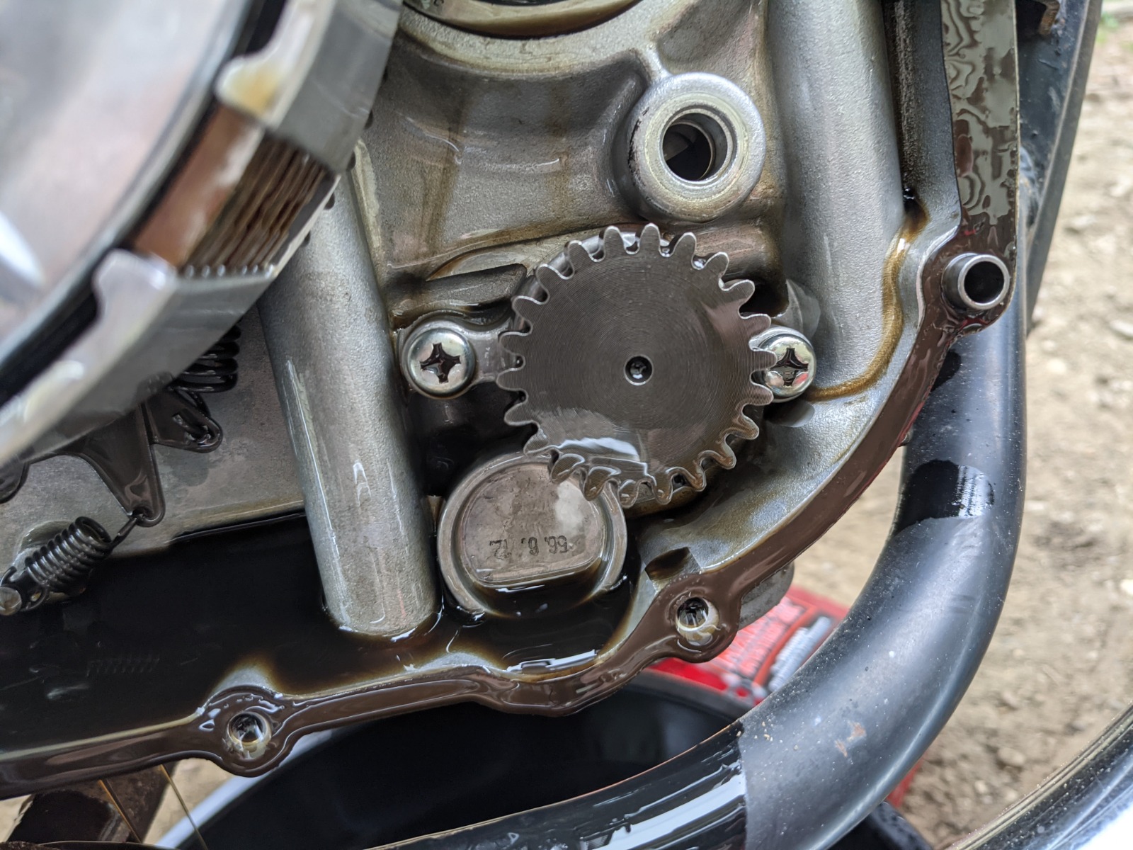

07 May 2021 14:47 - 07 May 2021 15:02Uhhh...so I'm inside (thank you impact tool!) and I'm looking right at the scene you pictured....where is the strainer???
NVM. I knew I'd find it 10 seconds after posting, that's why I posted.

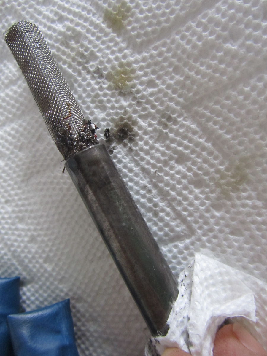

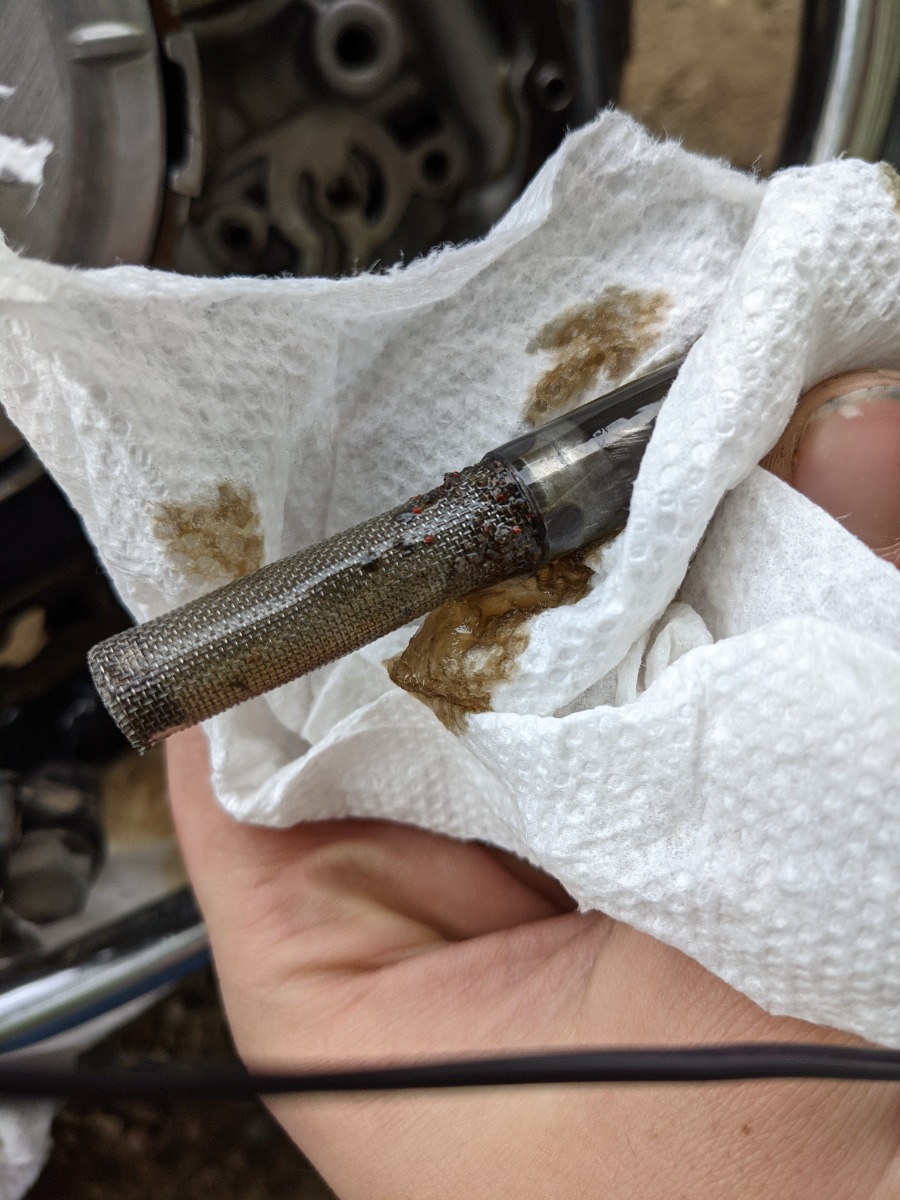

10 May 2021 15:14 - 10 May 2021 15:19The oil strainer. Doesn't look too bad until you look at it under the microscope and see the cylinder shavings and chunks of red plastic from the alternator. I decided to replace it because the plastic at the oil pump end was kind of deformed.
I couldn't find the cursed bolt that supposedly obstructs it, probably have to go deeper than I'm willing. I shined a light into the orifice and couldn't see anything intruding. For braver explorers its probably near the pointy end of the pencil in the image above, in that blind gallery.

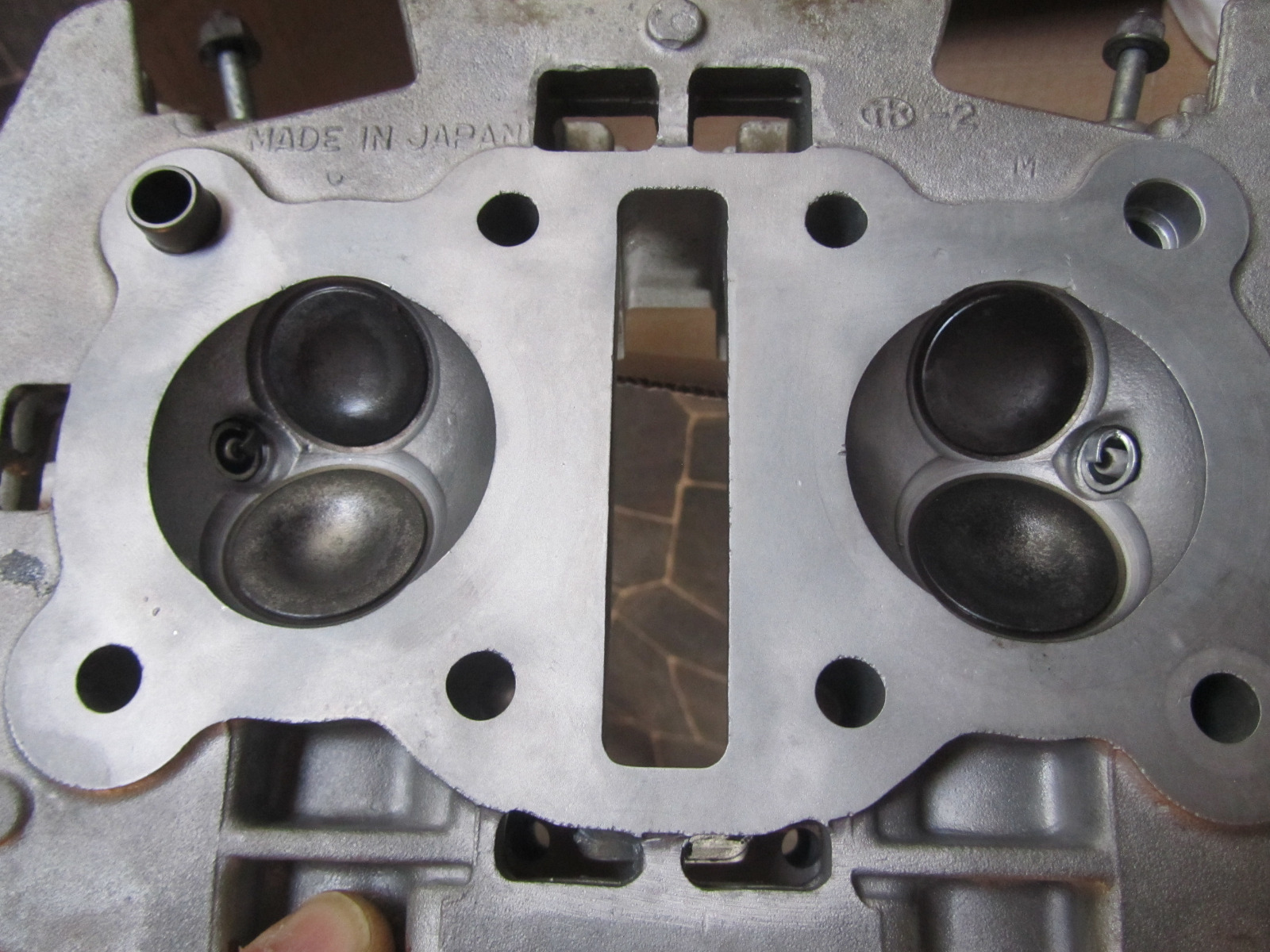

Here she is after the honing, for better or for worse. Hopefully it will get me through a season or two while I hunt for my next cheap bike that now I'll hopefully be able to fix. Assuming this all ends well, which I'm not assuming lol.
I'm very proud of my first valve job, even though I didn't do it. They couldn't have done it without me!

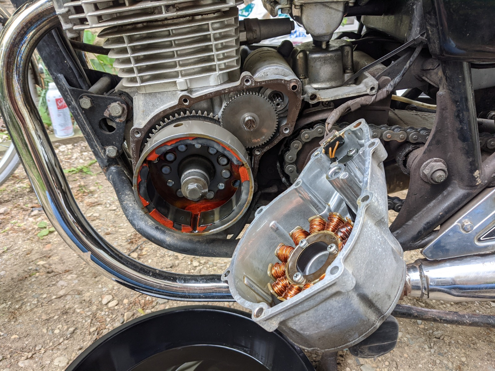

I think I have it figured out - I'll try to get myself into it tomorrow to get some good pics for you. The general idea is removing the clutch cover (and gasket) as well as the timing cover on the opposite side, then using a long object tapping out the aluminum plug described in the article I shared last week. I've circled the spot that the long object goes into, but I haven't been under the timing cover on my bike, so pics to come.
The article's photo is from an upside-down perspective, but I think I have it right. Hoping my next house has a paved driveway.

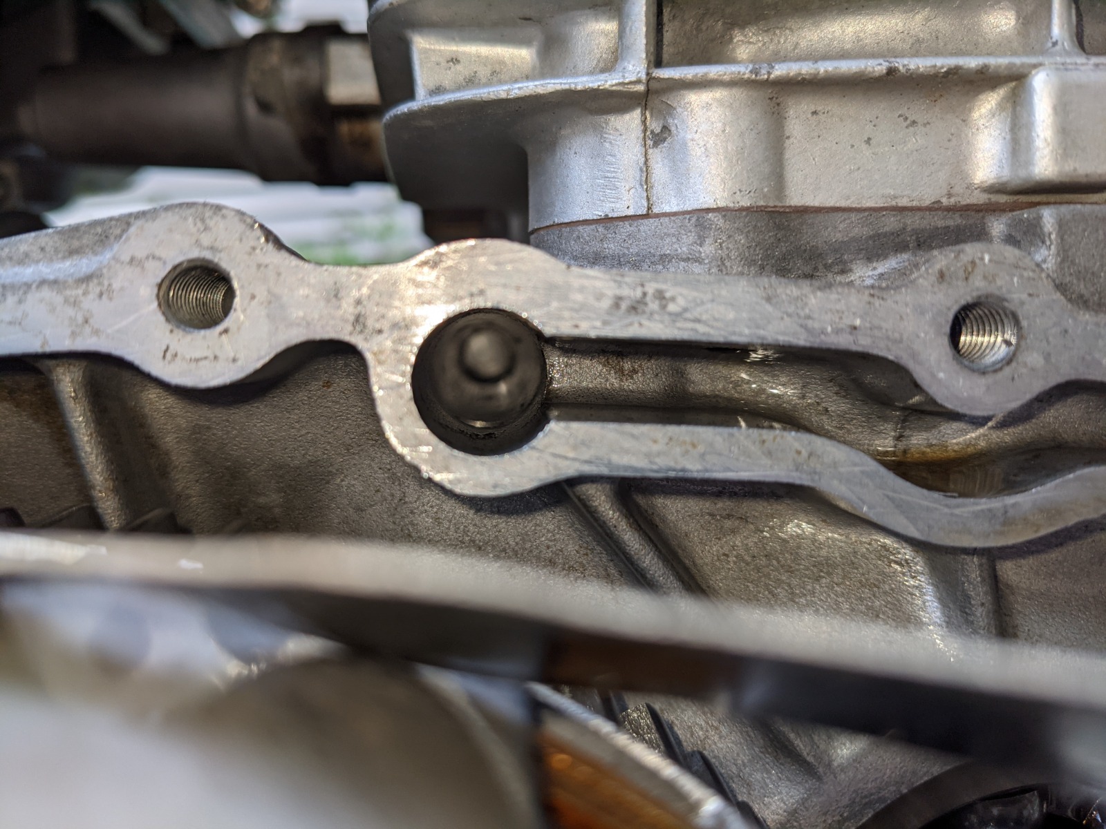

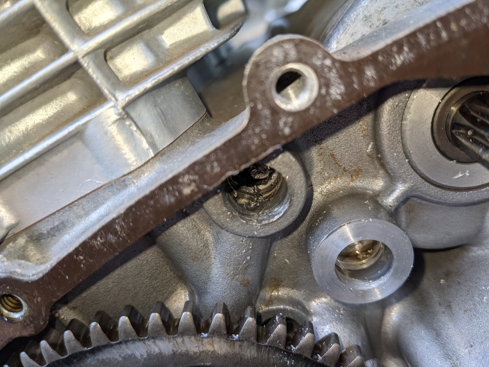

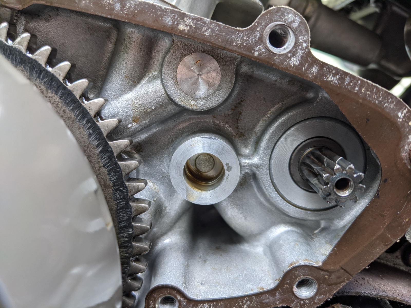

Mixed results from today's work.
Clutch cover off, here's the channel that goes to the back of the aluminum plug. I would suggest getting something long, strong, and not larger than about 1/4" or 6mm. There's a ridge in the middle that blocks anything larger.
Timing cover off; you'll need to take out one gear to see the plug, but it just slides off. The plug itself takes a lot of force to pound out.
Beneath the plug. The small hole (hard to see in the photo) is indeed partially blocked by the plug, but as it's on the bottom of the hole, you can modify the plug (once removed) by cutting away only half of it on the inside, which is photographed in the article shared earlier.
As you may be able to tell, I cracked off some of where the plug sits, but it's because I bent something that I was pounding on in such a way that it could only come out from the left side of the engine, and when I drilled the plug out I did a pretty poor job. So don't try to drill the plug out, just hit it.
