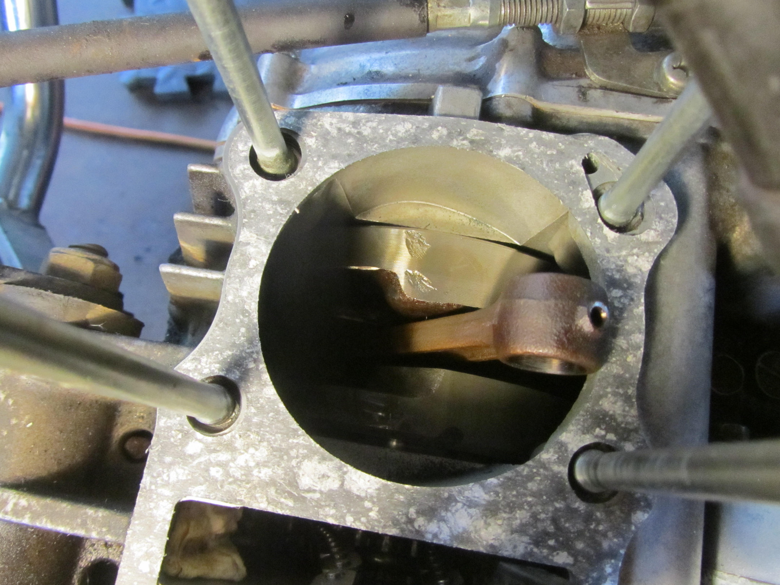

Well golly wolly...sure wish I'd seen this before now but it didn't show up until I tried to level the rods. Problem, or no? And furthermore, WTF? This is on the "bad" piston side so maybe not completely unexpected, but this looks like more than a mere skirt shaving impact (to my inexperienced eye).

Thats the original forged surface, the machining just didn't remove it completely. Nothing to worry about.

19 Jul 2021 19:49Thats the original forged surface, the machining just didn't remove it completely. Nothing to worry about.
Good. Because there's no turning back now.

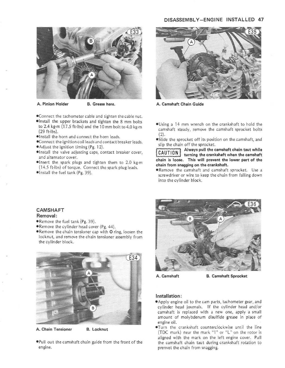

I remember having a helluva time with the confusing instructions when I timed this thing many years ago, and all of whatever I finally determined is now lost thanks to whoever let the kztwins forum die without a backup.
In order to get the camchain back on the manual (last paragraph page 47 below) says to line up the timing mark near the "L" (there is no freeking L) or the 1 (there is nothing discernible as a definite 1) with the timing pointer. There is something that might or might not be a 1 right next to what could be a timing mark but it looks exactly like the other mark. So if one is a 1 and one is a timing mark, I have no idea which is which. And of course you have to stand on your head to see any of this.
Then in [E37] to make it more confusing they show you how to line up an invisible TDC mark near the "F" (they never mention the F) but there is no visible TDC mark there, not in the picture and not on the bike. HA!
So which is it, the nonexistent L or the F in the picture? And am I supposed to guess where the imaginary TDC mark is?

PRAISE ZEUS!! After 2 days of cranking and a neckache that will last for weeks, I finally found the bloody M&%$#@! "L" mark.

Congrats on the new development. It took me a good while to find it too...very frustrating. FWIW, I think that there are two sets of two notches, and the notch on the right should be the TDC/BDC mark (I think the first notch is the firing point?). But whatever, you got it.
