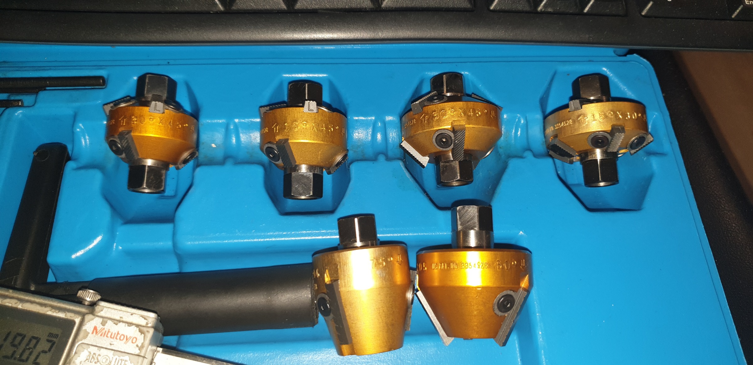

In my Set i have following cutters
NEWAY No. 230 = 30/45 degree exhaust
NEWAY No. 234 = 30/45 degree intake
NEWAY No. 205 = 60 degree exhaust and intake
Will post pics with min/max diameter later, so stay tuned..

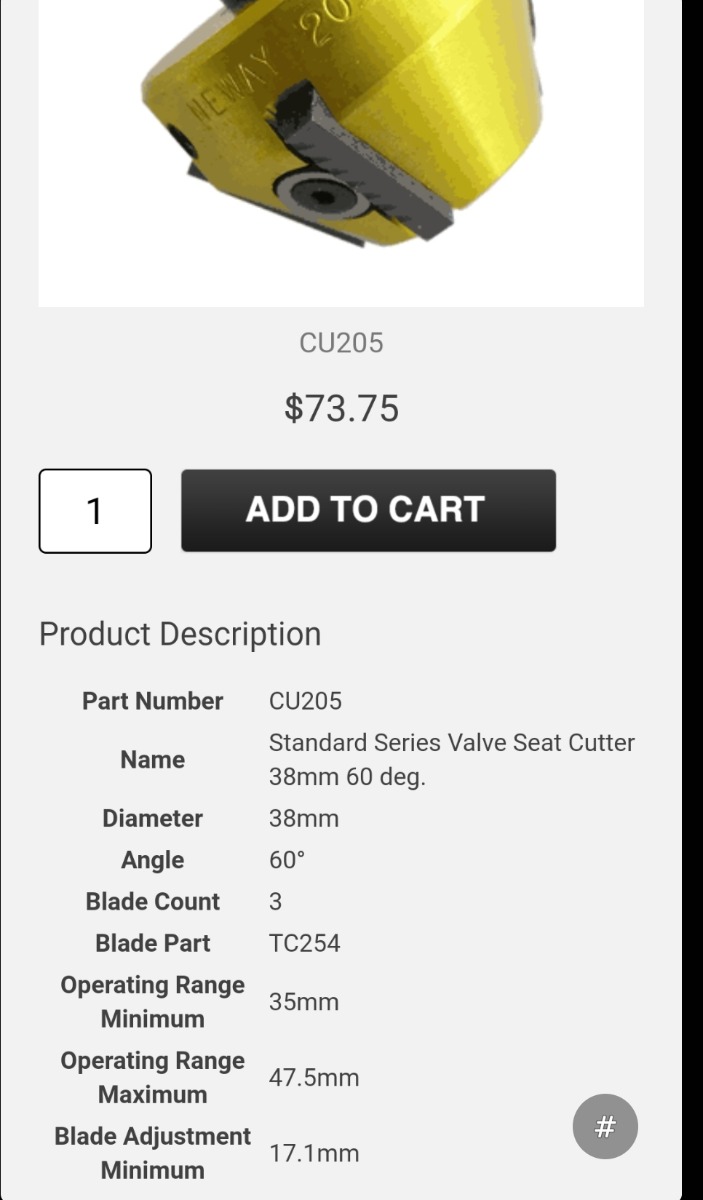

Re: Cutting Valve Seat with Neway
14 Apr 2021 11:07
The 205 cutter works for exhaust also?
Neway says the operating minimum is 35mm.
Appreciate the info!

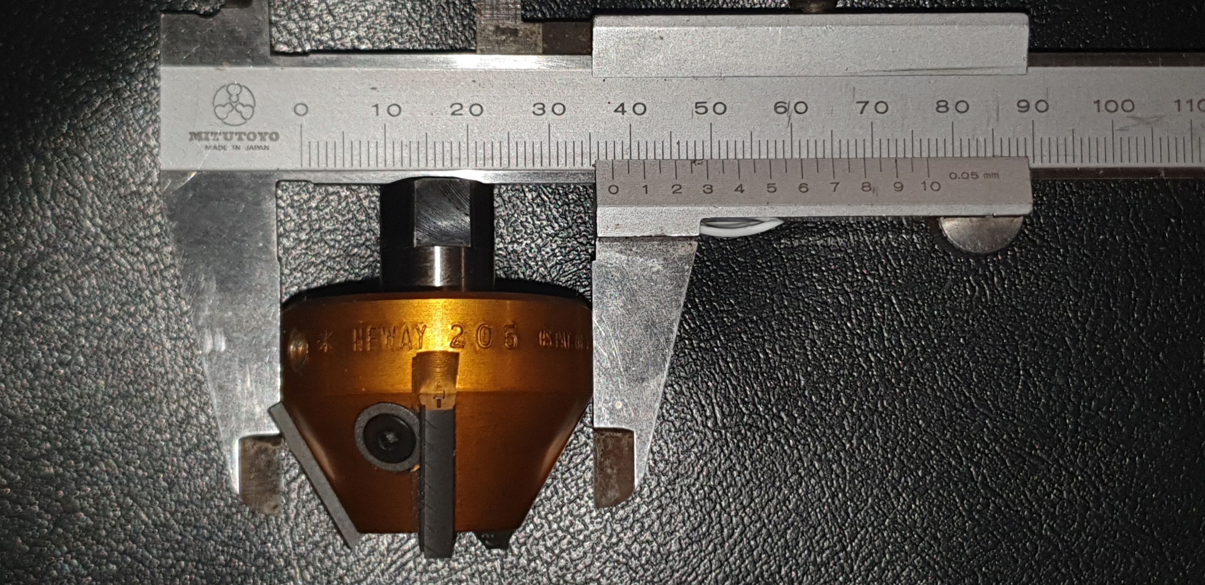

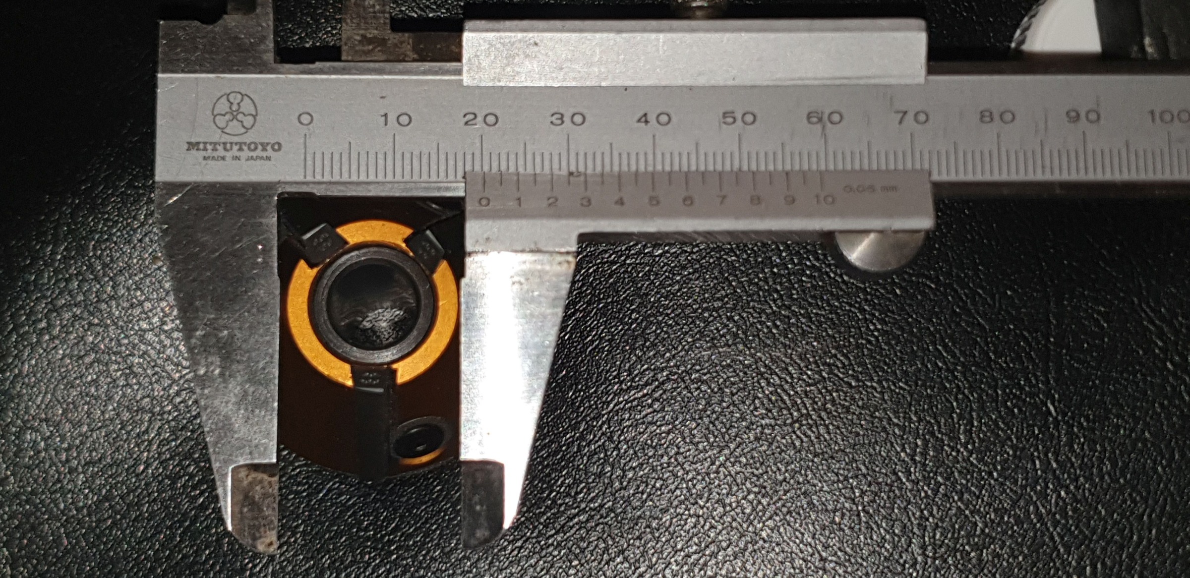

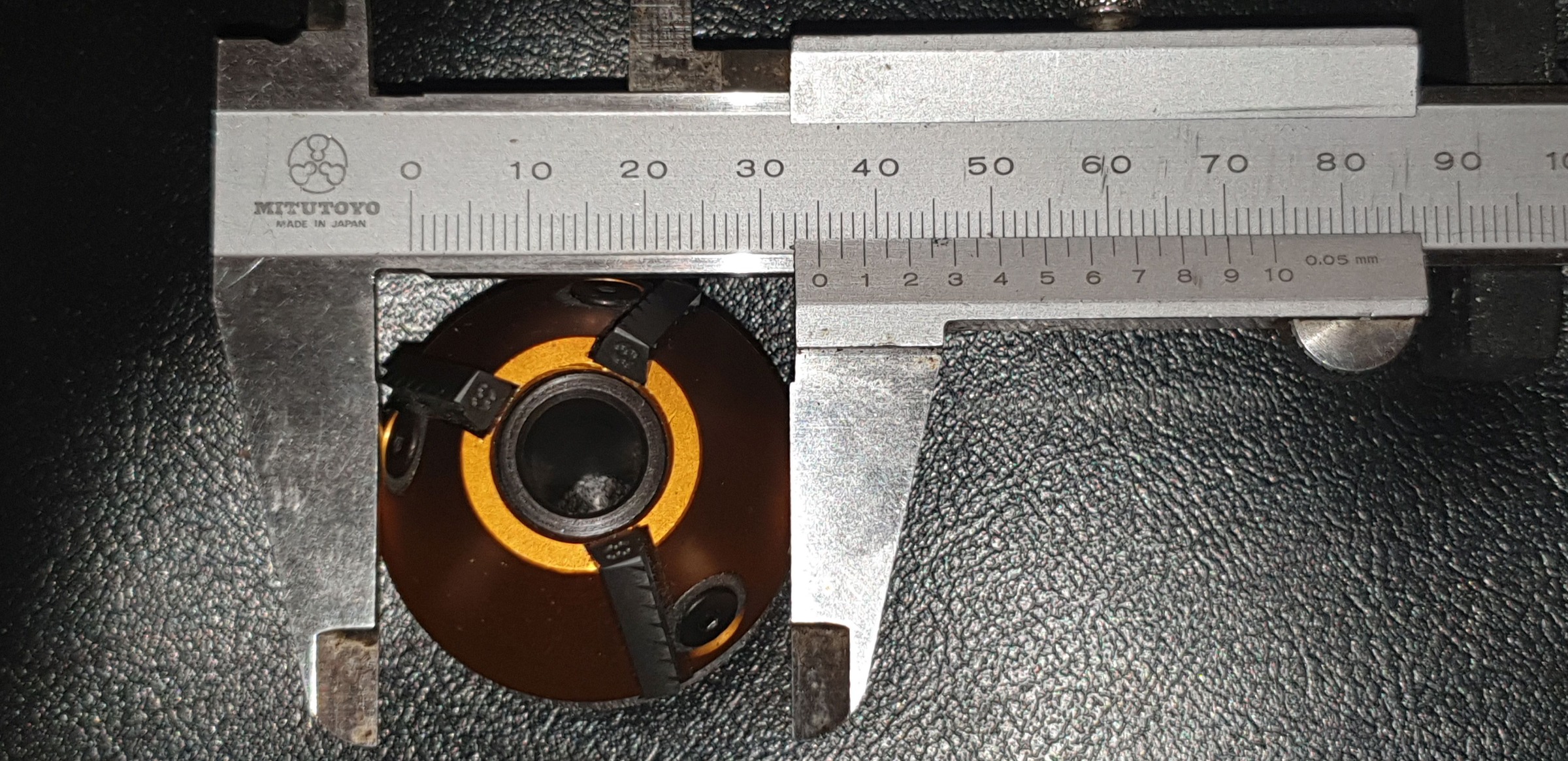

14 Apr 2021 14:44I would say operating minimum is 25 mm. Can pics lie???The 205 cutter works for exhaust also?
14 Apr 2021 16:51 - 14 Apr 2021 16:52
I suppose not! You'd know better than I would, just wanted to confirm.
I'm probably misunderstanding the verbiage.
for reference here's heres what I was looking at:
14 Apr 2021 17:06
With a cutter like shown you can extend the blades down a little below the cone end of the body and get down to 32mm or so. I wouldn't go smaller though.
