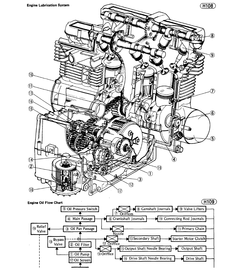

They enure the oil system pressure is high in the bottom end because of the plain bearing crank. Otherwise the oil gallerys at the cams would just dump all the oil and the relative pressure in the entire system would be low. The KZ1000 doesn't need these because the roller bearing crank doesn't need high oil pressure.
obviously this diagram is for the base model and is slightly different form the turbo, but basically the same. Notice how there are orifices before every other oil circuit except the crank journals.

Great explanation, i can see where the cylinder meets the bottom end that there are two so between cylinder and the head these two are to ramp up the oil pressure even more.
Thanks Doc
