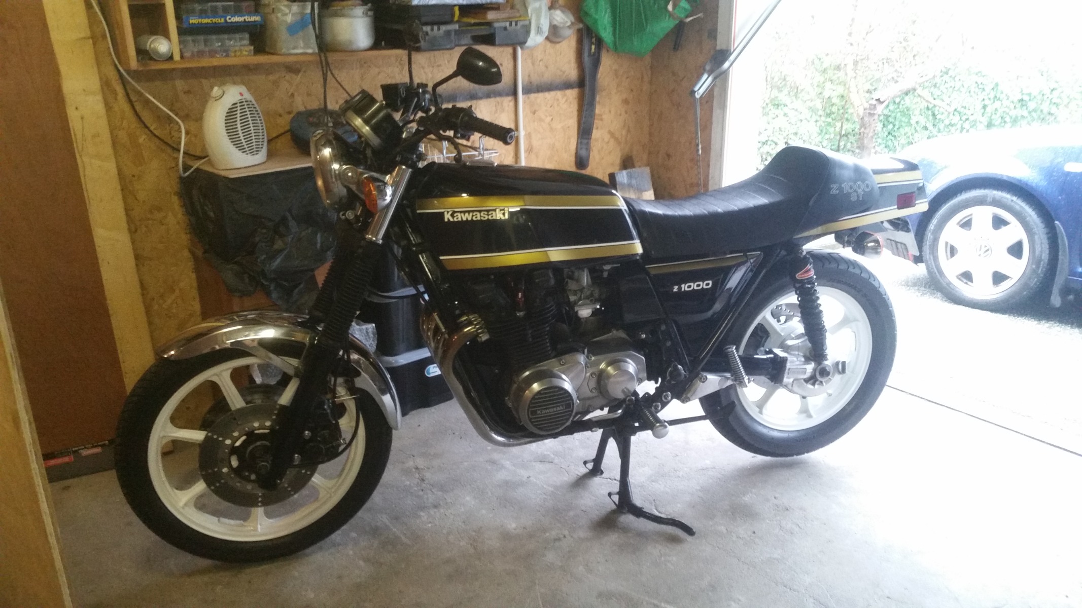

Hey! I like your take on the Paint Job! And customizing to your liking! Looks Cool!! I never was much on drive shafts. But I have bought 3 shaft E's for scrap to dismantal in the past 3 yrs. for the Mark II cranks, cases and top ends! Tried to sell stuff? But those shafties are all a little different on the size of everything?

there's a company near me called wheel wizards that powder coated the wheels six years ago and one of their guys does a bit of general spraying so I gave him all the panels and a roll of gold vinyl and white pinstripe and he did a fantastic "1000H" job
it's really funny at so many bike meets I've overheard "experts " discussing what a good job I've done converting it from fuel injection to carbs!! Once I heard a guy saying "why would you convert an H to shaft drive?!" :laugh: they never seem to think of the obvious that it's just a paint job! As for the white wheels , that's kind of my thing, all my bikes apart from two spoke wheel bikes have had white wheels and I keep them spotless!
Sadly in the uk many of the st's along with xs1100"s and gs1100g's were turned into trikes and some are still being converted to this day! I'd rather see a chain conversion carried out than a trike job I must admit....:side:
