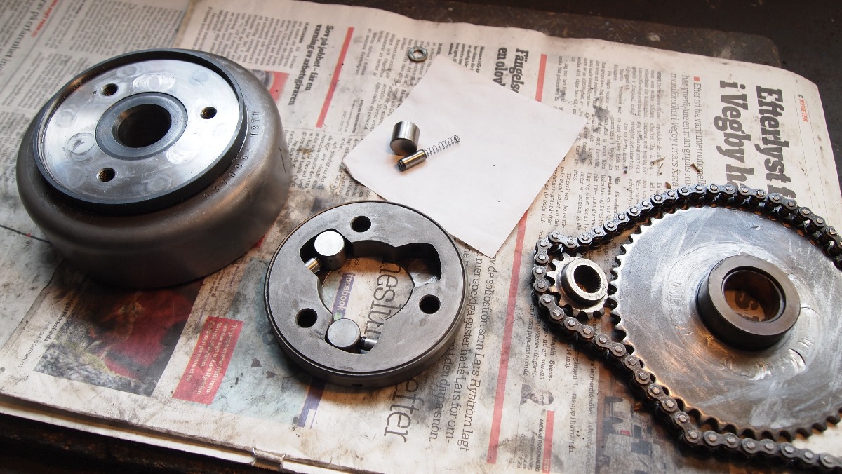

Sounds like a starter clutch problem.

Hey, what Nessism is saying that in order for your starter motor to engage your crank to turn you engine over there is a starter clutch to engage and release when you start. This system can fail easy enough in older unused bikes. The starter clutch has nothing to do with your actual clutch, below is a pic of the system.

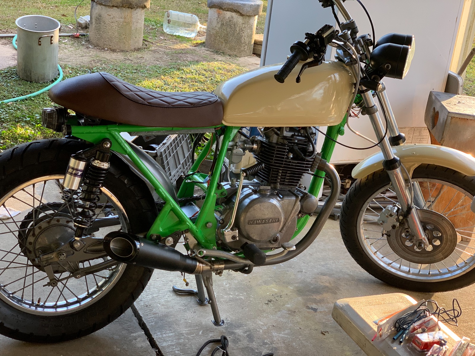

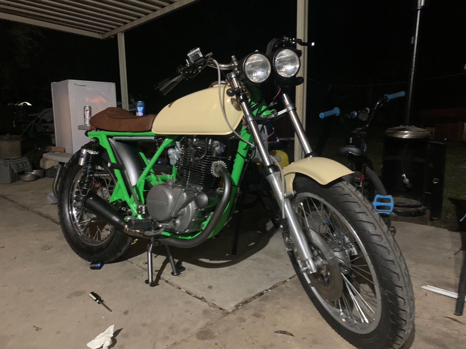

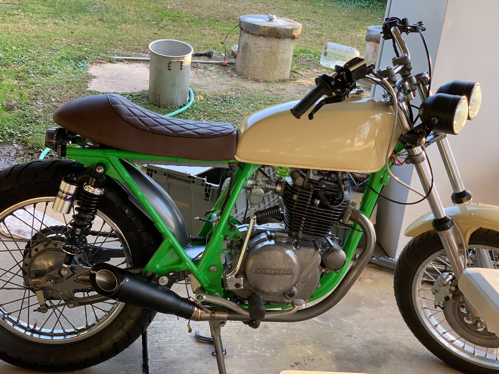

Thank you sir. Hopefully here’s a couple pics of the bike

Nice tidy bike there the first 2 were a mulligan . is the engine turning over freely on a slow kick?
