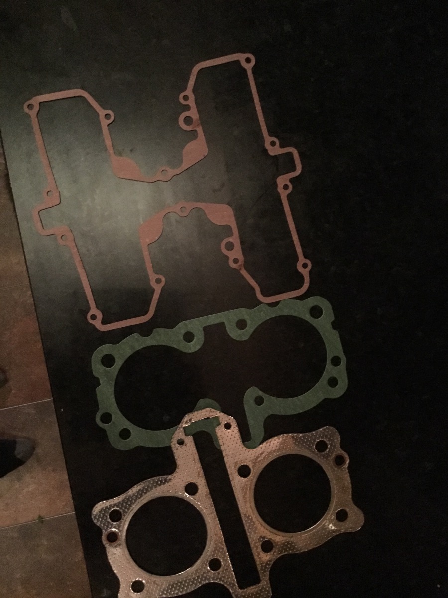

So this is what I have, I’m easy on replacing all of these as I’ll need nearly a full set after I’ve taken off the side casings and what not.

what brand are those gaskets? the head gasket looks very shiny. I haven't used any of the aftermarket head-gaskets so i cant comment on their quality. The brown and green OEM ones have a glue like coating. The very front left of the cam chain tunnel makes the casting pretty thin. this is where most of the leaks i have seen start.
The following user(s) said Thank You: kzstreetfighter71

They are an unknown entity Doc, they were given to me by guy who I got the bike from, at some stage someone had an idea to sort it out before it was pushed in a ditch to die. I’ll start a build thread tonight.

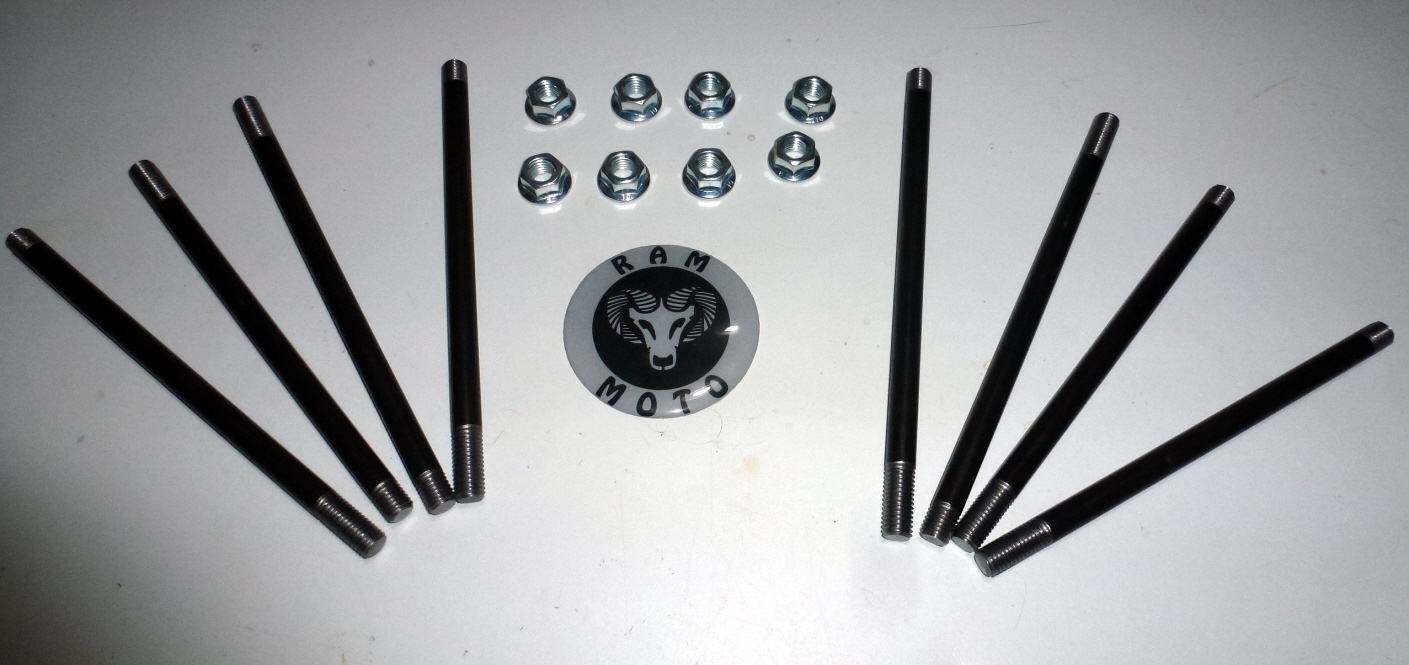

it just occurred to me that this guy was posting KZ750 twin HD stud kits on another forum.
hes in the UK
realmengineering.com/two-wheels/
hes in the UK
Last edit: 14 Jan 2021 11:59 by DoctoRot.

14 Jan 2021 13:02DoctoRot wrote: it just occurred to me that this guy was posting KZ750 twin HD stud kits on another forum.
hes in the UK
Thanks Doc, ill follow this up and let you know how i got on!
