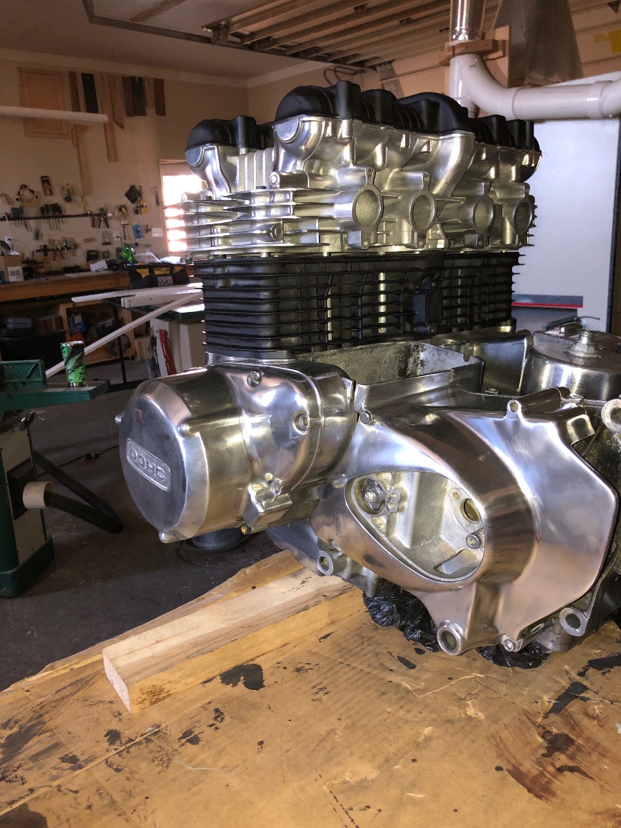

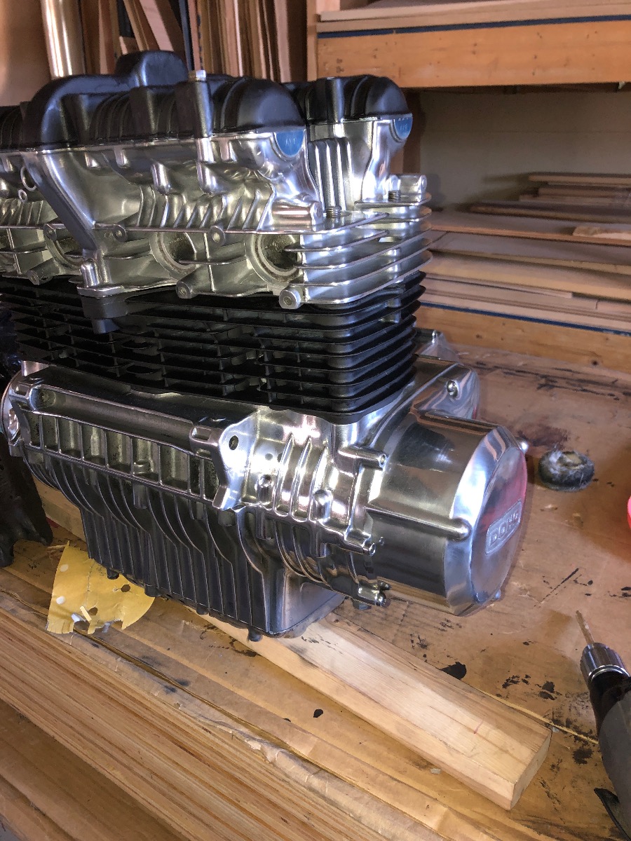

engine is a 76 Z1 72 mm 10.25 wiseco kit. Going for a street engine/ wheelie machine.Keeping the 26mm mikunis(like the look).Got a MRE back cut trans with billet 2nd as well.
