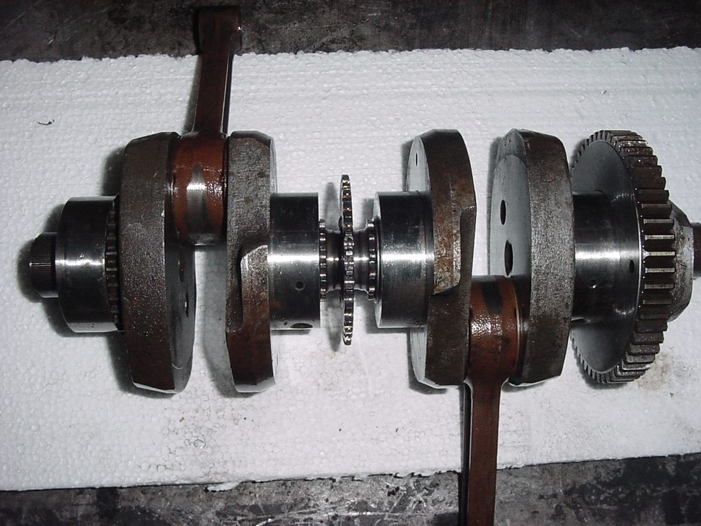

If your current crank is a good one then I would get that indexed and welded.
Done correctly the crank needs stripping , inspecting and then aligning and welding.
Any fault will be found during that process and action can be taken but you will end up with a crank that is know to be up to the job.
Buying one already done is taking a risk on an unknown quantity with nothing known of its history and it may well be twisted or heading towards the end of its life if it's been run in anger on the track.
Generally speaking though these cranks are pretty hard to kill and most have been welded for use in road bikes that never actually get anywhere near the revs or traction that takes advantage of having it done.

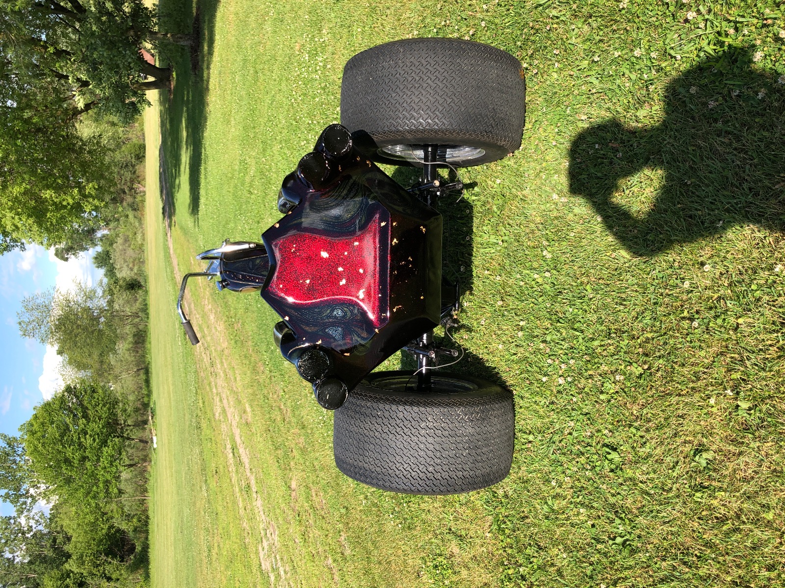

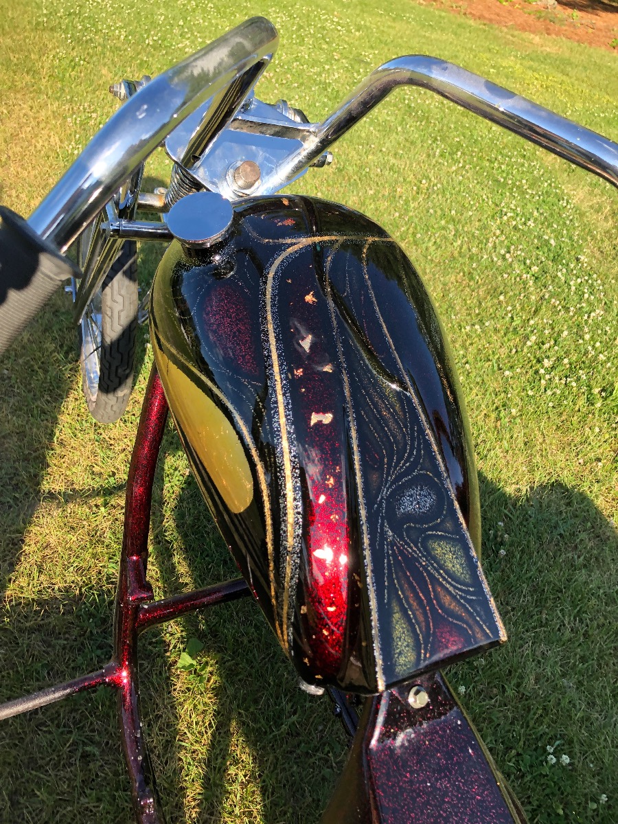

That Just Screams "Big Daddy Roth", "Rat Fink", "George Barris"!! I grew up in the 60's! Dreaming of this stuff, building model kits and staring at Hot Rod mags!
I've watched your build from the start. Nice Work!!!! I paint and do minor fab work also. Now the time it takes!

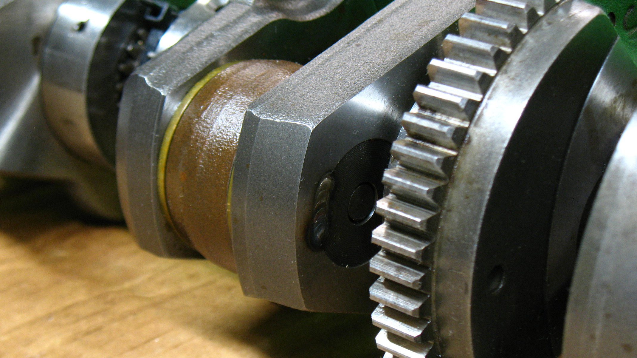

Cranks? Start fresh with a virgin crank!!! Have any competent machinist! check for true and straight 1st.
Before welding pins! Of course. And the welds have to be tig welded. Inside ones are tough! Once they are welded that's it! I have went through a lot of this stuff over 40 yrs! I have seen barn jobs, were a stick arc welder was used.
And If anyone has ever seen a crank guy working on a Kaw pinned crank you would think they were destroying it. A Barney Rubble 3 or 4 pound hand sledge! 1-1/2" pieces of round tool steel! Beating on it between journals! to move it .001, 002"
Or, you could always go with the milled down center cap with the tool steel plate and the heavy duty crank case studs!

Thank you for the compliments Z1KZ.I am getting into the final bits but this girl HAS got to roar again.Once rolling She will be around the midwest and further for sure.I was a dirt road farm boy who dreamed of Ed roth and wild ass funk from the beginning(glad theres others ).I will keep the build pics coming but I have # projects going right now and I'm still gathering on this one for now but end of winter will be engine Re assembly.
