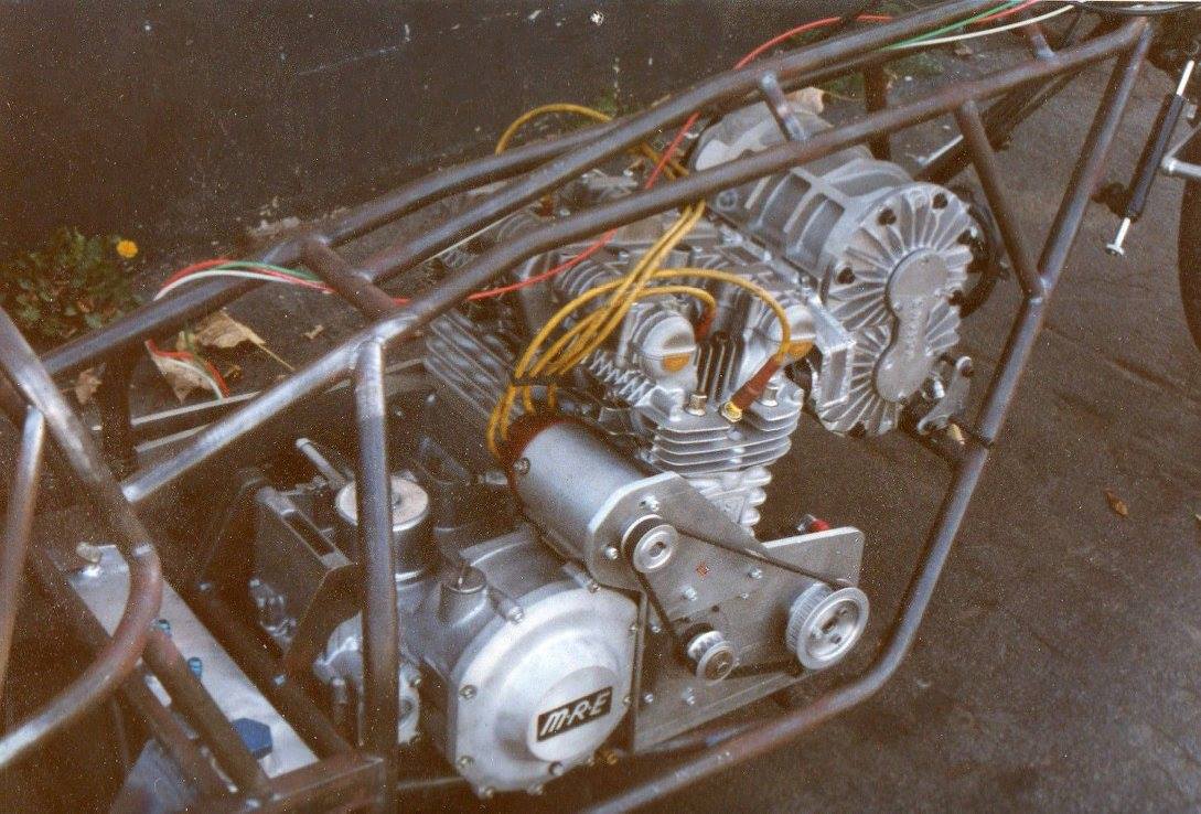

Jim designed and built a 2 stroke, Single Cam, Nitro / Diesel Blower engine.
It did run, there is old youtube video out there of us running it in Shrievport, LA. around mid - late 1980's.
Never did make it reliable! Some people know of it.
