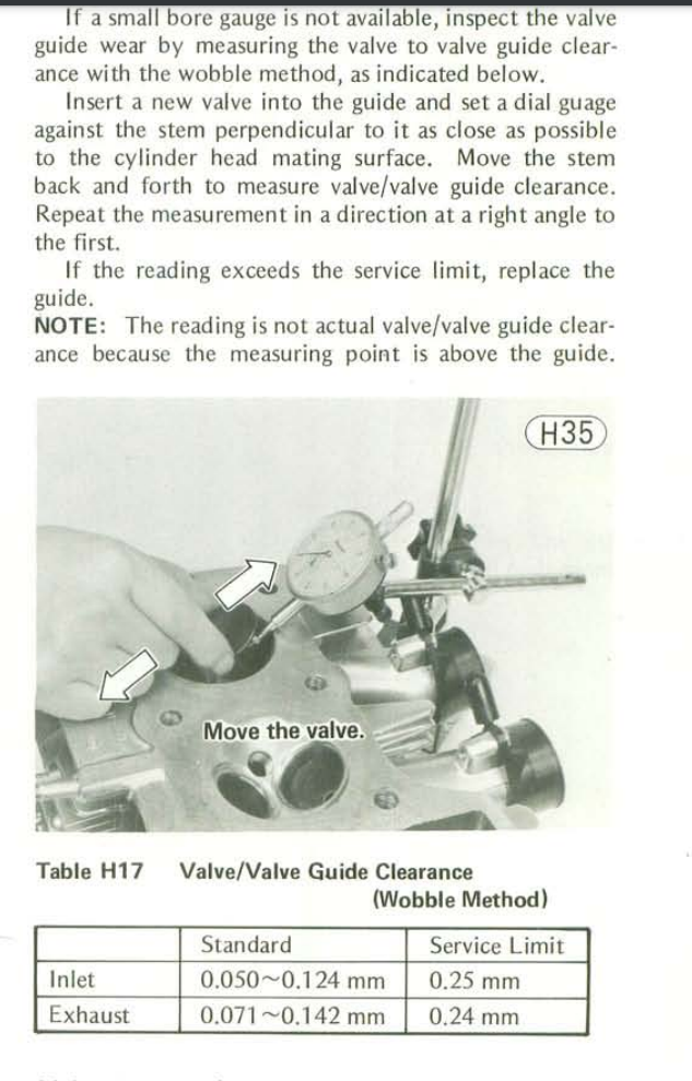

And as Gamma says, you should check the guides. The wobble check is crude but reasonable.

@gamma: Please only positive oriented comments.... Those guides are okay!!,,,, hell, you're probably right. Worse, I don't have a clue how to check them much less how to correctly replace them out.
