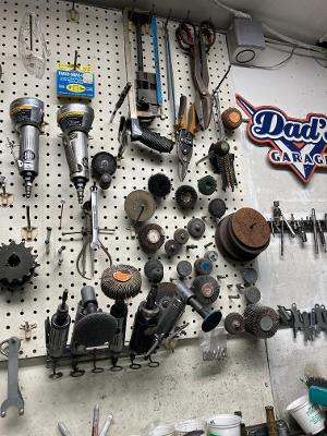

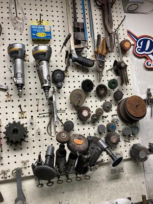

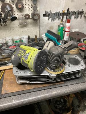

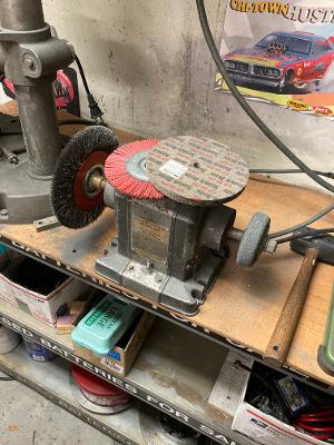

OK! Carbon for the amateur. Tough stuff! You need AIR! lots of cfm! Lots of 1/4" grinders! Lots of 3M SCOTCH STUFF!!
But start of by chipping away with a small chisel type things! ALWAYS HAVE SAFETY GLASSES ON! Clean chip grind away.
Then I always glass bead everything I work on. Been 40 years so far! I took the last picture today! for another customer.
Nothing is easy! And I also use RYOBI! When the compressor is building back up and cooling! I use the battery ryobi items.
3M, SCOTCH is the best stuff going! Not Cheap! But it is 100% better than chi-comm crap at the chi-comm harbor store!
You get what you pay for! And it takes money to make money!
I do buy and throw out the chi-comm grinders monthly! take back and get free ones! It's easier to change the wheels and whatever. Keep 6-7 on hand!
JMO!
