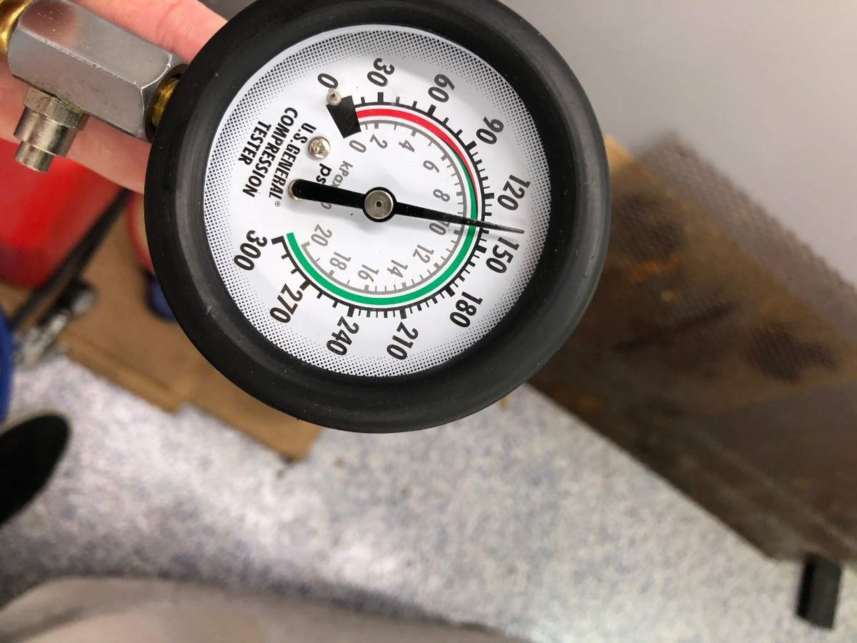

Next thing I tried - checked compression today on completely cold engine. Dry numbers on cold:
145 130 135 150 good, but 130 vs 150?
Checked with little oil in spark plug hole:
225 225 205 220
Better, but cyl 3 not consistent?
Any conclusions from those numbers?

If it were mine, I would check my pressure gauge. That second set of numbers is really high.

15 Dec 2020 19:45hardrockminer wrote: If it were mine, I would check my pressure gauge. That second set of numbers is really high.
I was really surprised too. Those are Harbor freight gauges so they might be off. But consistency is there, so even if they off, do those variations bad?

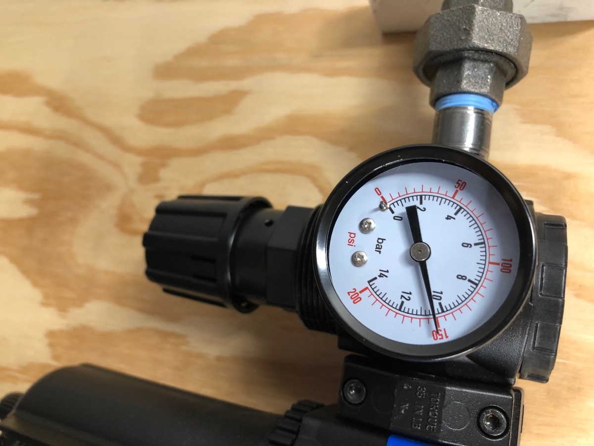

You got me curious. The only way for me to check gauge is to hook up to my air line in garage. So, I set pressure regulator to 150 and hook up gauge I used for compression test. If anything, it "lies" other way.
