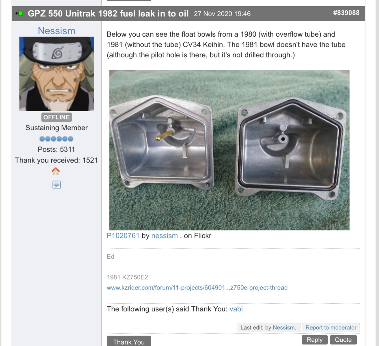

My Kawasaki manual shows no carb drains in the 1981 and newer. Emissions issue I believe it says. I can see the bottom of the bowls do not have the ports drilled.
I am wondering if the stance of the bike allows an overflowing bowl to flow back to the air box and drain into the crankcase breather without also flowing out of the air box drain. Maybe the time that the oil level returned to the lower level the float worked properly and the motor was hot enough for the fuel to vaporize and be pulled out to the rebreathers and burned ? Just spitballing here.

All Tk22 manual-slide carbs from any year came with bowl drains and overflow stand pipes inside the bowl, all the way up to their last year which was 1983 on some models. It looks like you have the stock Tk22 carbs in the avatar photo if that's your bike. If your overflow pipes are sealed then it's a modification.
Inside the bowl, there should be a small brass pipe coming up from the drain screw area. That is the overflow pipe.
The non-overflow carbs started in 1982 and they were Tk26 cv carbs, but they may have been manufactured in 1981. They are easy to identify since they have large round chambers on top for the diaphragms.
When it overflows through the carb throat, gas will just follow gravity, so it can go into the engine or the airbox depending on how the carbs and bike are angled.

I believe this is what I had read. Missed the part about it being a different carb. Now (as usual) I am confused as to how an overflow wouldn’t flow out the bottom

Ed (Nessism) is referring to Keihin CV34 carbs in that photo. I think those are for a Kz750, (maybe Kz650, not sure). But those are not found on a Kz550. The Kz550's use Teikei brand carbs. The thread he was replying to was about an 82 Kz550H which uses Tk26 cv carbs, and those do not have an overflow tube, so his post still applies to that bike.
Your Kz550, specifically, should have Tk22 manual-slide carbs (as I mentioned). They definitely have an overflow tube. The drain screw on the bottom is actually a valve. The screw does not need to be removed to drain the bowls. The screw just needs to be loosened and then fuel will drain out through the drain tube on the bottom. This is how you do a fuel level inspection with a clear tube etc.
When the screw is all the way in, the drain function is sealed off, but the overflow function should still work. If it does not, then it has been modified, or more likely it has been clogged with dirt. If you remove the screw, you can clean it out and maybe blow out the overflow tube with a syringe and water. Be aware, the drain screw has two orings on it and they may need to be replaced.

Yes. I have the carbs you state. I drained fuel again and all was clear I forgot to lightly blow air back through to verify the overflow tubes are clear. This week I left the bowls empty while I was gone. Will see if any fuel got into the bowls when I return and then blow through the overflow tubes.
