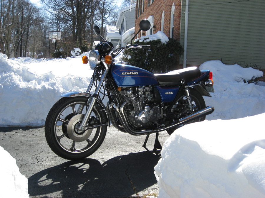

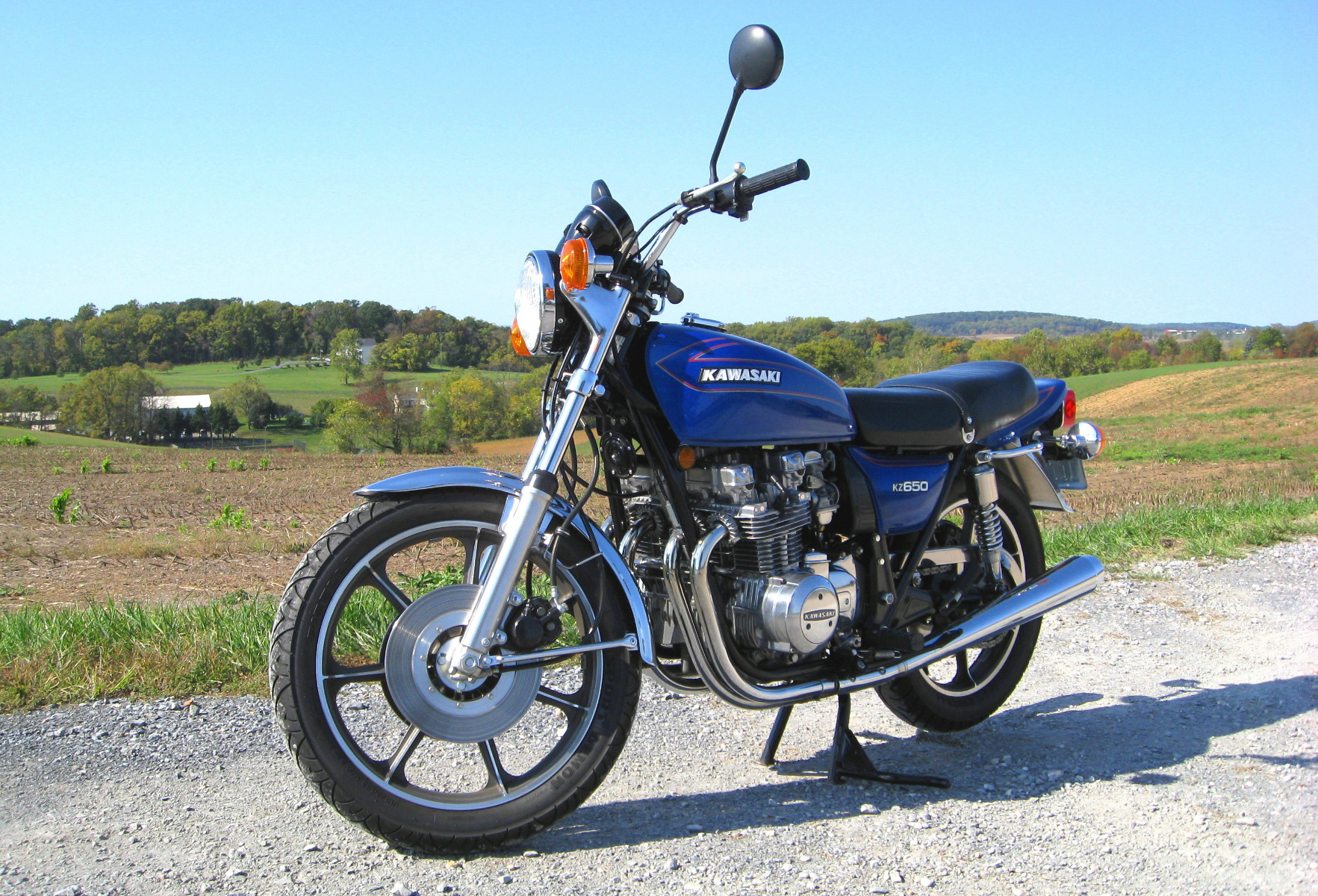

Riding the bike once a week is the best way to keep everything up to snuff. However, I run my KZ650 engine for about 10 - 15 minutes once a week all winter long without actually riding the bike. That allows the engine oil, etc. to get hot, the cylinder walls to be coated with fresh oil, and the battery to stay charged. I've owned my KZ650 since 1977 and have done this for more than the past 35 years. My bike still runs great, has never been rebuilt, has the original exhaust, etc. Maybe this is not the very best way to keep the engine in tip-top shape, but it works fine for me. Below are a couple pictures of my bike. Ed
