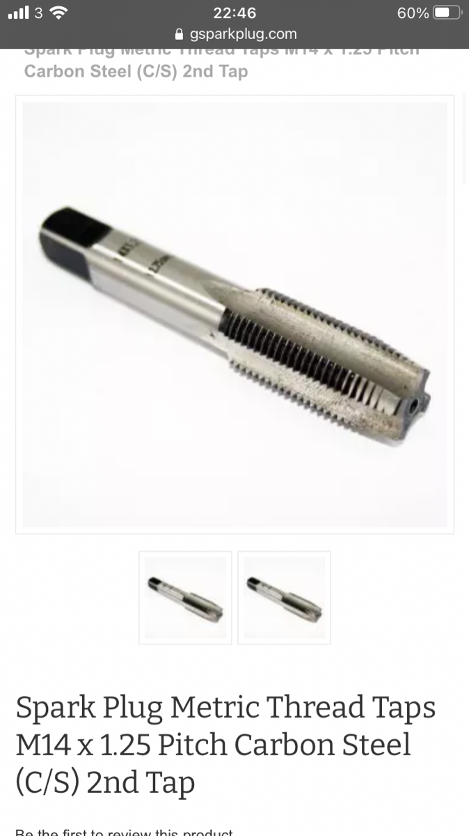

Is this the correct size?

Yes! M14 X 1.25 mm

A thread chaser would be better than a tap. It takes out less metal.

Hi, grease in the flutes and only start by hand till it finds the thread, you tube advice.

I back the tap up and out of the hole often to clean debris off the tap and re-grease if needed. The less junk on the tap the less chance of something getting in the bore. If possible use a tap handle to help keep the tap straight . I usually put the piston at close to TDC so I can peer in the hole with a pen light and see if any junk fell on top of the piston. Just don't bang your tap into the piston. If debris does fall in the cylinder you can try to vacum it out or use a long Q-Tip with a little grease on the end to retrieve the debris. Itty-bitty debris usually blows out, but big chunks can cause problems.
