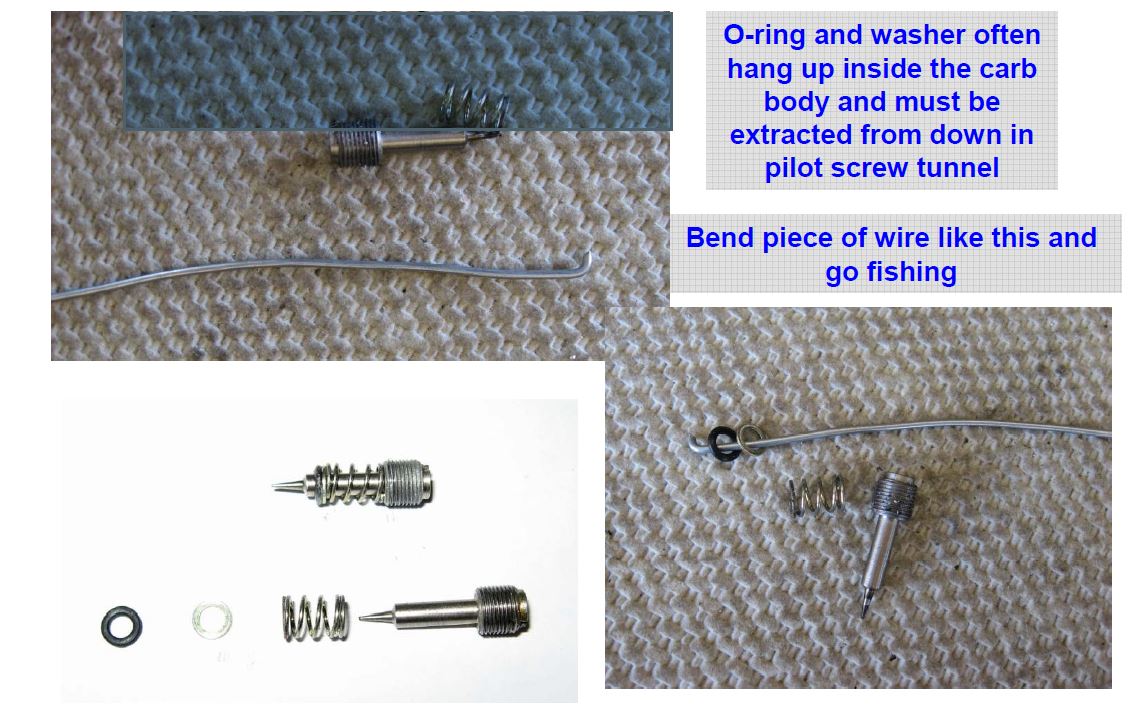

You're supposed to drill out the plug and remove the pilot screws so the passage can be cleaned out. Be careful because once you remove the screw there will be a spring, metal washer, and O-ring down in the passage that needs to be fished out. A new O-ring is strongly advised and when you install the screws set them at about 2.5 turns out from lightly seated as a good starting point, then tune them a little thereafter until you achieve the highest idle and smooth off idle performance.
