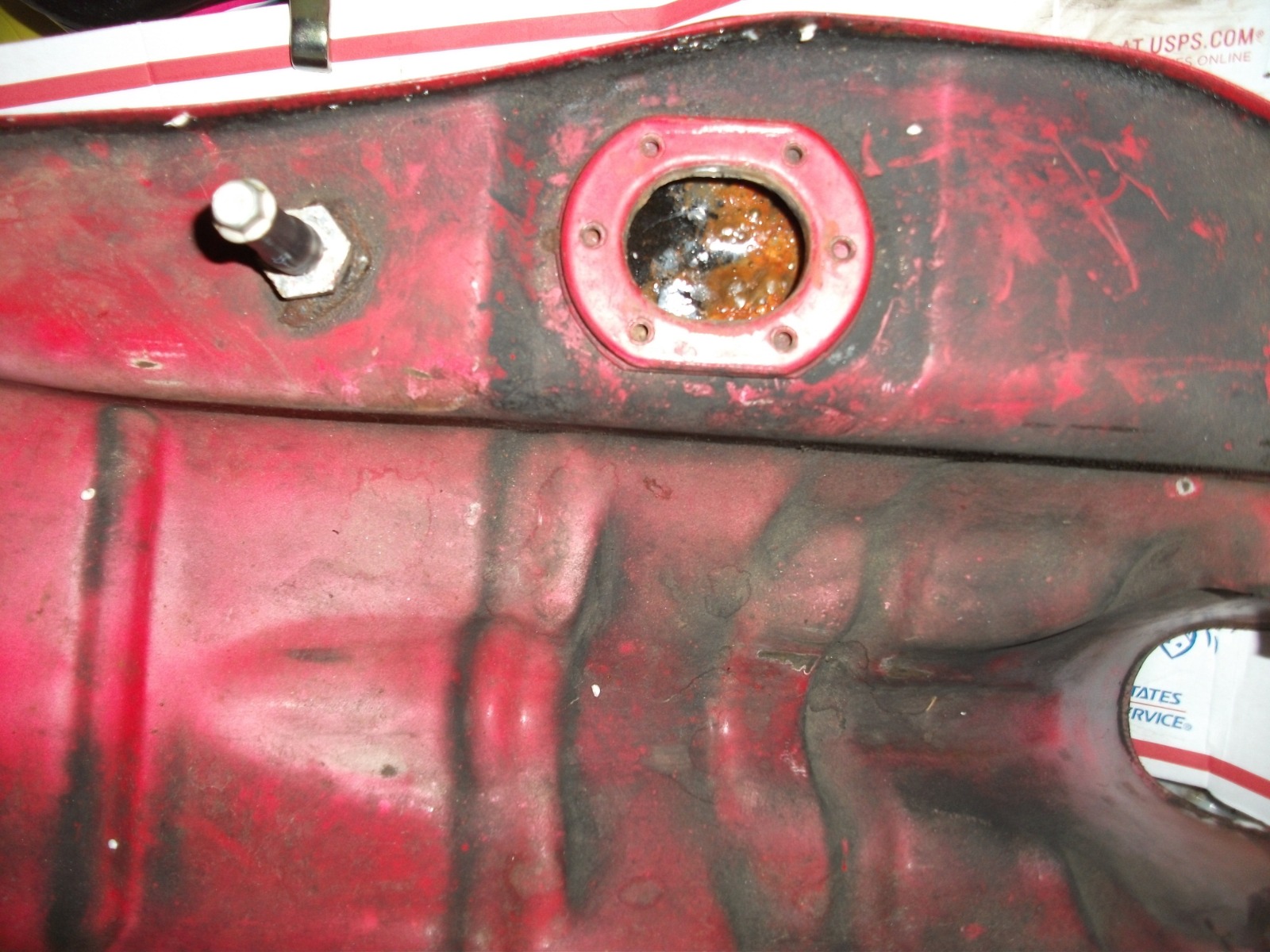

I just watched a video.Holy cow Batman I think your on to something.My tank looks clean but after watching video it must be done.Im going to buy the carbonate and hook it up with clips to a deep cell battery.I let you know how it comes out.Thanks again that will save me from pull carbs all the time

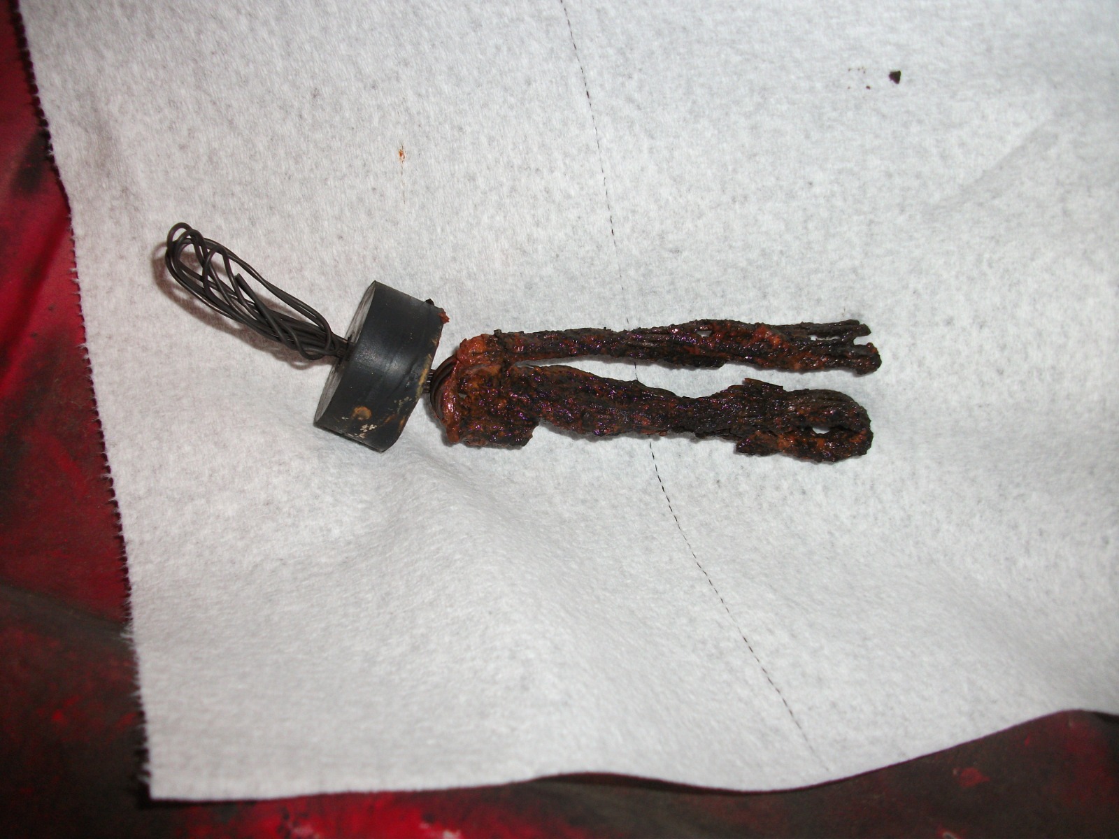

Here's some pics of the GPZ tank. I use folded-over iron rebar wire for the anode and a manual battery charger.

I've resurrected lots of bikes that have sat for awhile. Old tanks will have lots off debris in them depending on how they were stored. Definitely use a filter and check it often until you get a chance to clean the tank. I usually use an acid solution and flush it well. There are lots of new more environmentally friendly options for removing rust now. Haven't tried electrolysis but it sounds like it should work for rust.

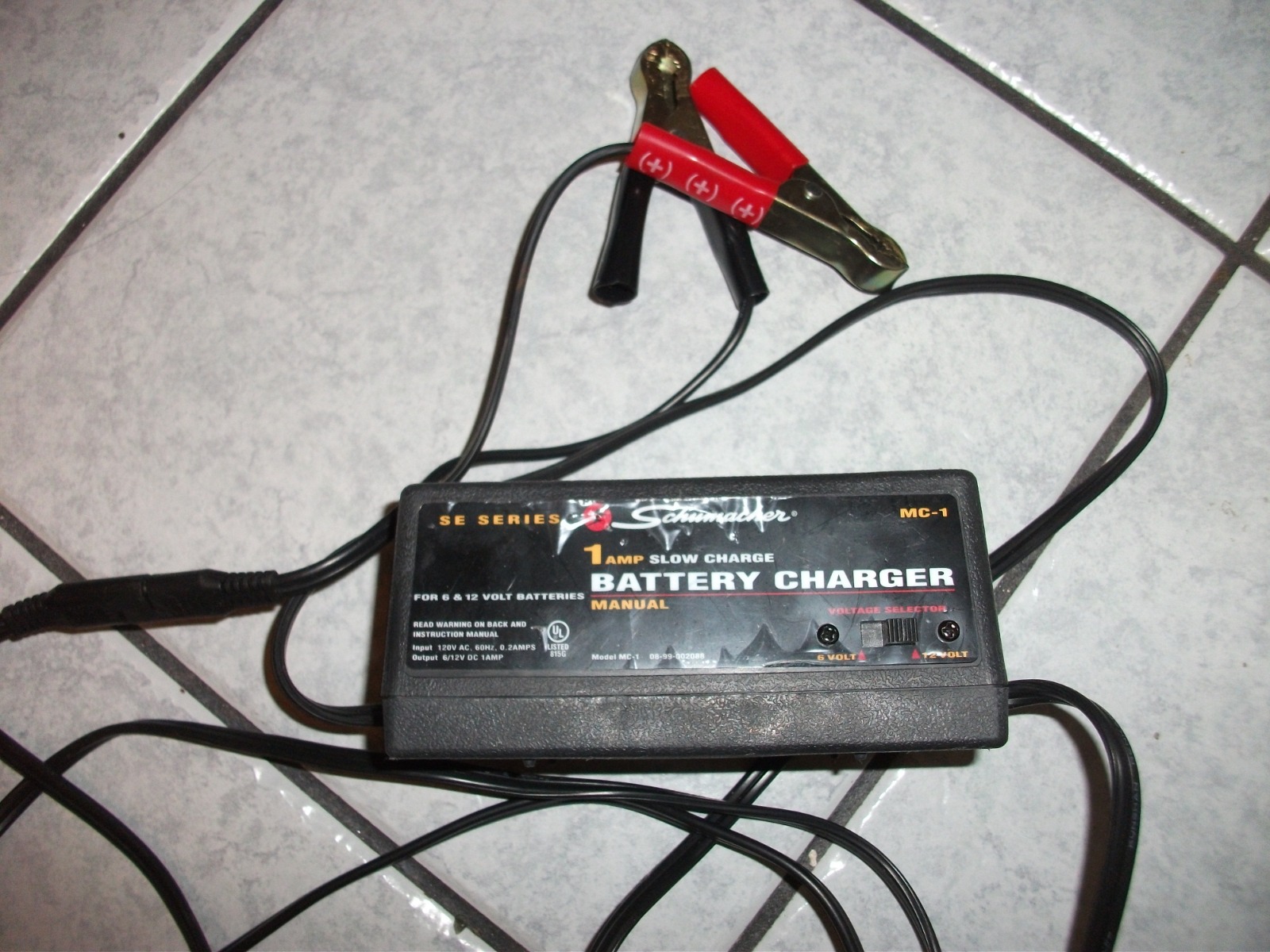

After looking for a old school battery charger I couldn’t find one.I hooked my battery charger to my deep cell battery and hooked it up to the tank.It worked well what I didn’t know is about flash rush.I did some research and luckily found out about a tank sealer red kote.Im wait on the sealer so after it comes in I’ll flush tank and apply it.hopefully it works.
Voyager xii
Kz 1000 st
Kz 1000 st
- Diocletian
- Posts: 13
Re: Repainted tank now won’t run 1979 kz1000 st
28 Sep 2020 12:41
When I used the battery I made sure it wasn’t heating up.
