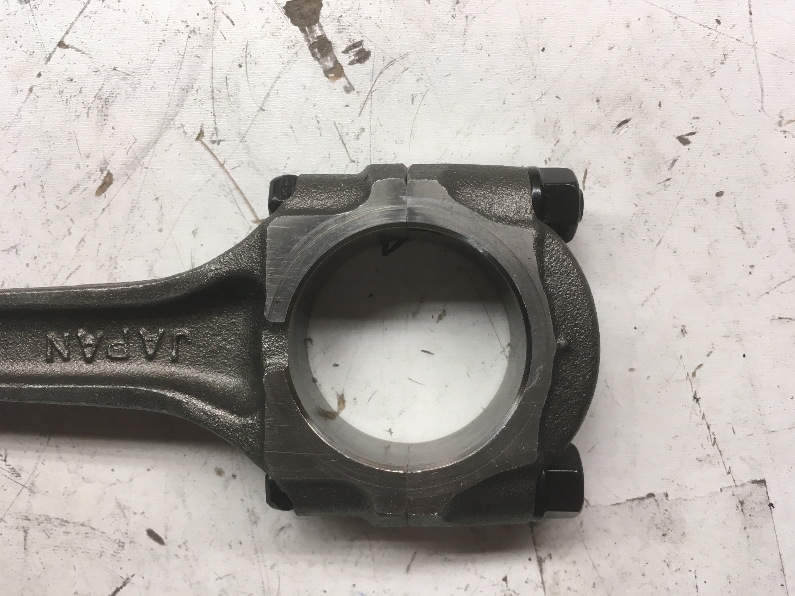

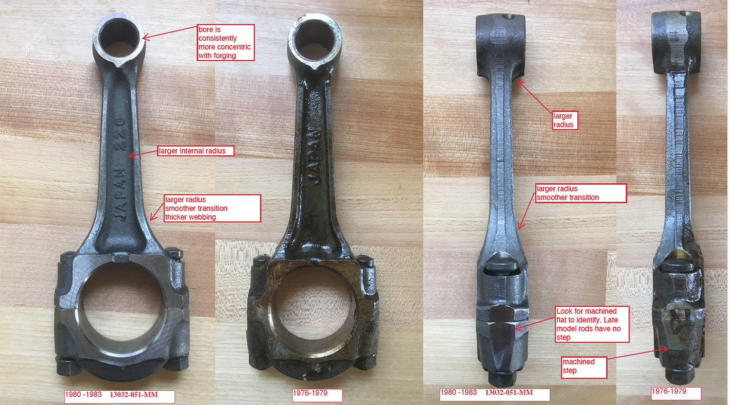

So I'm in a dilemma with project creep. I'm working on this big bore radical head package for a KZ750 twin. I expect about a 60-65% increase in power. From about 47-50 at the wheel to 75-80 at the wheel. I'm worried that the factory connecting rods are not up to the task. The later style 750t rods look to be much stronger than the early style but I cannot find any NOS late style rods. As far as I see it, I have three options. 1. use NOS early style rods. 2. find someone to recondition late style rods(recommendations?). 3. get custom rods. I have been looking at the kz1000 stuff as a measuring stick for what I'm doing. What kind of power increase can the stock kz1000 rods handle? 70% increase? Do you think the stock early style kz750 rods can handle 80HP? Custom rods are quite expensive ($1000+) and I cannot decide if its worth it. But i also don't want to scrap thousands of dollars when one of these stock rods decides to create additional crank case venting. thoughts?
TLDR:
Can stock kz750 twin rods handle 80HP? should I get custom rods?
TLDR:

I think RPM may be a bigger factor than hp. As long as you aren't going to spin the engine super fast I think those stock rods should be okay. Maybe go with the late style and have them polished and shot peened? And can you fit them with high grade bolts?

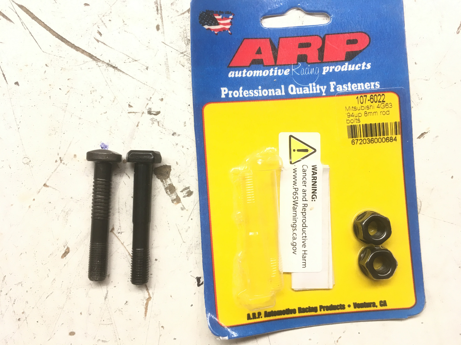

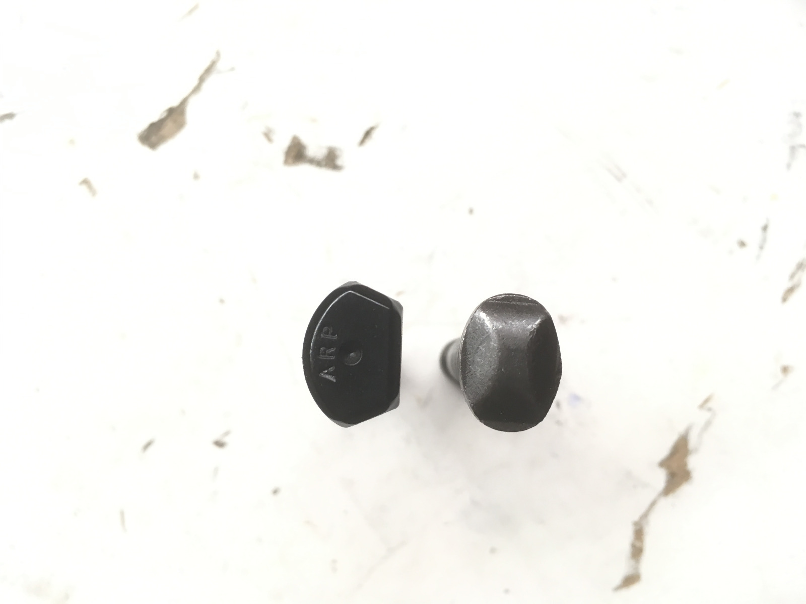

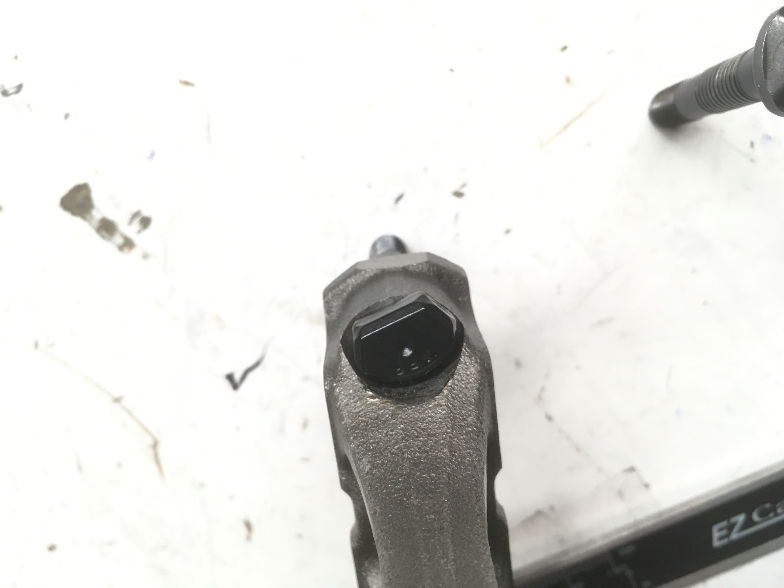

If the KZ1000 rods are good for a 300% power increase I think its safe to assume that the stock 750 rods can handle 150-180%. I will have them shot peened and resized - I was told that shot peening can release stress which can make the rod go oval or twist so they 100% need to be checked after. Does anyone know any reputable shops to recondition rods? APE told me to piss up a rope, and i haven't found anyone locally that is willing to do it. It seems aftermarket con rods have gotten so cheap very few shops are reconditioning OEM.
I was planning on having the whole rotating assembly balanced by a local guy who specializes in that type of work. But before i can get to that I need to have the con rods sorted out. I found some connecting rod bolts form a Mitsubishi Evo that are pretty much the same dimensions but the bolt head is a different shape so the head twists when torqued down, thoughts on using these bolts?
