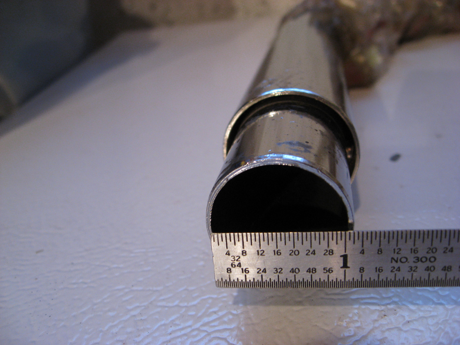

Re: Removing bluing on header pipes?
09 Jul 2020 15:19
Step 1. Find out why the pipes suffered excessive heat and turned blue.
Step 2. Correct that problem.
Step 3. Replate or replace the pipes.
Chrome plating is extremely thin! Decorative plating, such as exhaust pipes, is usually 0.000005" - 0.00001" thick. That is really a thin plating, so trying to polish its surface doesn't work particularly well. If the pipes on your bike were the originals they were dual wall. The inner pipe gets crazy hot while the outer pipe still gets hot enough to melt your skin but it should not turn blue unless something is wrong and the engine is running too hot. So before replating or replacing your pipes nail down the reason for the excessive heat or you will quickly damage the new pipes.
Here's a picture of the bottom end of a stock KZ650 exhaust pipe. Notice it is a pipe inside a pipe. Ed
