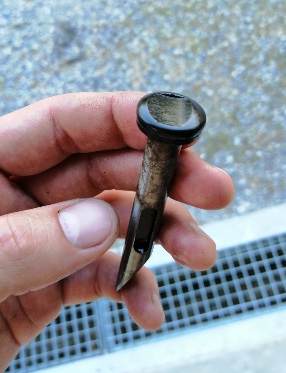

30 Jun 2020 11:08 - 30 Jun 2020 11:09For sure I have found one problem, I'm going to replace this part of the tensioner due to the condition.martin_csr wrote: Yes, that appears to be the cross-wedge type found on many 80s models.
Remove the cap then pull out the wedge & spring. clean & lubricate, then reinstall.
I use Permatex Ultra disk brake caliper grease in the little packets.
Do not ignore the valve clearance check, especially if the motorcycle has very many miles. but regardless of the miles, it should be done so that you know for sure.
Maybe it can be the mainly cause of noise due to the fact it can't push well the chain.
