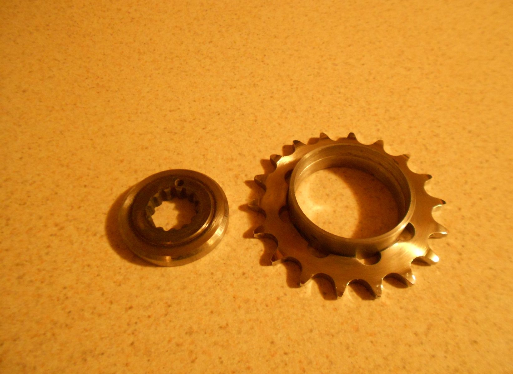

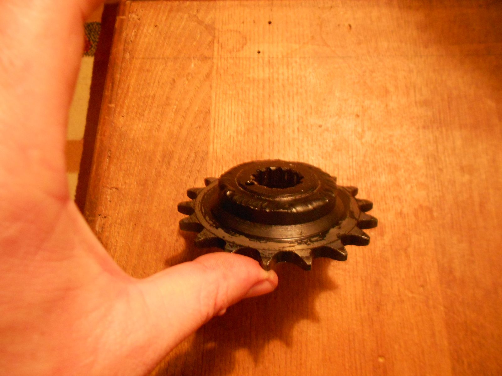

19 May 2020 01:02 - 19 May 2020 01:06
Here some Pics of the draft
