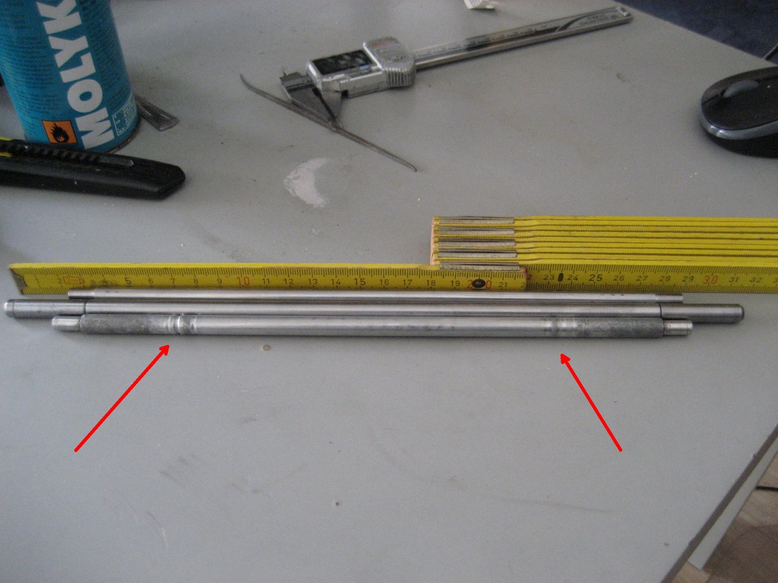

I had to made a new high cabon stainless steal clutch push rod where the seal lip bite a groove into the stock aluminum rod.
