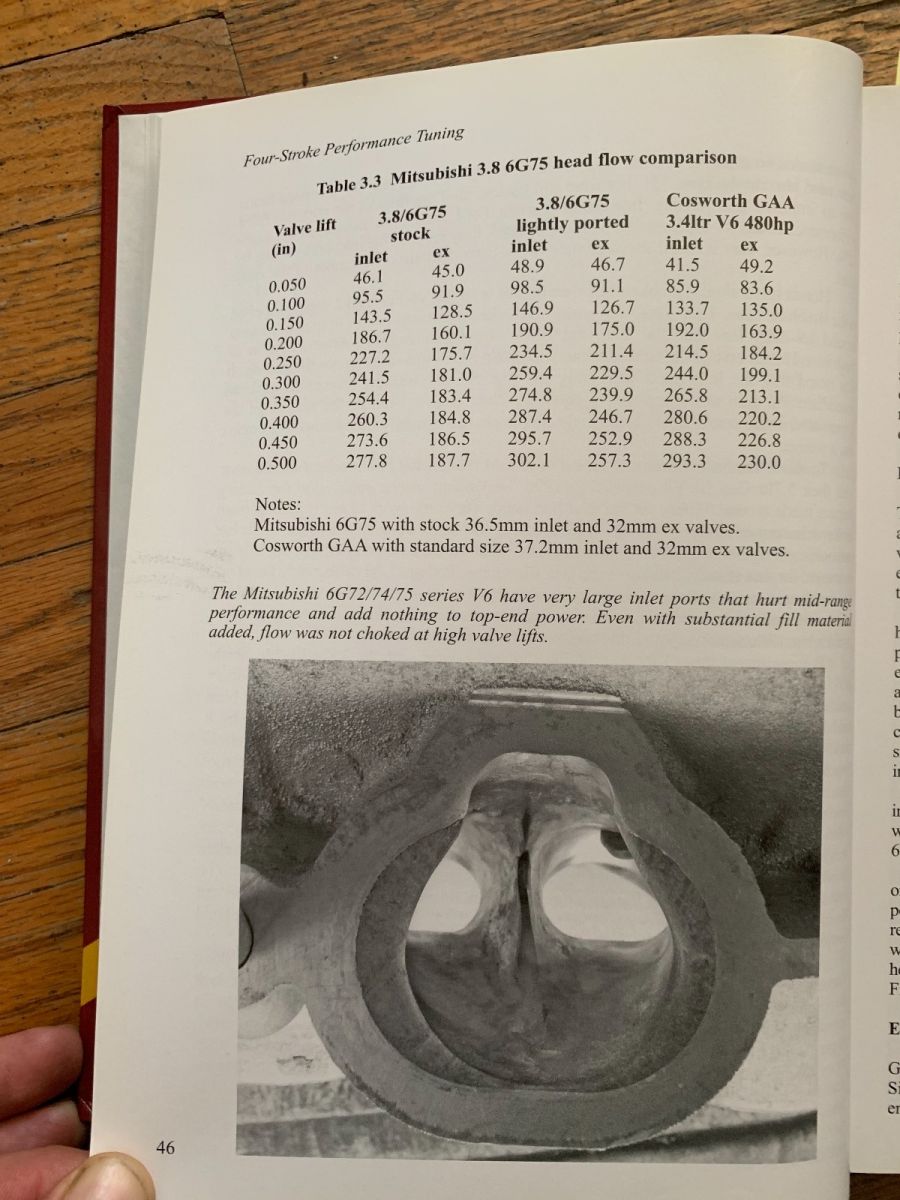

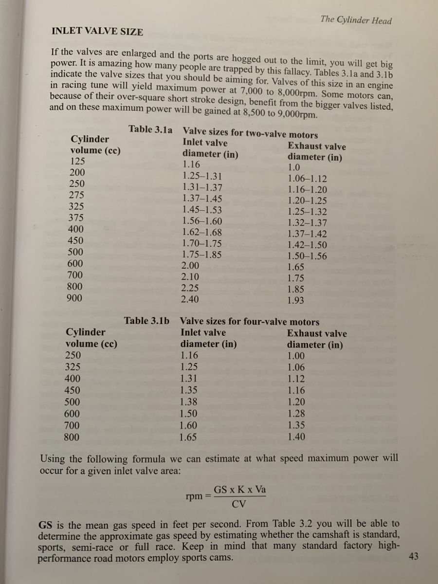

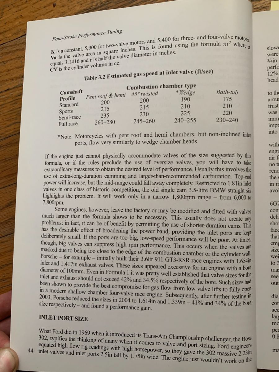

What are the 650 and 750 valve sizes? I suspect that they are already too big for the 750, and possibly the exhaust valve is too big in relation to the intake, so going to a larger displacement will make the valve size more proportional for street use. Here’s an excerpt from “Four stroke performance tuning”
Look up Schumann Motor Works for all your custom valve train needs....

DoctoRot wrote: What are the 650 and 750 valve sizes? I suspect that they are already too big for the 750, and possibly the exhaust valve is too big in relation to the intake, so going to a larger displacement will make the valve size more proportional for street use. Here’s an excerpt from “Four stroke performance tuning”
Amazing!!! Gee I love this forum for exactly this kind of knowledge sharing!!
I ended up finding an online valve size calculator , and you're seemingly correct in your thinking. The calculator suggested 33.5mm intake and 28.5mm exhaust valves for an 810cc motor (Bore 69mm, Stroke 54mm, Max rpm 10k).
Factory sizes: KZ650 | KZ750
Intake Valve: 33mm | 34mm
Exhaust Valve: 28mm | 30mm
Makes you think, based on that last screenshot from DoctoRot, an 810 kit might be best using a 650 head for its 30mm exhaust valves, but then with oversized 34mm intake valves from the 750 head.

In theory using the 650 head with a 750 intake valve works best for a 810 kit. however these are just theories and real world results can differ. It also depends on your application, if you want a torquey street machine then the smaller valves will be better, if you want a screaming race weapon the bigger valves are probably preferable. However valves are only one part of the equation. port size, volume, and cam will play a roll as well. better flowing carbs will help big time. I suspect that like many Japanese manufactures of this time period they ended up looking for a high overall HP number for marketing purposes rather than real world driveablilty. think GSXR 1100 vs bandit 1200.
What I found when I started developing the big bore kit for my kz750 twin was that the stock valves were oversized for 750cc, and a poor ratio (too big exhaust), the ports were too big, but a good volume. By adding 150cc displacement, and 1mm bigger on the intake valve. Now the valve sizes are more ideal. I kept the same port sizes but quite a bit of porting was necessary to get the port volume corrected.
