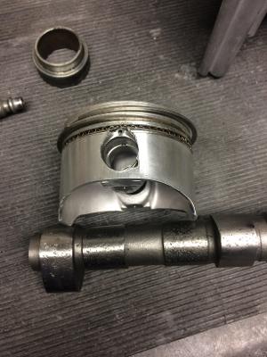

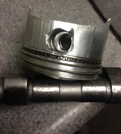

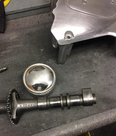

I need 1 piston. Other 3 are like new. This Numbskull who used the RTV, he put this piston kit together too!!!???? Wiseco's he F kd up the cir-clips and oil ring. He told me it had a bent valve. Not. Had 2 vertical gouges in the bore. Now to salvage, Bore 1 liner for a new piston. $120 for 1. Thanks.

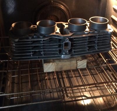

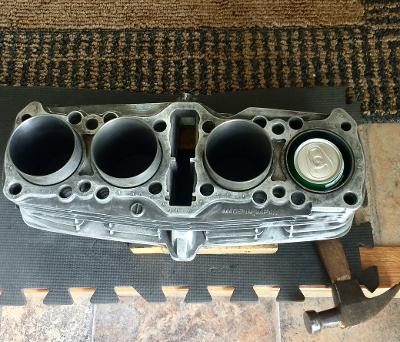

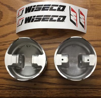

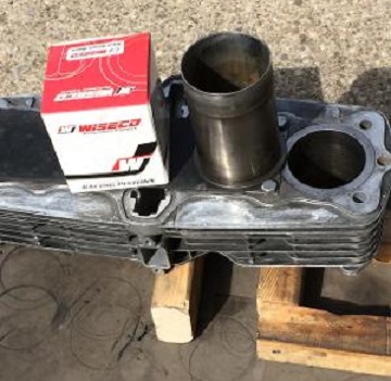

Got a new wiseco, Jay in Florida. Distributor for 3 Business's. Wholesale price. He even had some old teflon buttons for the 1075 .234". I'll use buttons. Have to machine wrist pin down .030" Wiseco changed the pin bore oiling. No holes. Something about side oiling with chamfered areas? Popped a new liner in block, have it bored. Back to new.

The old Lady went to work at 8:00 am. I turn oven on at 8:01. Then bake block, oil sweats out smells, windows open exhaust fan on. Only smells for a little bit. She never knew! :laugh: :laugh: BackYard Engineering at it's best! That is a frozen can of soda in the bore. Helps cool steel liner in hot block.
