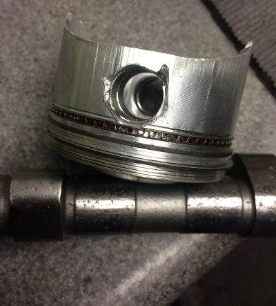

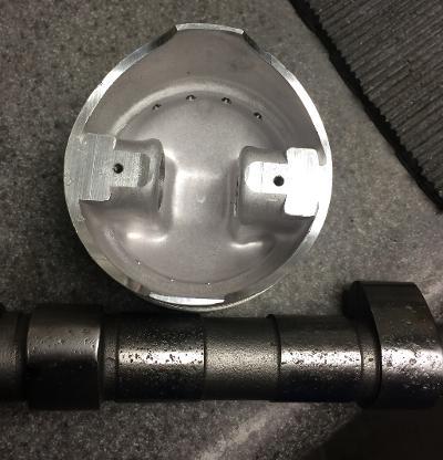

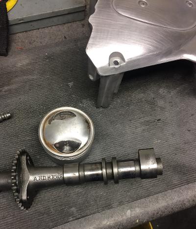

In need of a stock OEM 1015cc, 70mm cylinder sleeve. I had help from a current member last year, sorry that I have forgot who? I did not find in search history? Bad bore is OK, as I need to bore it to 72mm, 1075cc. I got burned by the barn job guy with the copper RTV. As I bought a bunch of parts and a motorcycle from. And he don't even know? This guy barn jobbed a new set of wiseco's. One of the pistons, cir-clips let go with the bottom oil ring opening, right at the wrist pin bore?? Ruined the piston and bore! 2 vertical gouges in the bore. To ad insult to the bad! The Andrews 2X cams were all pitted from sitting?? Or he used them like this?? The numbskull turned $500 on eBay sales into 0$ dollars! At least I can buy 1 72mm piston and bore 1 cylinder to get a nice 1075cc, 10 1/2:1 block out of it for about $150 investment. Got to take the bad with the good?
He was naive about it?? He said it had a bent valve! Ya no compression from 2 gouges in the cylinder!

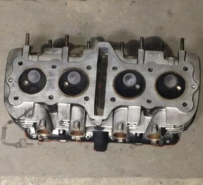

I did find a diamond in the rough! There is a 73 Z1 only, (no shift pattern) sprocket cover that buffed up excellent. Plus the head is very nice, nothing broke or stripped.

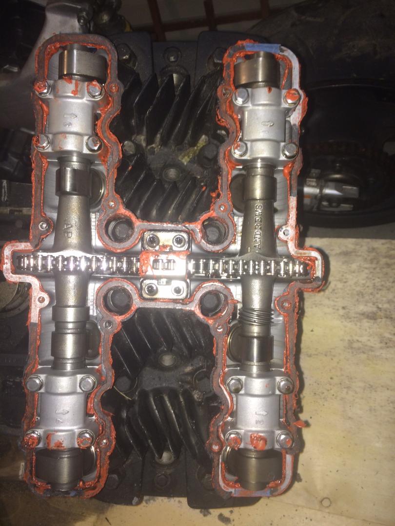

That valve cover gasket is disgusting! I'm pretty sure if you use no gasket (I am not recommending this, just an observation) and just rtv you don't use that much.

Ye, of course. I had nothing to do with this build! I bought it like this! He should be glad that he did not run longer. It would have burnt out the whole top end. There was RTV clogging the 2 oiling studs. Whatever? At least I have a complete short block to start with again!
