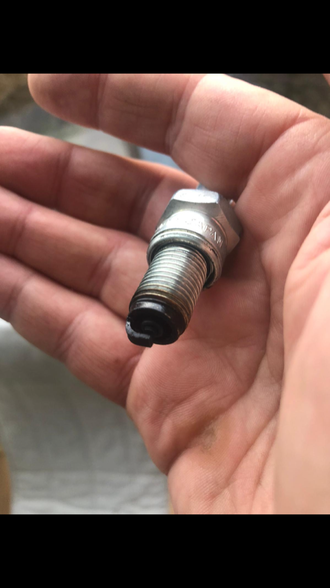

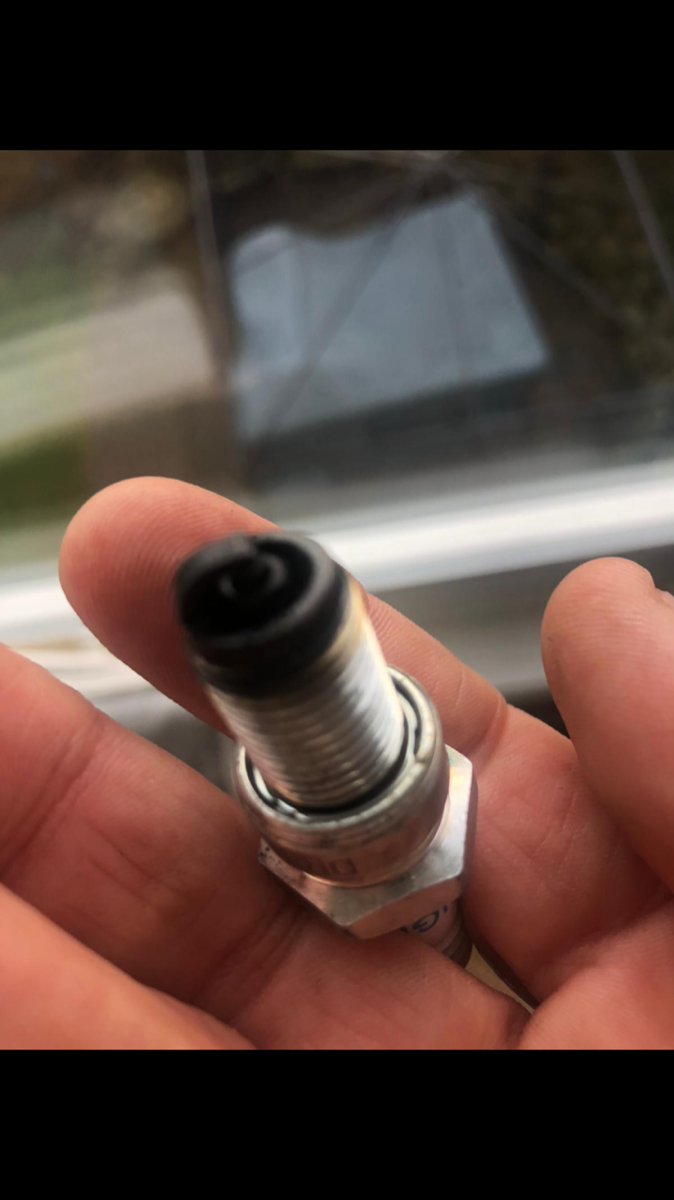

Spark plug oil?
- gordone
- Posts: 1538
- Thanks: 93
Spark plug oil?
08 Mar 2020 03:09
Project:
Project:
- Posts: 8205
- Thanks: 3577
Re: Spark plug oil?
08 Mar 2020 06:09
Looks more like rich carburation.
Is the engine consuming oil? How many mpg do you get when ridding?
- gordone
- Posts: 1538
- Thanks: 93
Re: Spark plug oil?
08 Mar 2020 07:31Nessism wrote: Looks more like rich carburation.
Thank you.
Its a friend of mine, will ask him.
He says he need to replace spark plug all the time because the sylinder 2 stop firinc because of these.
Project:
Project:
- zed1015
- Posts: 3362
- Thanks: 2072
Re: Spark plug oil?
08 Mar 2020 08:47 - 08 Mar 2020 08:51
Could be oil fouling from a faulty valve guide seal.
The usual symptom is the plug fouling when the bike has been stood overnight which allows enough time for oil to seep into the cylinder.
Once a fresh or cleaned plug is fitted and the bike started the oil in the cyl is burned off and is usually ok for the rest of the day until left to stand again.
Smoke from the exhaust on acceleration after deceleration (which creates a momentary partial vacuum in the cylinder and draws oil down the guide and then burns it ) would back this up.
Last edit: 08 Mar 2020 08:51 by zed1015.
- gordone
- Posts: 1538
- Thanks: 93
Re: Spark plug oil?
08 Mar 2020 09:28zed1015 wrote: Could be oil fouling from a faulty valve guide seal.
These is exatct symtoms he has experience!
Project:
Project:
- gordone
- Posts: 1538
- Thanks: 93
Re: Spark plug oil?
08 Mar 2020 13:36
He have not control over the oil consumtion...
He plan todo a compression test to compare the cylinders, if the are close to identical his planis to replace the valve seal...
