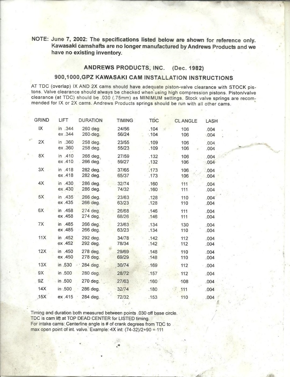

I remember reading with the 3X cams and larger the head and valve cover has to be relieved to allow the higher lift cams to rotate.
