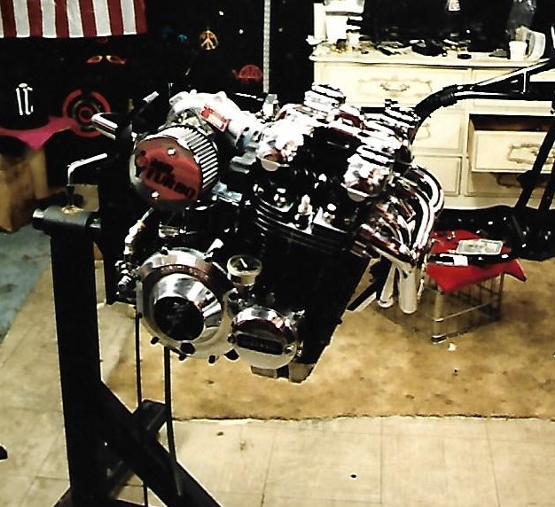

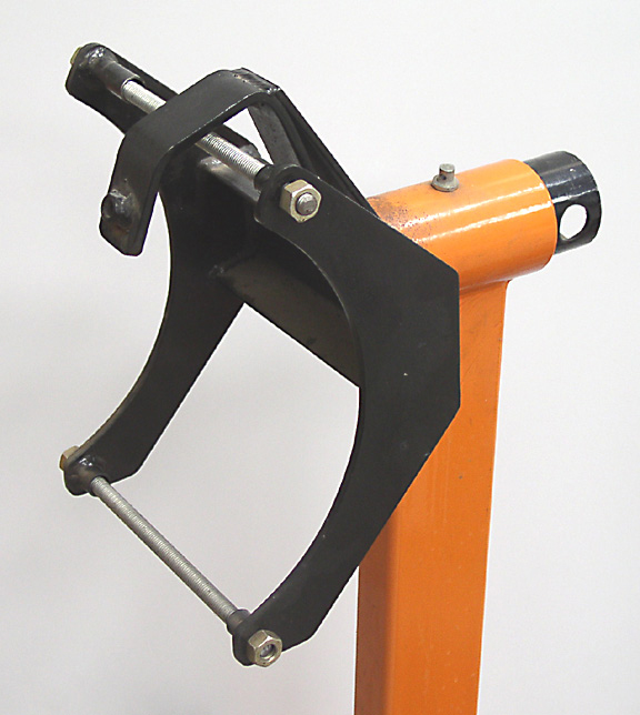

Found this in a forum search... Does anyone know if this is a manufactured item or home made... I'd really like to have something like it...

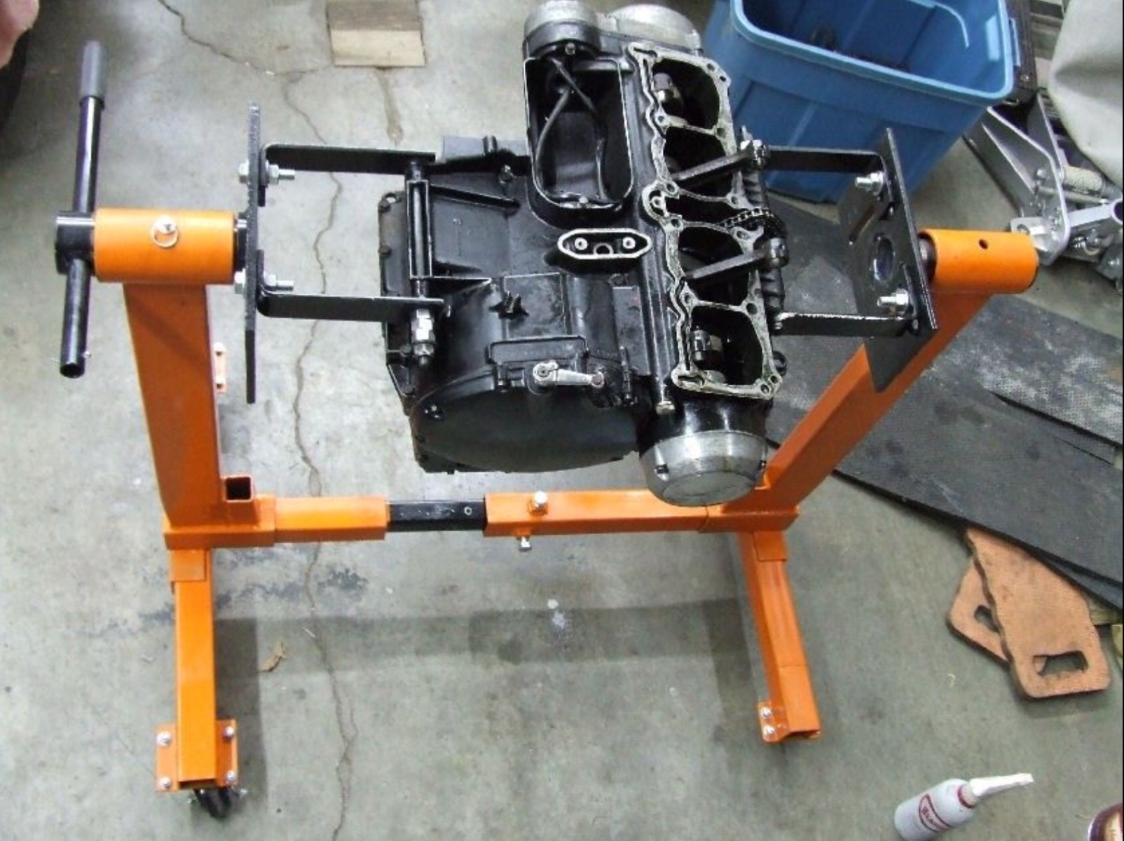

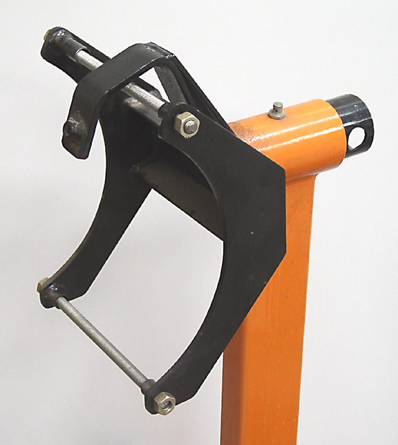

We've never seen the stand pictured in OP. However, our forum member <hardgun> posted a thread about motor stands he makes himself. We bought one and have been satisfied with it. We're in process of writing a review for the VJMC magazine of this stand, which will be published this year.
The original (necro) thread is here:
kzrider.com/forum/21-tools/609382-engine-stand#792020
PM <hardgun> for info & pricing. He's indicated he can customize within reason.

I must agree with what slmjim+Z1BEBE said. I had Hardgun make an engine stand and lift plate for me a couple of months ago and they were very well done. Which reminds me I have to get to painting them asap.

How well would a stand like that (original post) support the engine? I know those engine stands (the base unit/car stand) holds the v8s fine, but I feel like the style hardgun posted is better from a material/statics standpoint.

26 Jan 2020 12:13M_a_t_t wrote: How well would a stand like that (original post) support the engine? I know those engine stands (the base unit/car stand) holds the v8s fine, but I feel like the style hardgun posted is better from a material/statics standpoint.
They worked fine for me 40 years ago during my Turbo build

26 Jan 2020 17:59Mikaw wrote: Dave did you build yours?
I was planning to do something like this. I already purchased the 2 stands from HF. Cheap, I think on sale and with a coopin I only paid $60 or so. I’m going to contact Hardgun and see if he would be willing to build his stand that I could adapt the the engine stand. I just want something I can stand up and work on
The stand was a shared tool by my Kaw racing team
The engine stand main body was purchased , and the Kaw engine cradle was home made.
Very simple to use . It held all 4 rear corners of top and bottom chassis mounts.
It worked great and as you can see held the whole engine quite easily

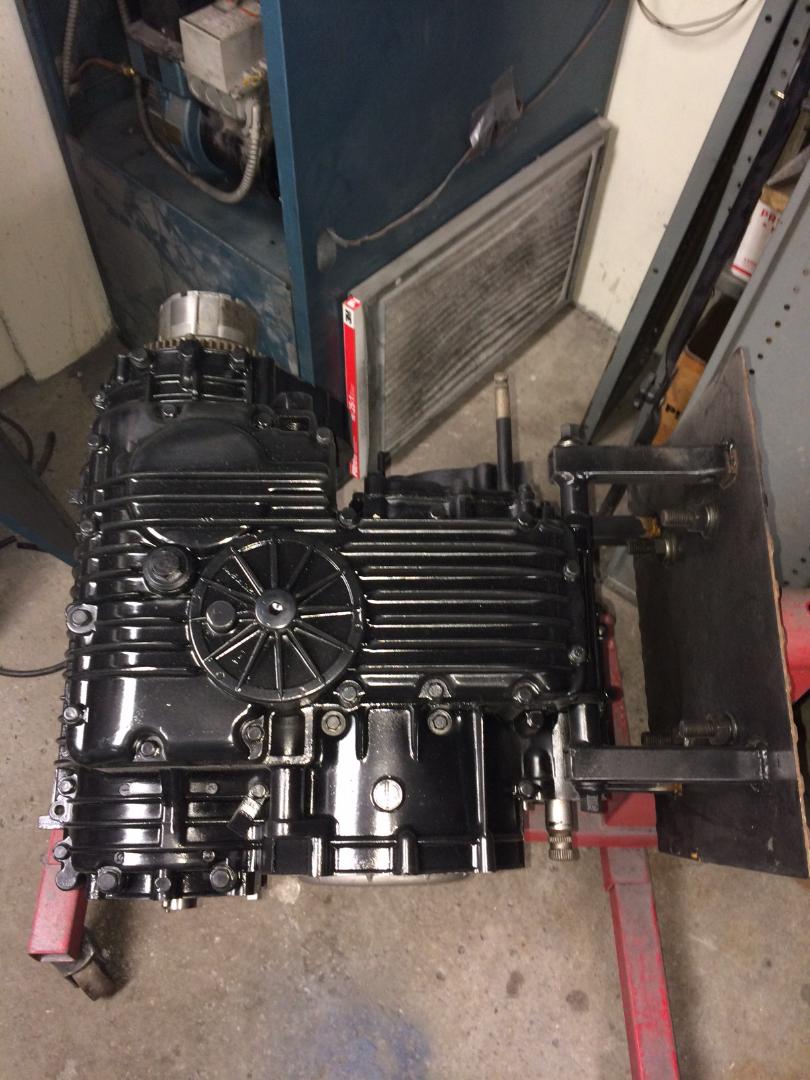

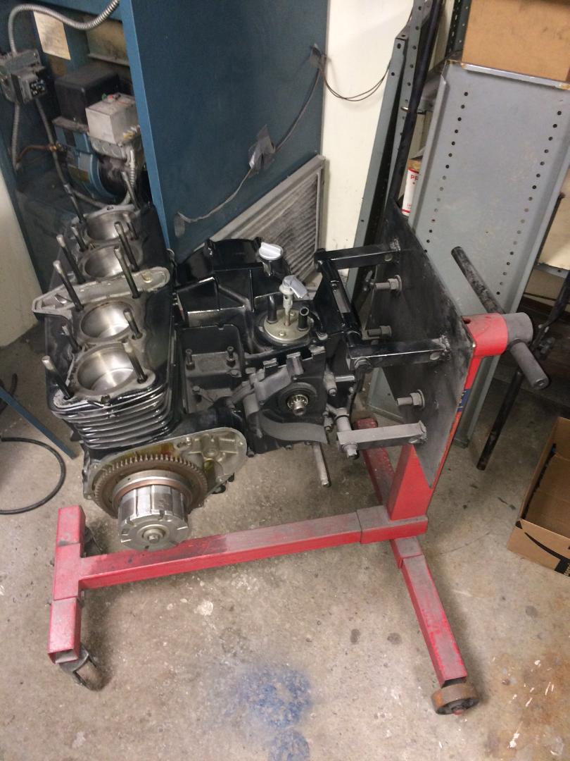

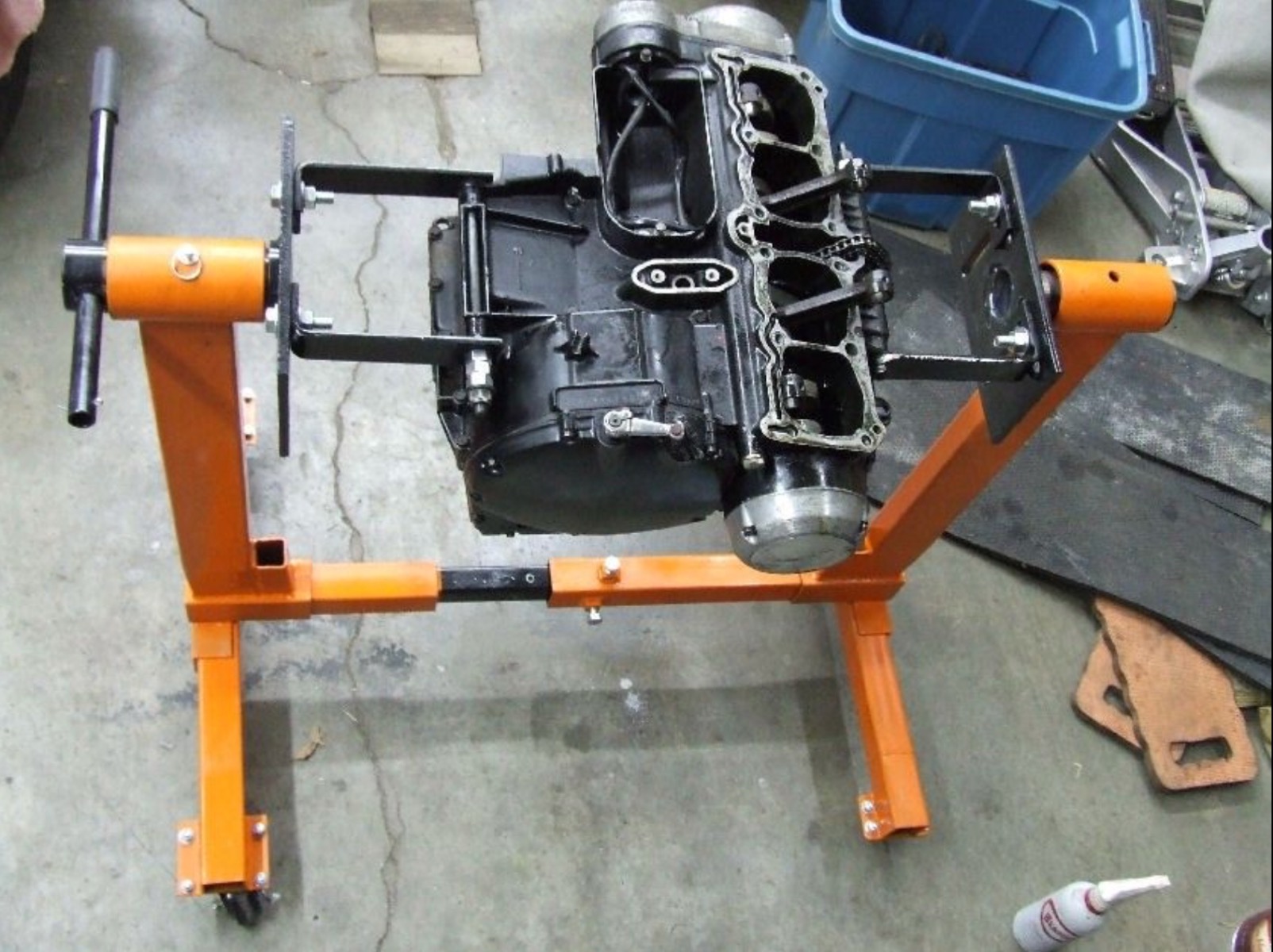

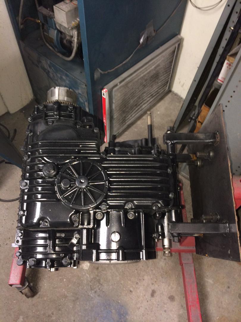

I whipped up one from an old car engine stand someone gave me 20 yrs. ago. I just welded some stuff to a flat plate of steel.
It rotates fine. Been in this fetal position for 6 yrs. now. I got depressed after It got overspray from a single stage urethane paint job I was doing 4-5 times for same bike. Yes it was covered in a hefty bag and sheets. But that paint has a way of creeping in on everything. So now it needs to be scuffed, cleaned and resprayed black. I have turned the engine over a lot with marvels oil coating the pistons and rings over the years.

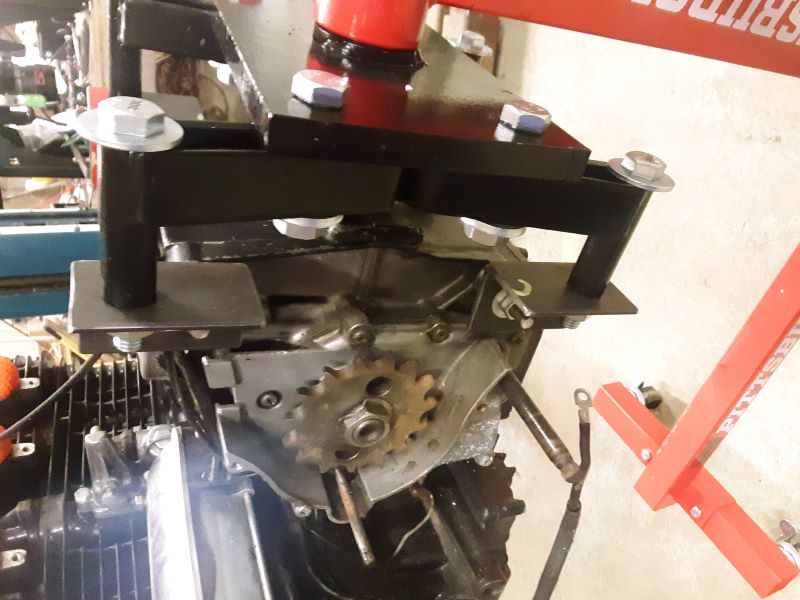

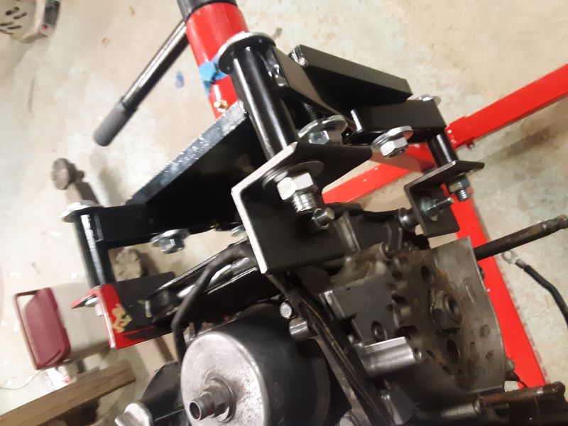

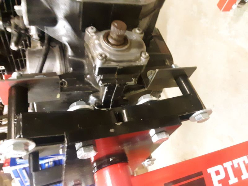

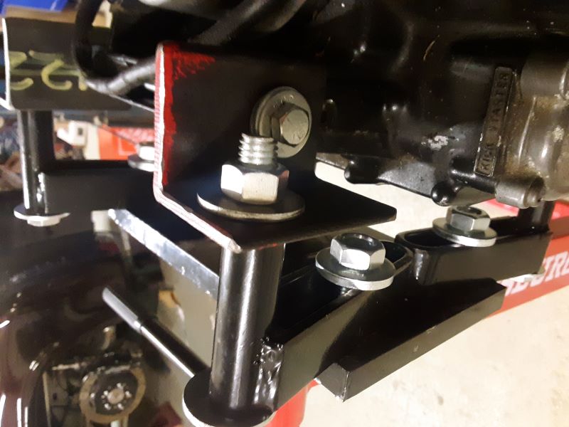

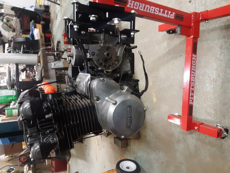

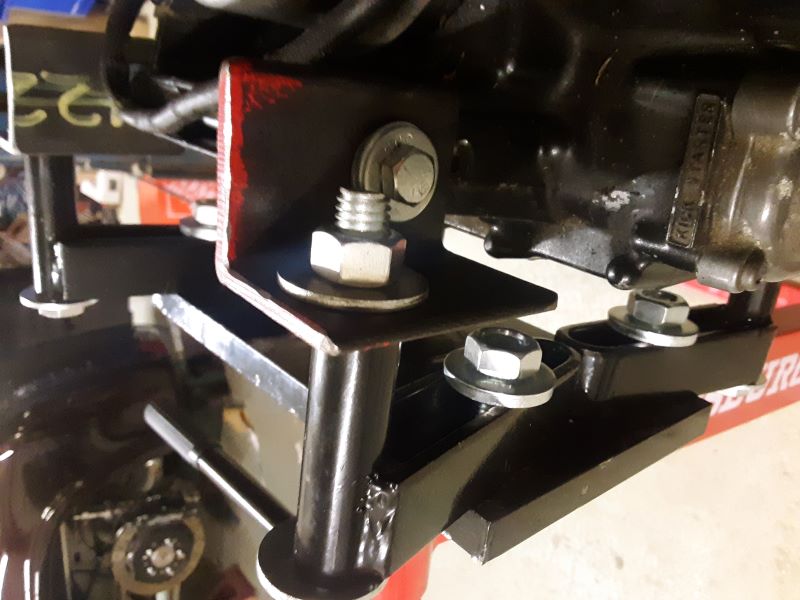

Recently came up with a simple mount arrangement for an engine stand. Used a (relatively) cheap harba frate stand and made some angle brackets from L2x2x3/16 angle, drilled holes on each leg. (there will be 2 LH and 2 RH patterns). Bolts thru engine mounts, 1 upper and 1 lower, are 3/8-16 (couldn't find 10mm bolts long enough at local hardware store). Cut a couple of spacers from 3/8 sc40 pipe. Had to buy bolts nuts and washers long enough to bolt thru the tubes of the mounting ears, too. Works pretty slick.
If (or when) I make another set, I'll cut the four pieces of L2x2 at 3 1/2 or 4 inches long to spread the tube mounts a little further apart on the plate. As it worked out this time it's a tight fit.
BTW, Summit sells a drip pan (SUM-G1016) that fits my harba frate stand, not in photos (seems both get similar stands from the same chinese supplier). Drip pan wasn't cheap but it's a perfect fit.
Nothing left to do now but see what's inside!
