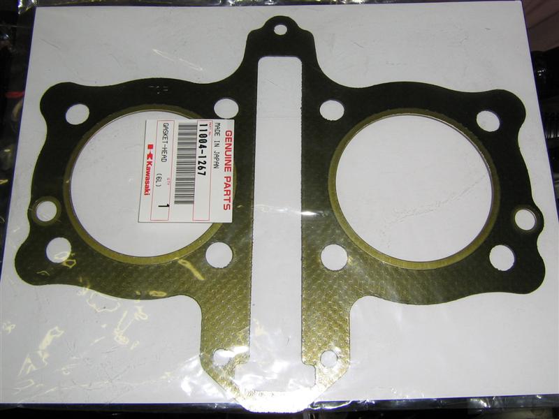

Get yourself the late model OEM head gasket. the green/brown one. the early black and red ones are terrible .

I did, 11004-1055 part number if you look at the gasket straight on its browm, but if you tilt, its green, I struggled at first between buying after market gaskets or getting 20-40 year old new oem gaskets still in the original packaging , firm believer in oem .just wasn't sure about the age. Anyway, at some point you just have to make a choice and go with it. The headgasket that is currently on the bike now is definitely "toasted"

This is the real green OEM head gasket DoctoRot is talking about.
www.z750twin.de/zylinderkopfdichtung.htm

unobtainable,cant find that gasket on ebay, many vendors passing 11004-1055 as the 11004-1267 but their not the authentic version, some place in the Netherlands ,or Sweden ,gernany claimed to have them but the color was totally brown. the name of the company was csml or something like that.

I have had both the green and the brown. I settled for the brown because i couldn't find the green one the second time. the brown version is as nearly as good as the green, very similar construction. No leaks for me with the brown. Just stay away from the red/black one.
