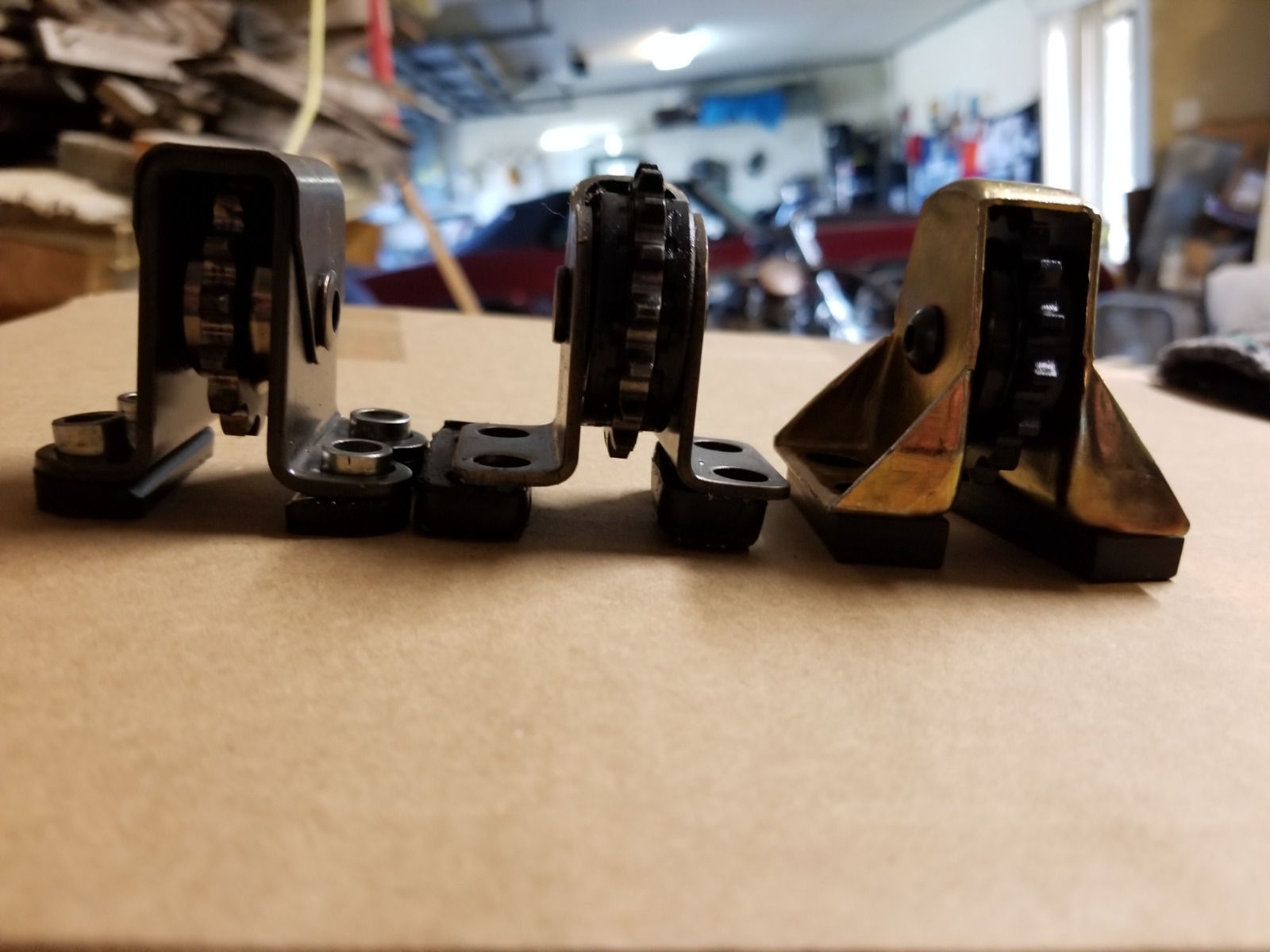

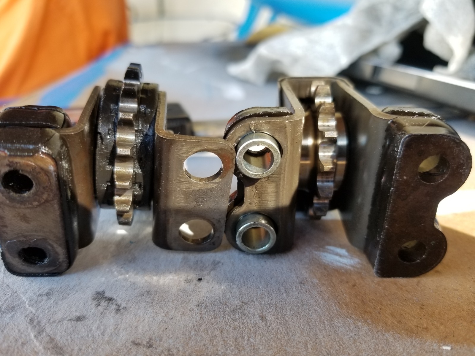

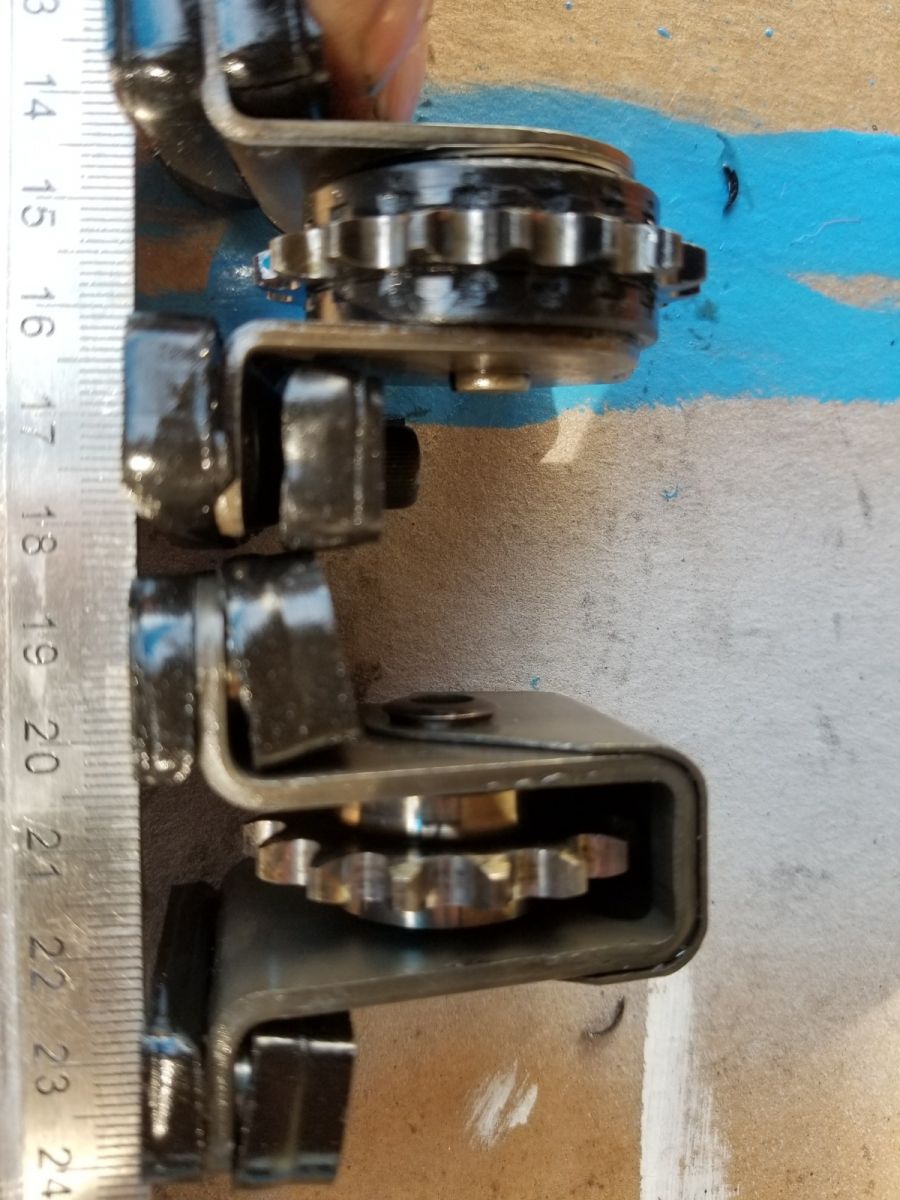

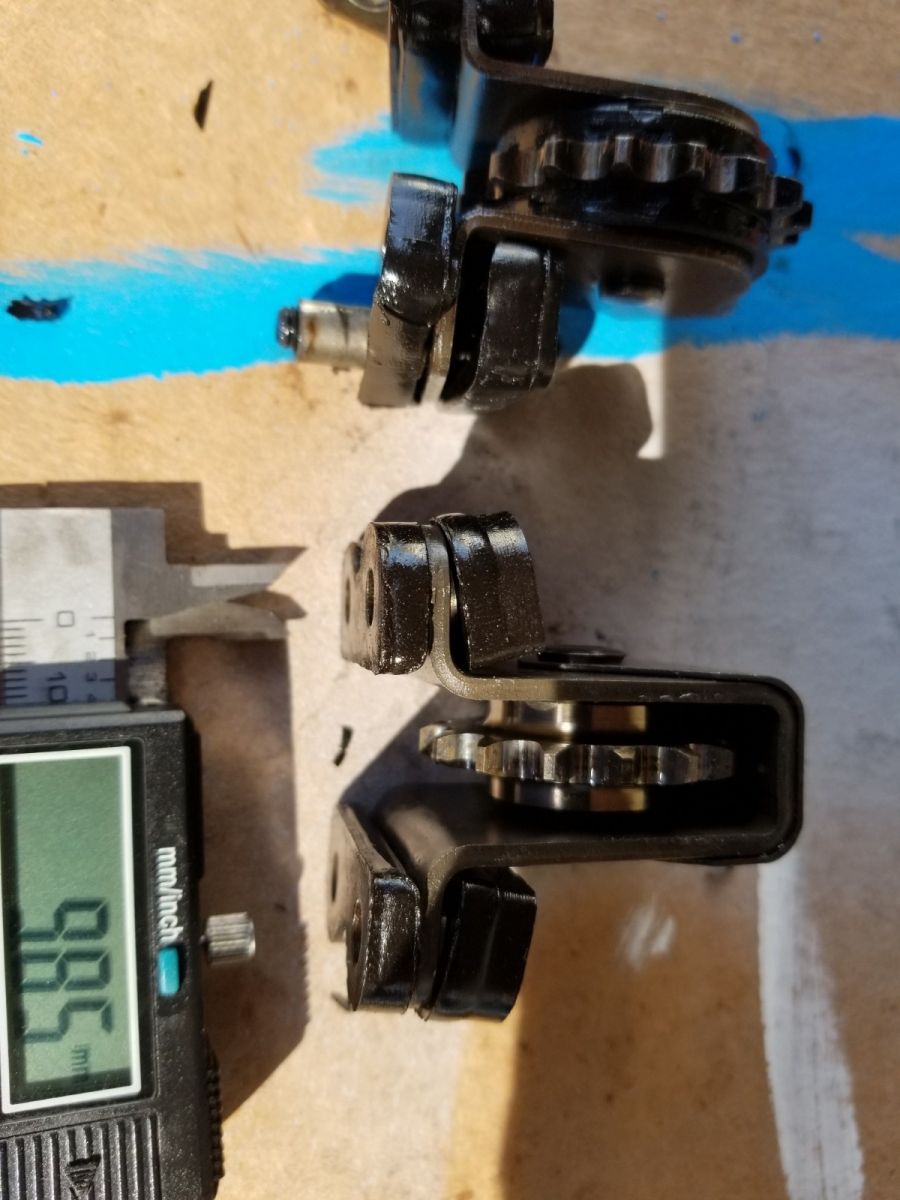

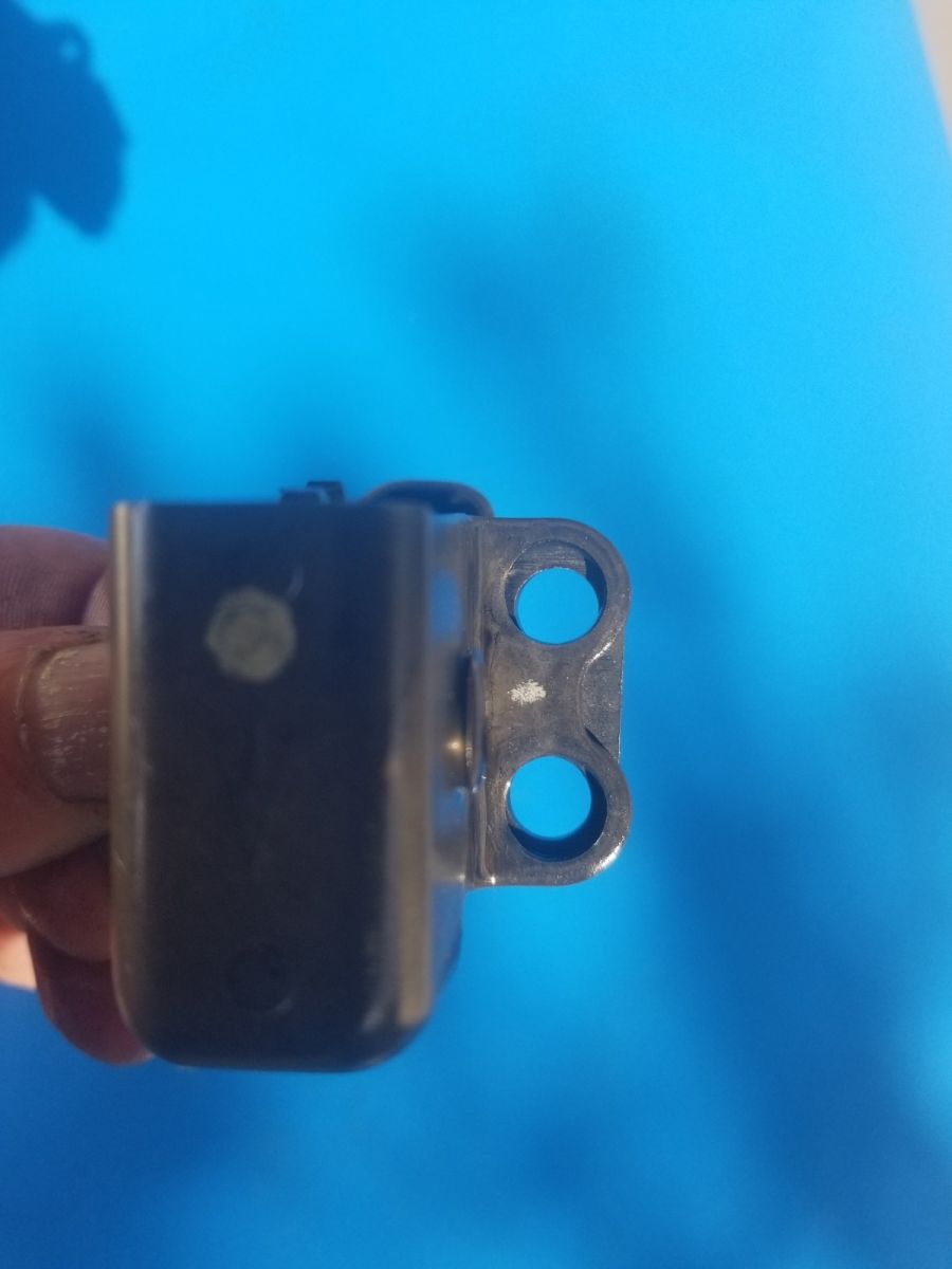

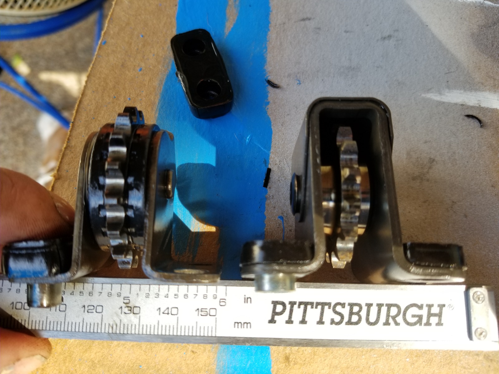

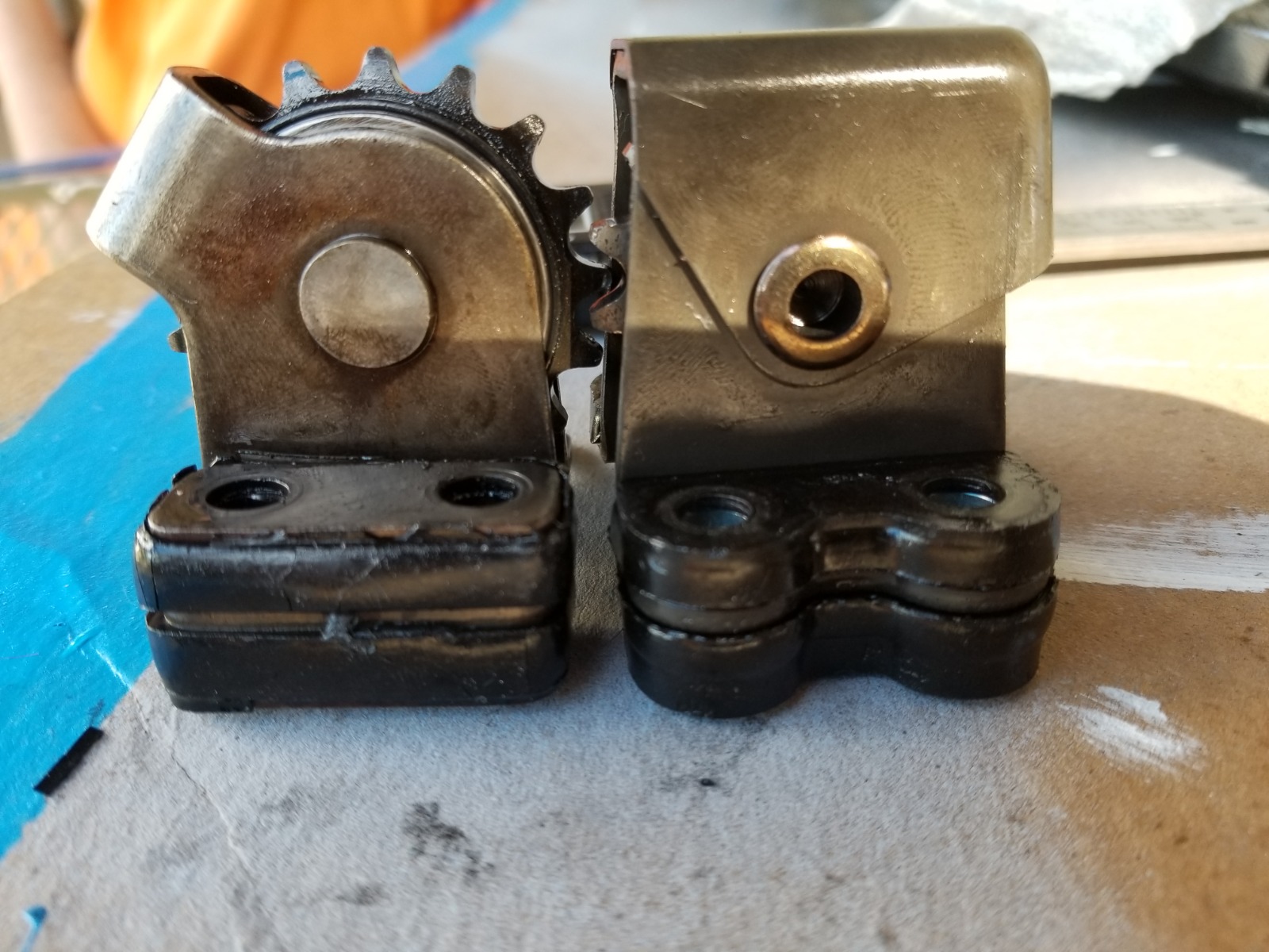

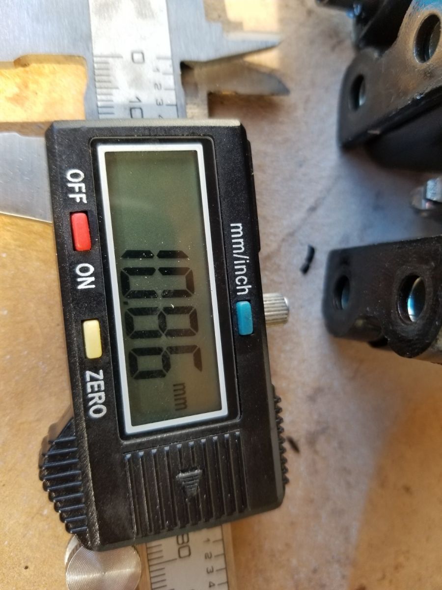

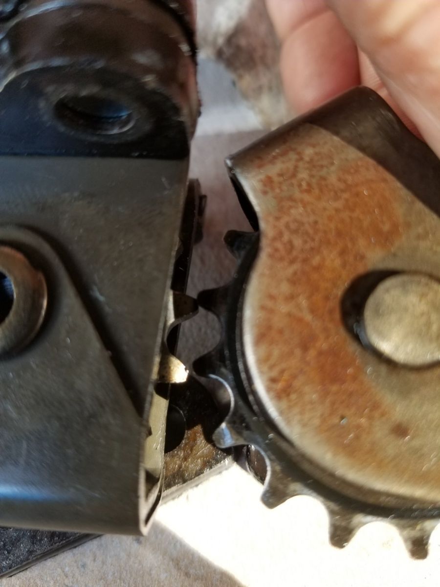

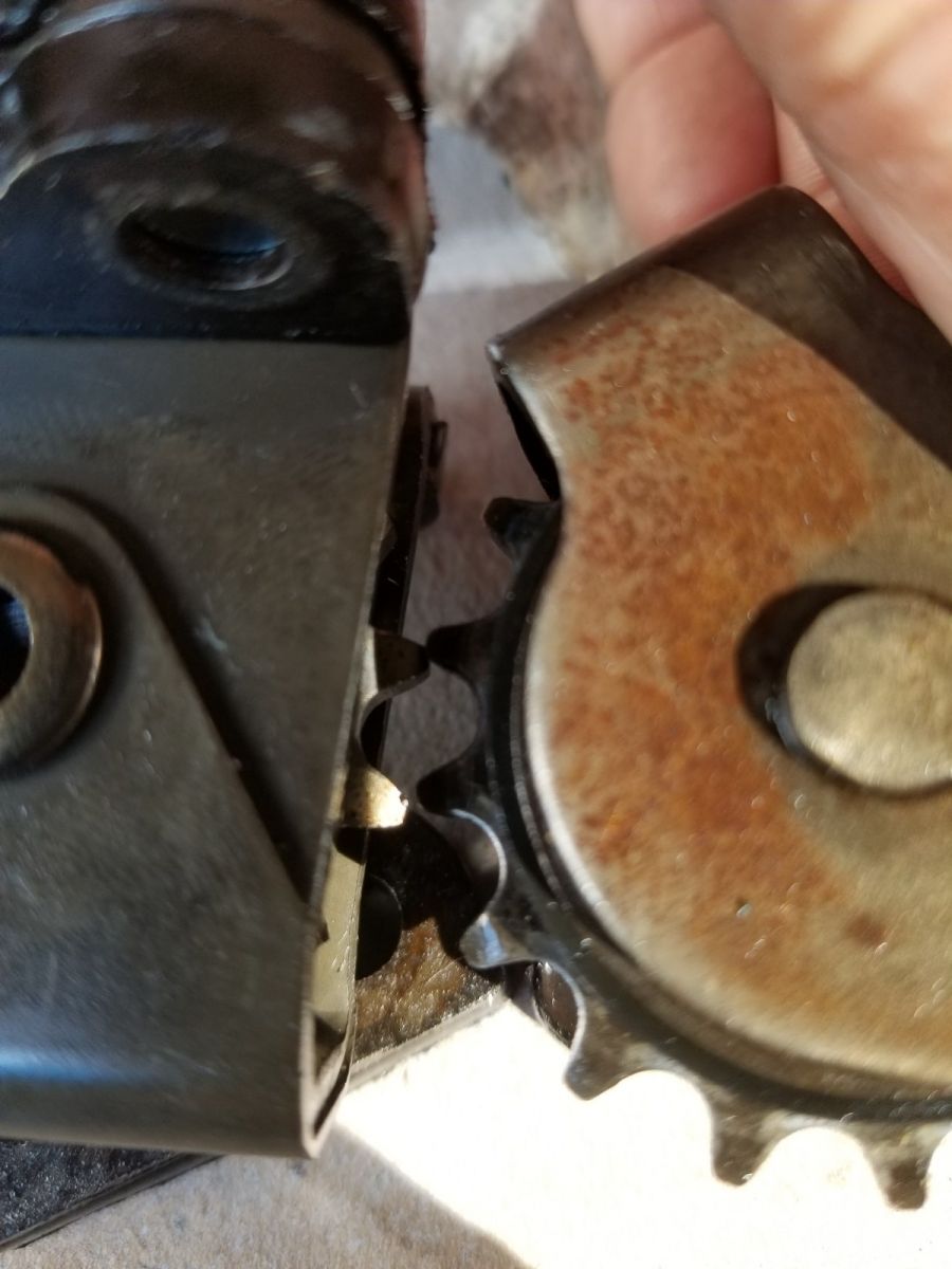

Ok I just received the Suzuki katana idler and I'm comparing them.
They look very similar. The height is pretty close and will fit under the cover.
The bolt holes are very close, will probably need to be reamed inward a bit .
T he rubber pads are a better quality and should work even with a kz idler.
Now here are the differences, the gear is larger on the kz idler but the teeth are the same.
The height is front the bottom to the gear is higher on the Suzuki idler but swapping the pads top to bottom drop it down just a bit lower than the kz idler.
Using the kz idler bolt top plate as a spacer will bring it to the correct height .
For you engine / machinest people out there if you think I should measure anything else let me know.
Last edit: 12 Jan 2020 10:44 by Bulletkz.

I ended up spending the dough and buying the liska and spacers.
The Suzuki one does look like the best quality though.
Anyone else want to try it, give me my $20.00 back and you can have it.
