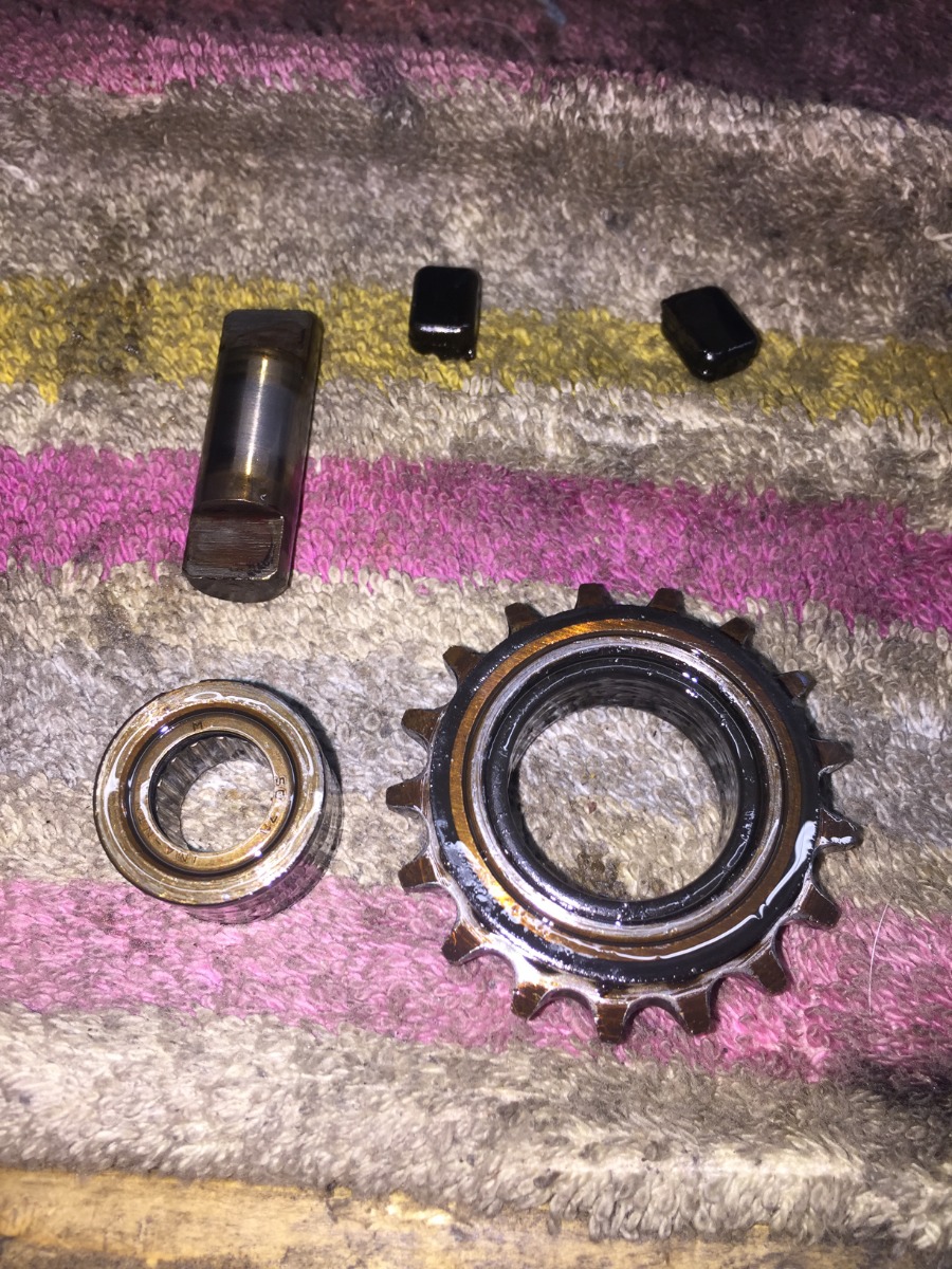

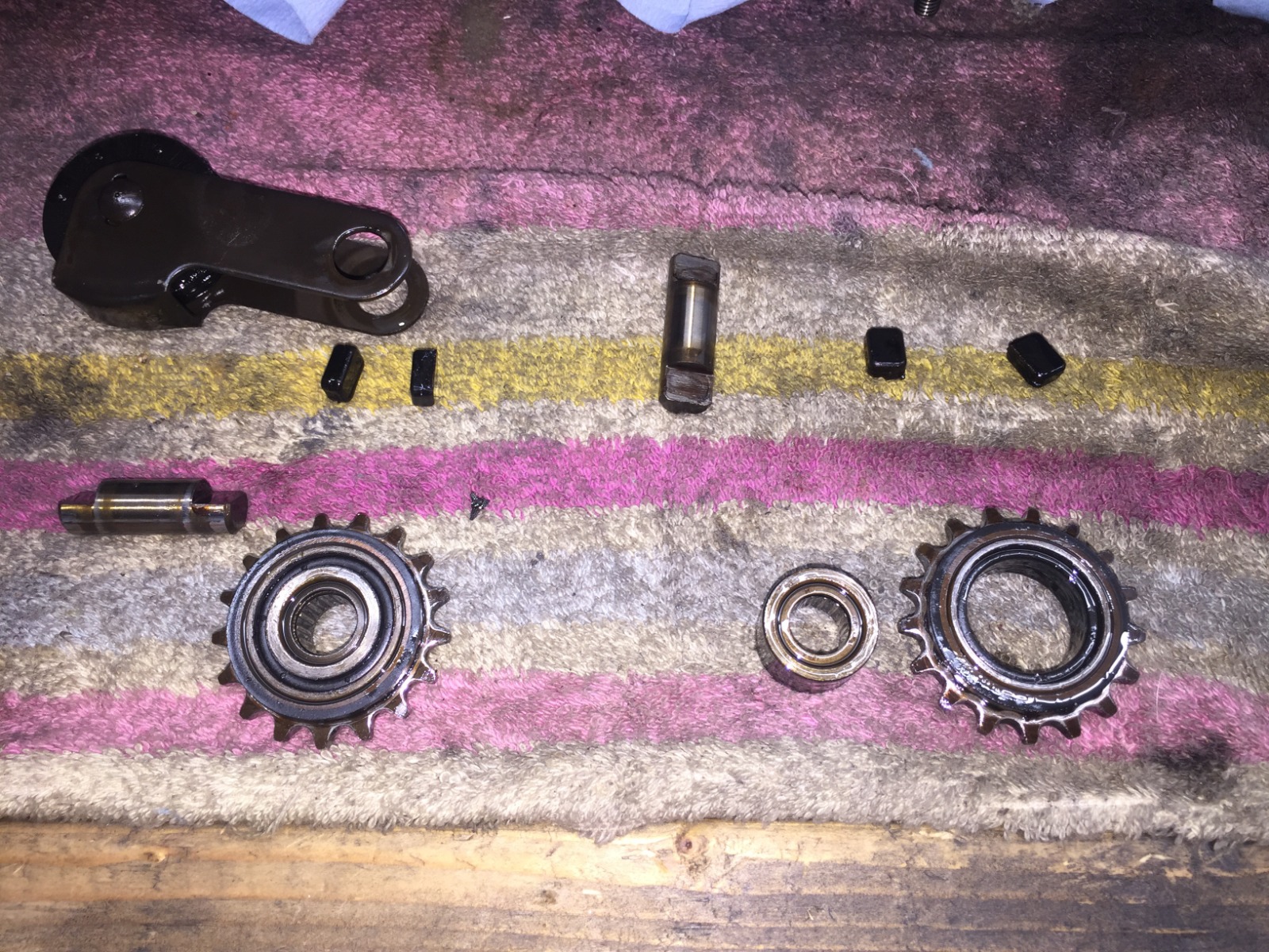

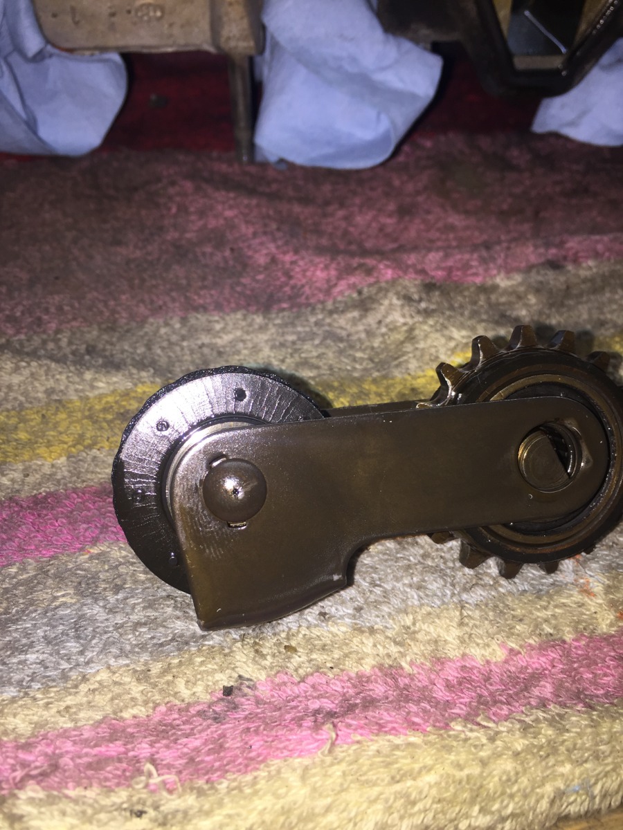

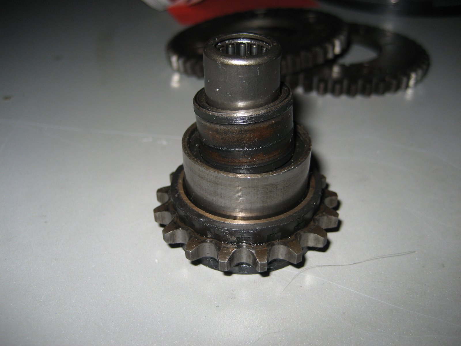

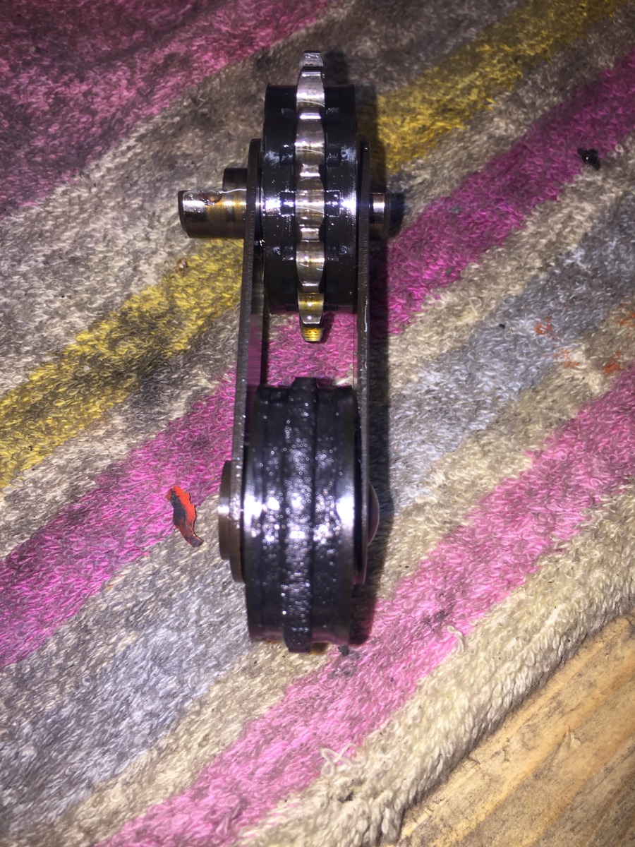

I had a whine in my engine that I thought was the top idler. So I purchased a new one (OEM) and installed it but the whine was still there. After riding season I took the head off and found what you see in the photos below.
I did a deeper dive into the engine and everything was fine. The idler that sits on top of the cases was in good shape. The chain was within the spec but I replaced it anyway because the cases were split.
The front rubber idler was somewhat chewed up from the chain over the last 44 years.
Side view of the front rubber idler shows cracks in the rubber
The rear idler had separated inside and I believe was the cause of the noise.
Closer view of the separated idler.

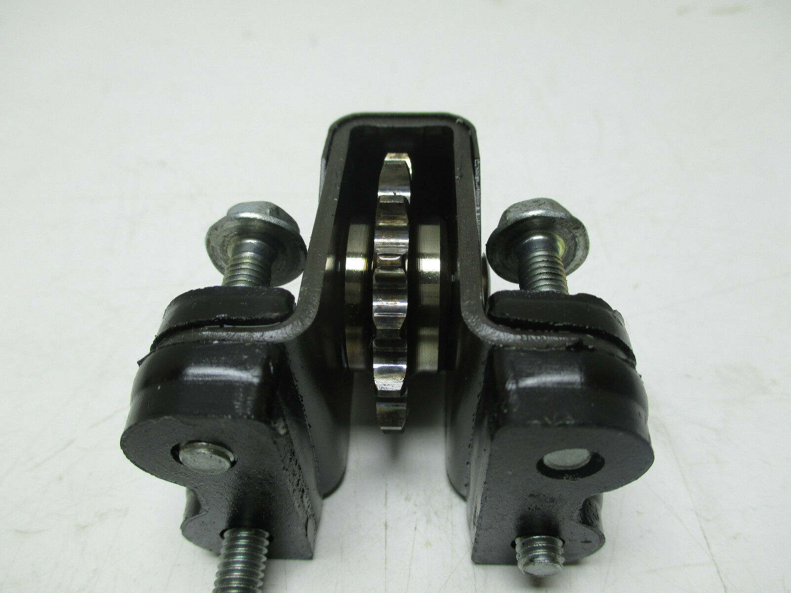

The idler looks alot like this one from a 92 Suzuki. If the teeth are the same ,For $20.00 I might try it.
I can't believe that a oem Kawasaki idler sells for almost $200.00 . 1/2 the price and you can get a aftermarket one that last forever.

Not sure about the yeas , looks like Suzuki used it from the 80s into the 90s.
The one I found is from a 92 katana 750.
It doesn't seem to have the rubber and looks beefier.
If the bolt holes line up and the gear is the same, that would be great.
Would also mean the Kawasaki parts are very overpriced .

It's not just about the tooth pitch and mount holes. The sprocket diameter and or the axle height from the head needs to be the same also.
Too high and the chain will be loose between the cams and alter cam timing and it'll rattle, too low and it will over tension the cam chain and knacker it very quickly. Which would you rather a few dollars more for the correct part or replacing the chain with associated costs and engine out and split grief?
