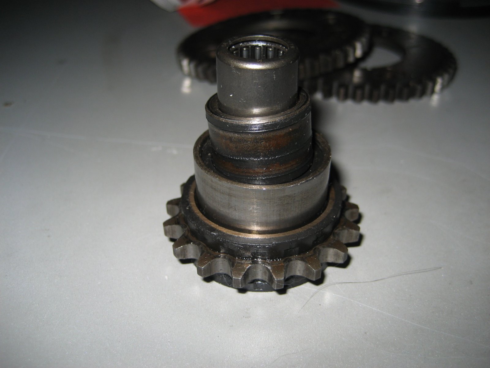

I had a whine in my engine that I thought was the top idler. So I purchased a new one (OEM) and installed it but the whine was still there. After riding season I took the head off and found what you see in the photos below.
I did a deeper dive into the engine and everything was fine. The idler that sits on top of the cases was in good shape. The chain was within the spec but I replaced it anyway because the cases were split.
The front rubber idler was somewhat chewed up from the chain over the last 44 years.
Side view of the front rubber idler shows cracks in the rubber
The rear idler had separated inside and I believe was the cause of the noise.
Closer view of the separated idler.
