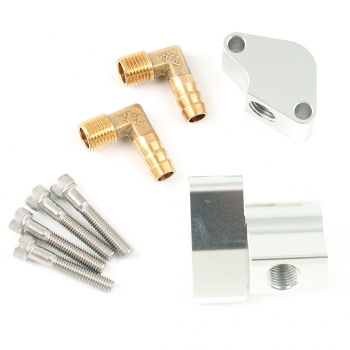

I installed an oil cooler using adapters from Z1 Enterprises on my KZ900. Everything went on smoothly, started bike and took it for a test ride. The oil pressure light started acting weird. Would come on then go out, I turned it off checked the wire all was good. Started bike up and noticed the oil light didn't come on at all. A few seconds down the road it came then back off. I know there is no problem with the oil system, I just overhauled the engine and had verified oil pressure at first start so I just rode it home.
Turned out that the bypass adapters are coated with something and not getting a good ground. Since the switch relies on a good ground to operate it caused the light to act funny.
The coating used is all over the adapter inside and out. I sanded the coating off from inside the housing where the switch disc rests on and the top of a bolt hole. I confirmed it had a good ground, put it all together and now the oil pressure light operates like normal.
So if you're going to use these remember to confirm you have good grounds.

I am also in the process of adding a cooler, I'm using the same adapter on my KZ1000. I knew that anodized surfaces are not very conductive, but didn't think it would be an issue here. thanks for the post.

the tapped holes on the adapter are 1/4" did you drill and tap them bigger for 3/8"? I thought about doing that but it didnt seem like there was enough meat there.

It's 1/4 NPT. It is confusing. You can get 3/8 barbed and I got 1/2" barbed fittings so there wouldn't be any restriction in oil flow.

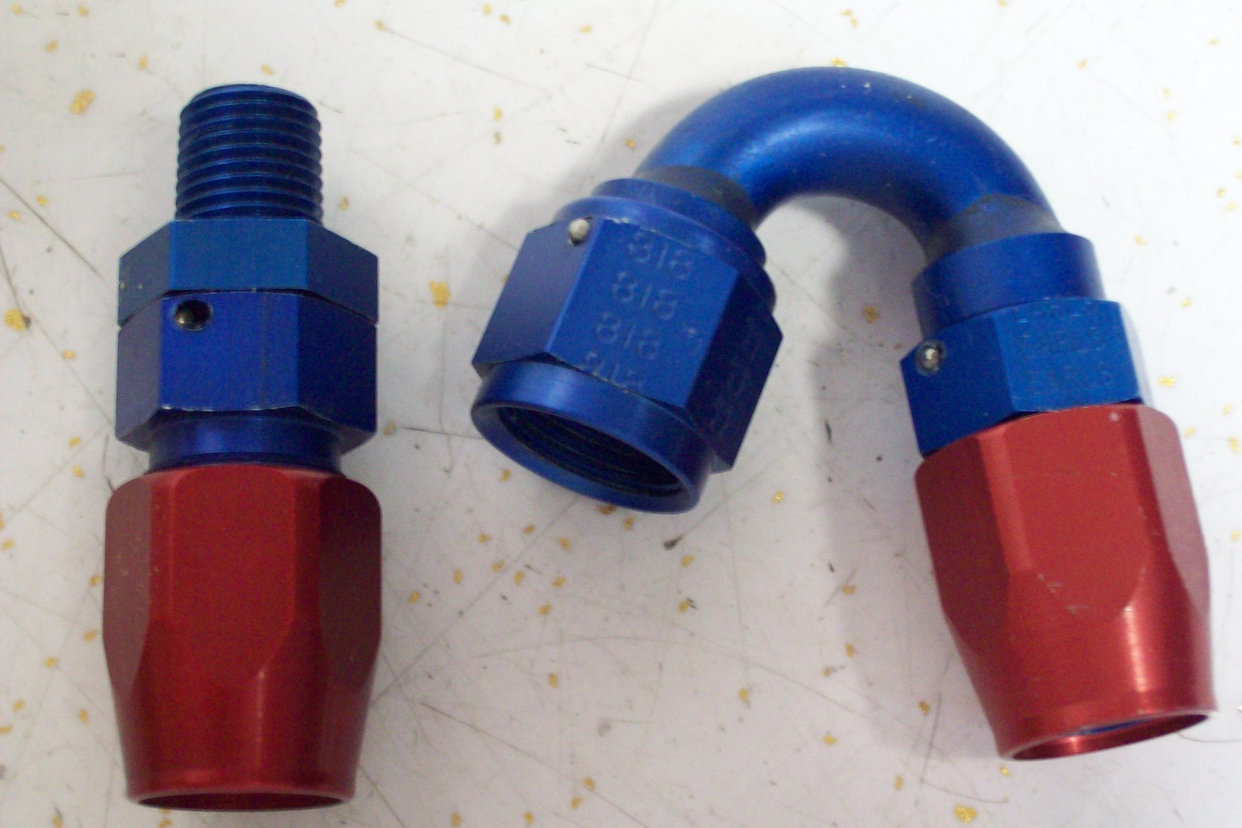

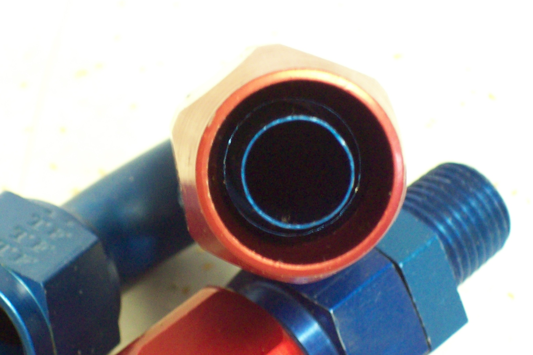

I have always set up my oil coolers on my bikes with Earl's AN-8 braided steel hose and fittings. I just measured the I.D. of the fittings and it is 3/8's.
I believe the cooler adapters I have on my Superbike right now came from Lockhart/Phillips back in the early 80's.
Never had any faith in rubber cooler lines since I watched a street race and the one guy burst a rubber line on the big end. He fell in his own oil, and slid into a telephone pole. He didn't make it.
Earl's Supply AN-8 hole ends.
I.D. photo of Earl's Supply hose end.
