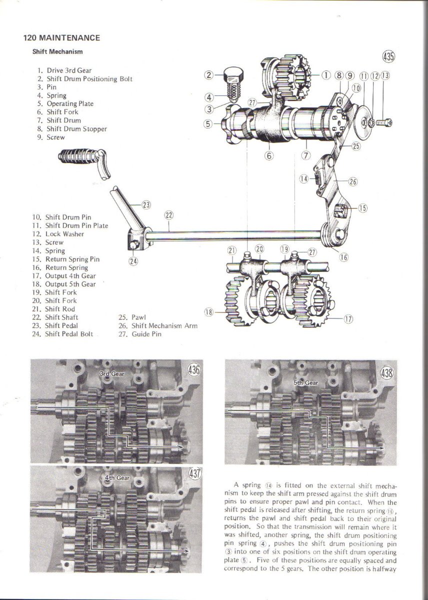

Take a look on the shift drum mechanism parts. Opposite to the big KZ´s the mechanism is located behind the clutch basket (right Hand engine cover).

As mentioned above, it could be a bent or broken part in the shifter mechanism, or a bent or broken shift fork, or the second gear engagement dogs could be badly damaged. There is also a chance that there is a foreign object floating around insid the transmission. A bolt, or a washer, or some such.
Did you try to engage third gear?
If the external parts seem ok, then it may be time to remove the oil pan and peek inside.

I'd check the shift return spring first.

Yes, definitely check the shifter mechanism before diving into the bowels of the thing.

I'll look into the return springs and the whole ratchet assembly this weekend. Thanks a lot for the help guys i'm hoping I don't have to split the cases. Never had a bottom end apart before.
