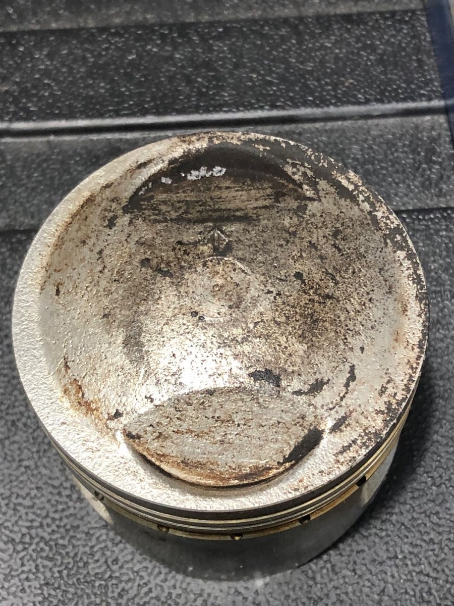

The pistons had quite a bit of carbon build up on the crowns so I cleaned them off as best I could. I work in an aircraft maintenance hangar so I have access to quite a bit of equipment. Is it safe to use a plastic media blaster to clean my piston crowns and combustion chambers?

The pistons had quite a bit of carbon build up on the crowns so I cleaned them off as best I could. I work in an aircraft maintenance hangar so I have access to quite a bit of equipment. Is it safe to use a plastic media blaster to clean my piston crowns and combustion chambers? Yes, just tape off the wrist pin bore and ring grooves. clean everything really well after. I would also rebuild the head after blasting. Before you go to through the effort of cleaning up your pistons I would measure the bore and pistons to see if is in spec.

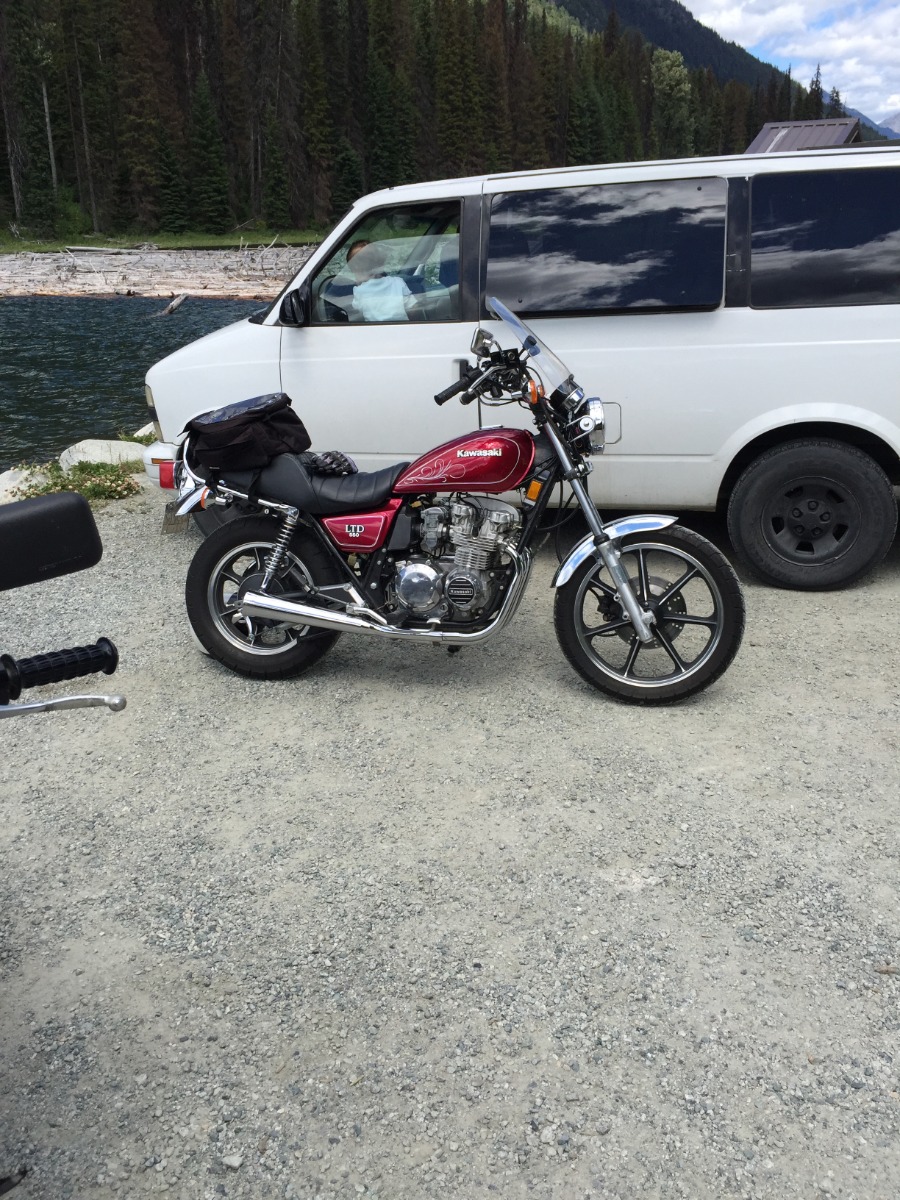

My wife rides a 1981 KZ550. We bought it as a project and fixed it up and painted it. It's a great bike for smaller people. I've ridden it but at 6 ft 3 in I'm a bit too big for it. For a smaller engine it's a fast machine with good acceleration.
The carbs are difficult to remove and re-install...not a lot of room. The engine is easy to work on and can be dismantled on the bike or off. My only beef is that the shims are under the valve tappets, so if you need to change one you have to pull the cam off, and then re-time everything afterwards. You can still get a lot of parts, and there are a lot of used ones on ebay.
Photo shows my wife's bike.

It didn't look like that when we bought it. New tires, chain, sprockets, OEM exhaust and paint. Lots of little stuff including many hours of scraping off 35 years of dirt and grease.
You can't see in the photo but the badges on the tank and sidecovers on my wife's bike are covered with little round mother of pearl sparklies. They reflect light, particularly in the dark. It was her bike and her choice. Makes it more personal as you say.
Good luck with your toy!

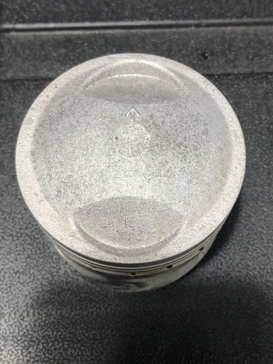

I took my pistons to work today and used the plastic media blaster. I had already scraped and wire brushed the tops and got them mostly clean but the plastic media made them look almost new.

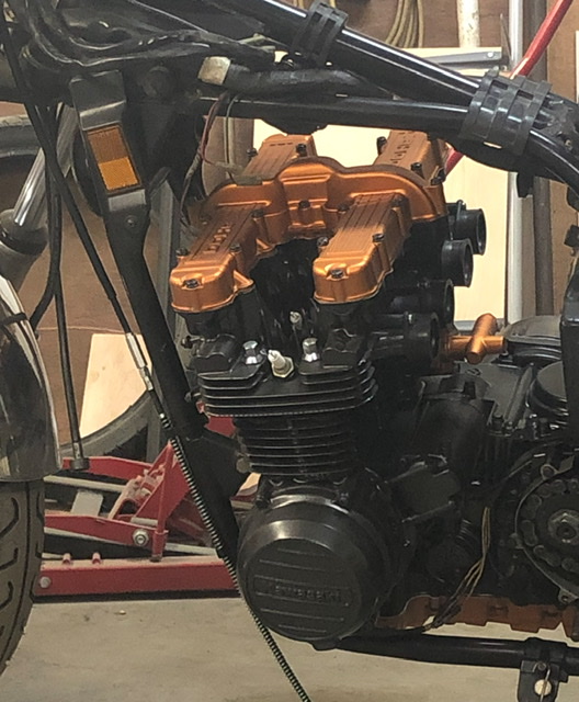

Engine is back in!! I ended up bringing the cylinder jug, head and cam cover to work and used the plastic media blaster to clean them up. I painted the cam cover, oil pan, exhaust clamps and cam chain tensioner with VHT copper engine paint. The block, cylinder jug, head and side covers were painted with VHT black pearl metallic.
