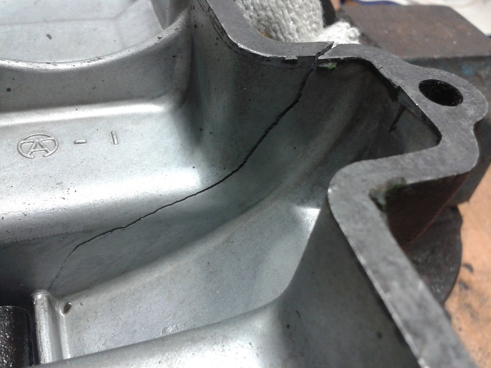

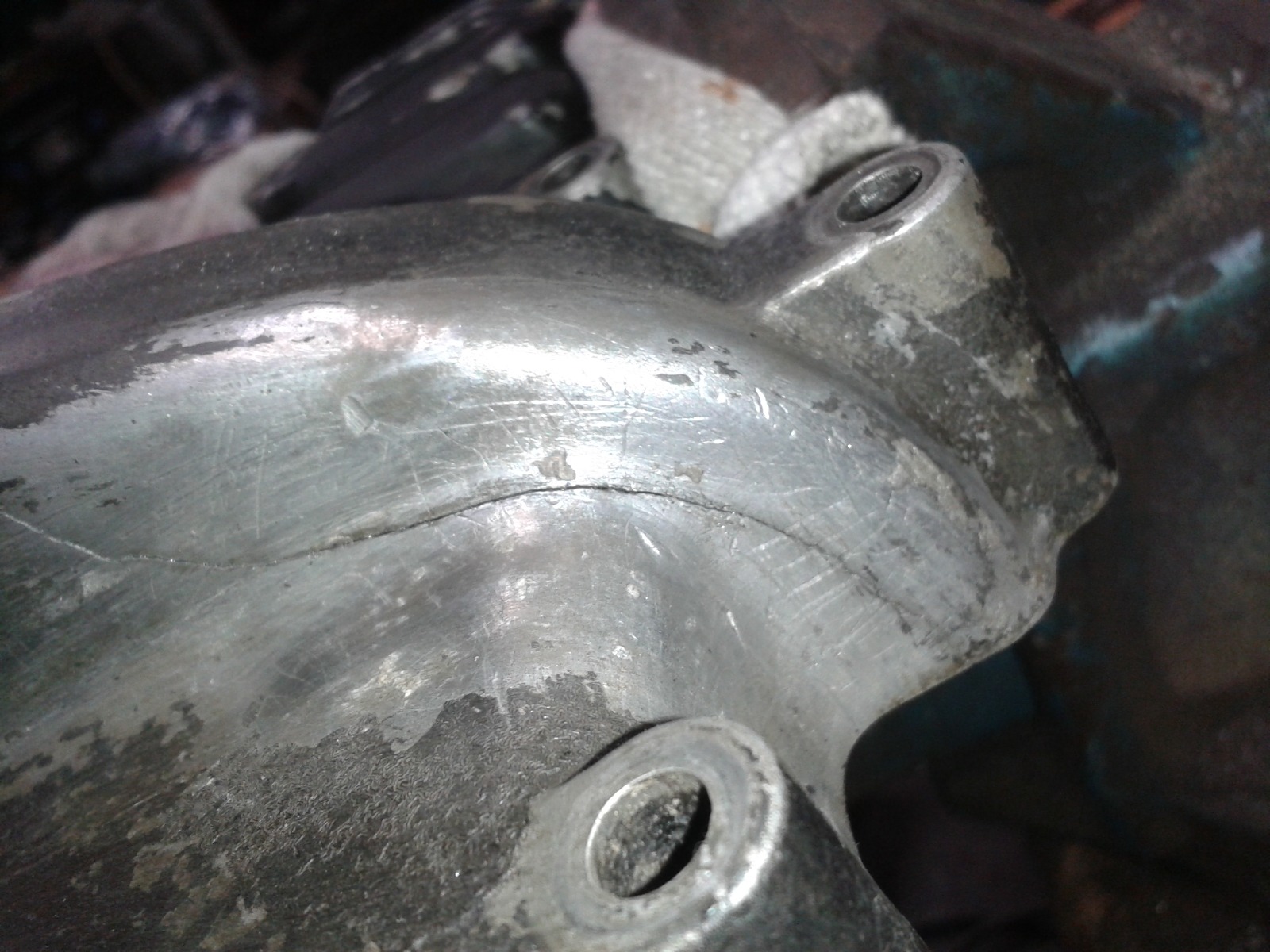

Every time you lift the valve cover you have to reset the cam chain tenioner. If not you over tighten the cam chain!. This can cause a lot the damage to all cam chain drive parts and engine, like broken chain links, fast wear of all chain guids and cam bearings, cracked valve cover. To have some slack between the sprockets after removing the valve cover is normal due to the shape of the chain guide in the valve cover.

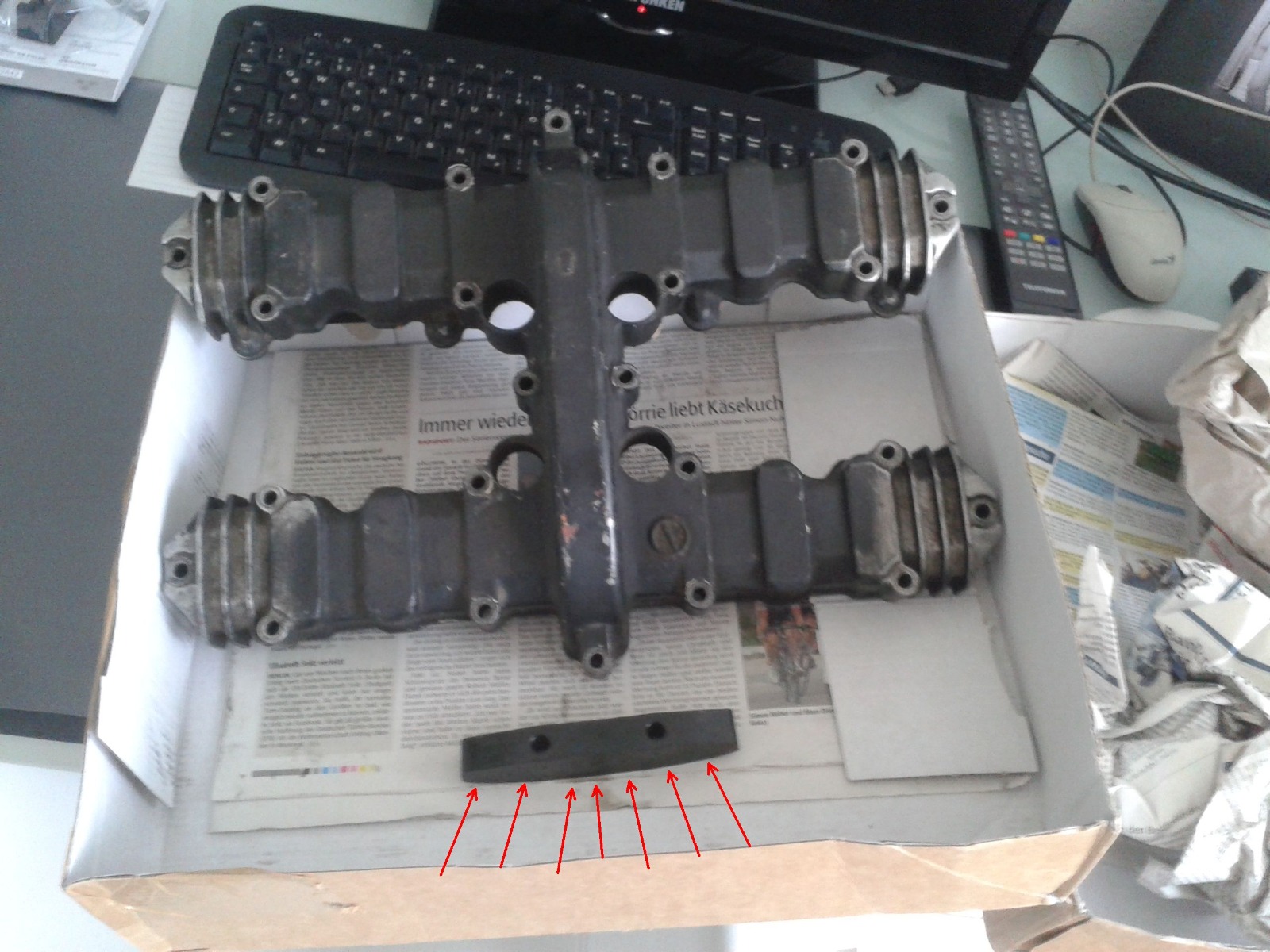

12 Feb 2023 13:44 - 12 Feb 2023 13:59Then your cam chain guide in the valve cover is worn out!!!Thanks. I know all this, but I was wondering what Ken19 was describing in his last post. It seems like he was saying the APE tensioner had not pulled up all the valve cover slack in the same way the stock spring-loaded tensioner would and that he manually took up a last bit of slack (not all the slack) with the valve cover off.
To me, this seems like it might make sense. My KZ1000P seems to have the exact same noise issues as his did, and I also have the APE tensioner on it.
From what I have observed, my cam chain is not coming into contact with the valve cover guide, even with the chain tightened per APE's instructions, so it might make sense that there is still a little slack in the chain, which would be responsible for the noise. The chain would be sort of rattling against the guide, rather than running smoothly along it.
So, if I am reading Ken19's post correctly, it might make sense to tension the chain just a little bit more with the valve cover off. Obviously, if you go to put the cover back on after doing this, and you encounter any resistance (i.e. the cover coming into contact with a too-tight chain), you would not bolt the cover down, and you would back the chain tension off.
Does this make sense to you all?
Also, I tried messaging Ken19, but the KZrider message system doesn't seem to work. I keep getting an error message. I also get it when I go to check my messages. Anyone else having this issue?
If not you can try to push down the chain between the sprokets to get the right slack (Do not turn or move the crank/cam or your slack is catch up by the tensioner.
Under some circumstance the valve spring tention to the cam lobe can turn the cams by some degrees and your slack is also gone!
Why did you thing Kawasaki construct and made the bow shaped guide!!!
Yes right, to guide and shape lock the chain tention between the cam sprocket, so the chain can´t swing/ vibrate up and down and make a rattling noise!!!

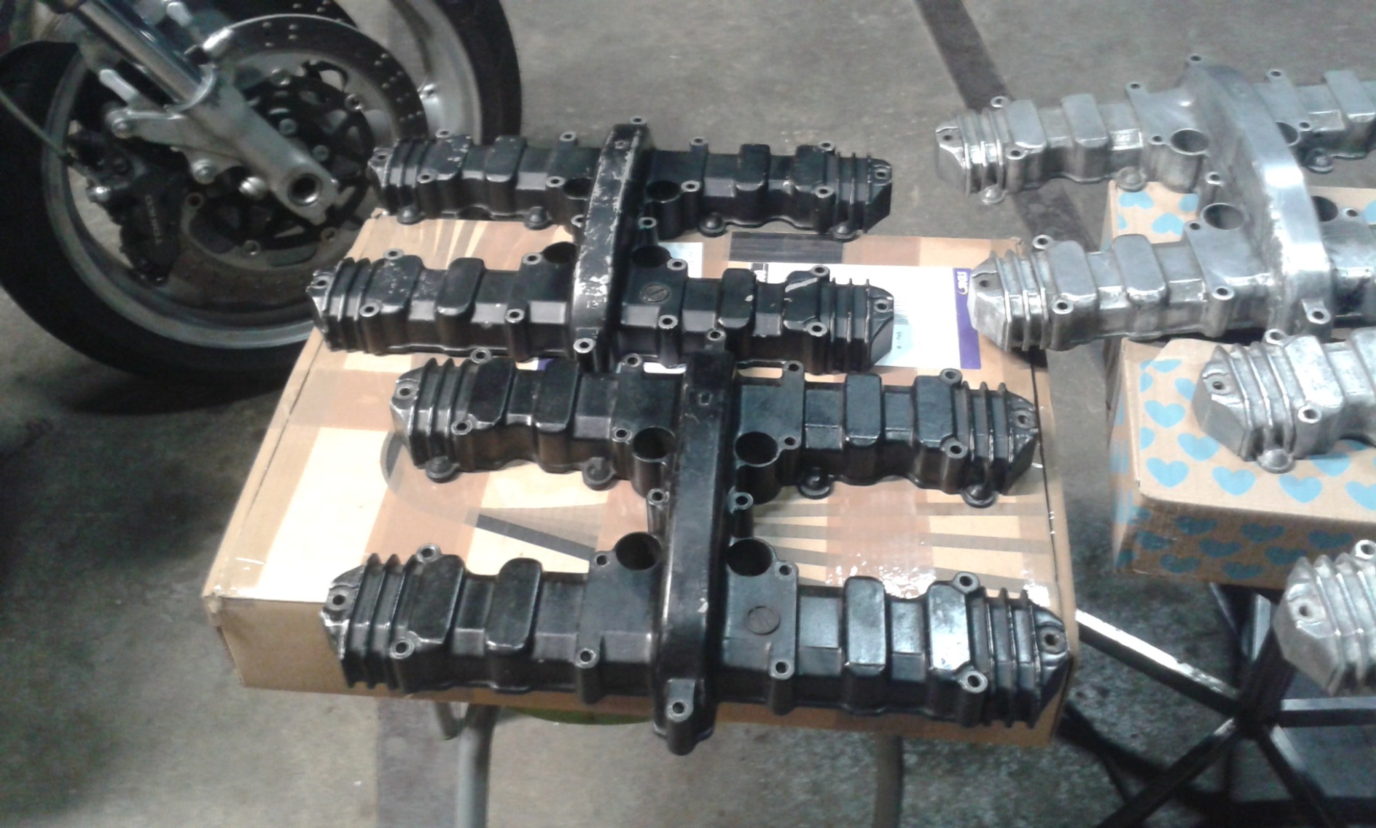

Hey, what's up with all those non-US engine covers in your picture??? I know, you're just a cam cover hoarder.

12 Feb 2023 22:37 - 12 Feb 2023 22:46All of them sold to US KZR members. They are now very difficult to find here in Germany for a reasonably priced used spare part.
