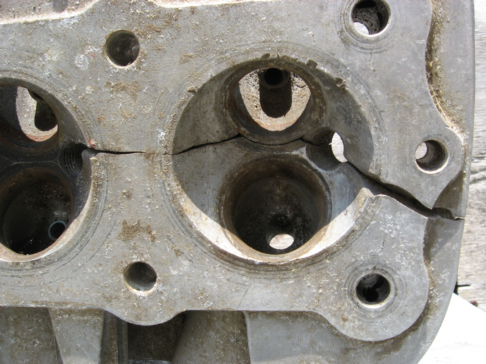

My friends and I ran in Top Fuel / Funny Bike / and more street races than can be counted and used stock cases. Most failures were in melted pistons and over pressure
cracks in the head
To Much Boost and Nitrous Oxide

Thank-You zed1015. Years ago I did a 1428APE big block normally aspirated for my personal 74 Z. Had the J head, bigger SS valves, Norris 501's, 13.5CR, ported, etc. I finished the engine but never put it in the frame or even started it. I got to thinking, after I came to my senses, i'll be putting a crazy fast engine in a stock Z. Sold it to a friend I grew-up with, it's still not finished. I do a lot of the 1075/1105's and can attest to their success. Streetfighter, How does a Head come to look like that!?

TOO Much boot and Nitrous, just saw the text below the photo.
