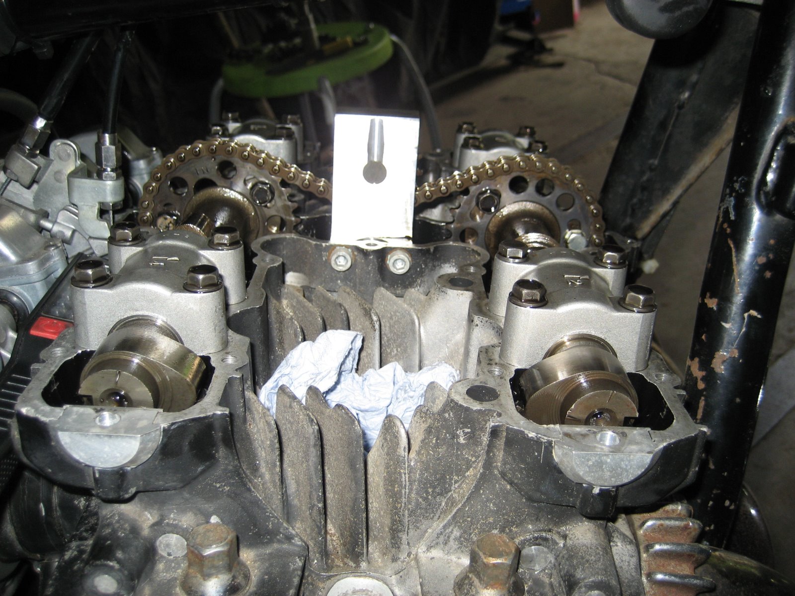

zed1015 is right about the compression drop!!! I am in the same situation of a 8,25 to 1 compression scenario with my 903 ccm cyl. /Piston bottom end. IMO i am wasting 20 HP at the moment with this Setup but a 1100UT engine swap is next on my to do list.
So if you swap to your J head you need a CCIA to use your APE K410 cams.
I am runing GPZ110UT cams in my J head now with APE sprockets for the Z1 cam chain.

So with all that in mind, do I use the earlier cam chain and guides ?
Yes, that´s the reason you need the CCIA (roller chain) on HYVO chain J/GPZ Modell heads.
