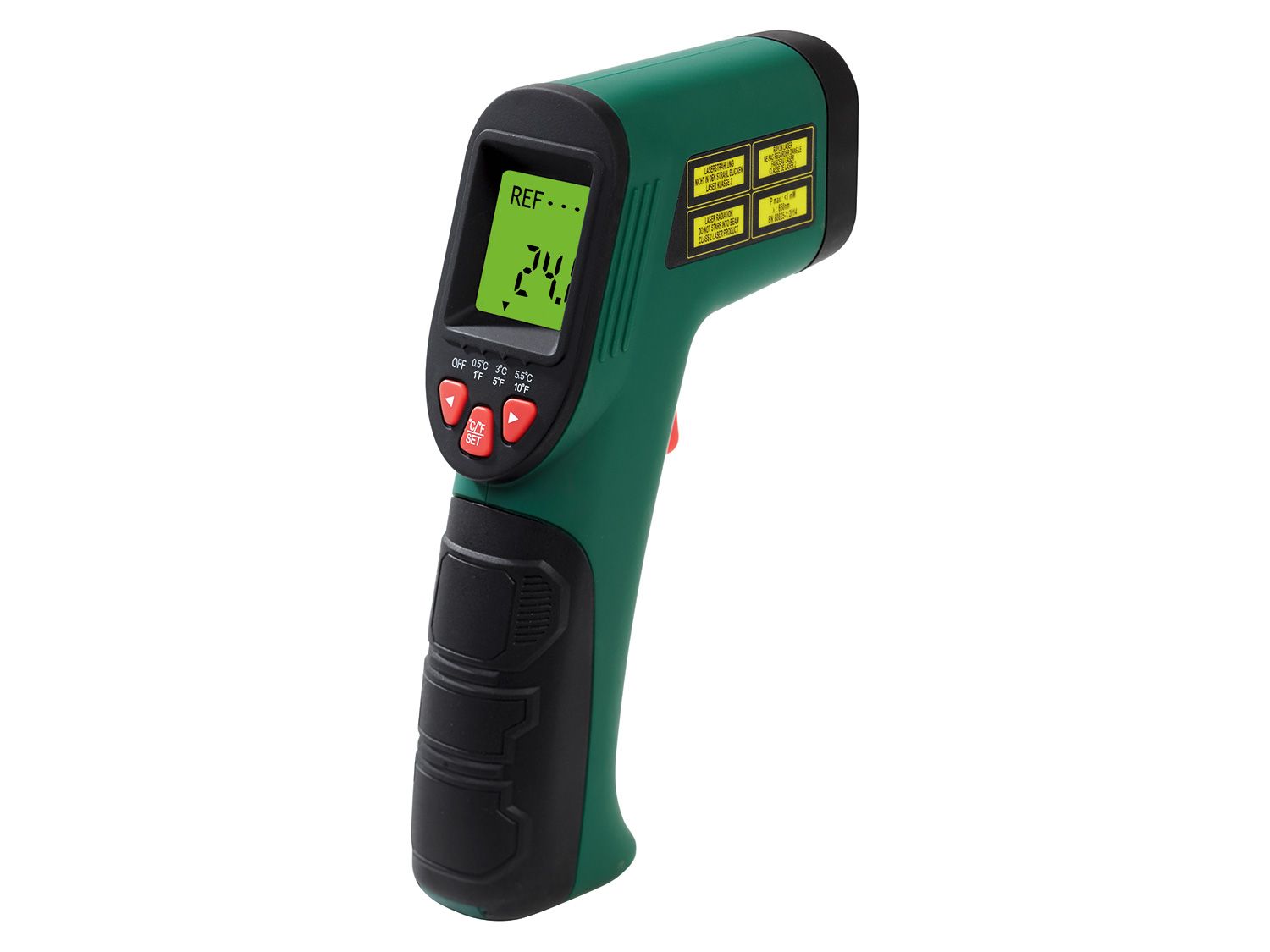

Re: Engine Getting HOT!!! 78 KZ650
02 Sep 2019 13:14
02 Sep 2019 13:31
You can use a oven thermometer to verify how hot it's getting. Do you hear crackling coming from the engine? Pics of the plugs?
