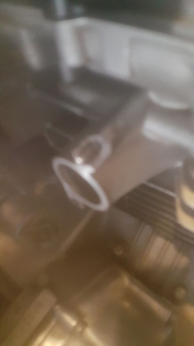

Adjusted floats. They were a little off. Did a plug check and all plugs look good except for number 4
. I'm assuming it's an air leak on the intake (new intake).
When trying to tighten I did this

It had been heli coiled and when i loosened it it just broke off.
Do y'all think I can tig this up on the bike and retap?

Re: Engine Getting HOT!!! 78 KZ650
05 Sep 2019 18:41
That would be difficult to do without taking the head off. I wouldn't even try it myself. The bolt needs to be square and the mating surface flat to seal. You may have found your problem.
06 Sep 2019 09:02 - 06 Sep 2019 09:04
With an air leak that bad I'm surprised it idled at all. It should have had all sorts of running issues.
06 Sep 2019 12:30
That broken carb boss would TIG weld fine, after being ground to clean it up. Bit of a tricky job to redrill and tap in place but could be done if you were careful. Could use an old carb spacer for a drill spacing guide for the tapping drill. Partially warm the area up with a propane torch before welding to make the humidity moisture boil off so it does not contaminate the weld at the start.
06 Sep 2019 12:38
Thank you DGA, appreciate the advice. Hopefully the Harley shop I volunteer at wont mind me trying to tig this up.
Surprisingly the bike ran amazingly strong, did seem to have a slight hanging idle at DE-acceleration.
07 Sep 2019 22:20
Fixed... Can ibreuse head gasket? I assume no?
08 Sep 2019 10:33
Once the engine has been heat cycled then no get a new one.. I've reused headgaskets on engines that were never started but assembled then had to remove the head.
